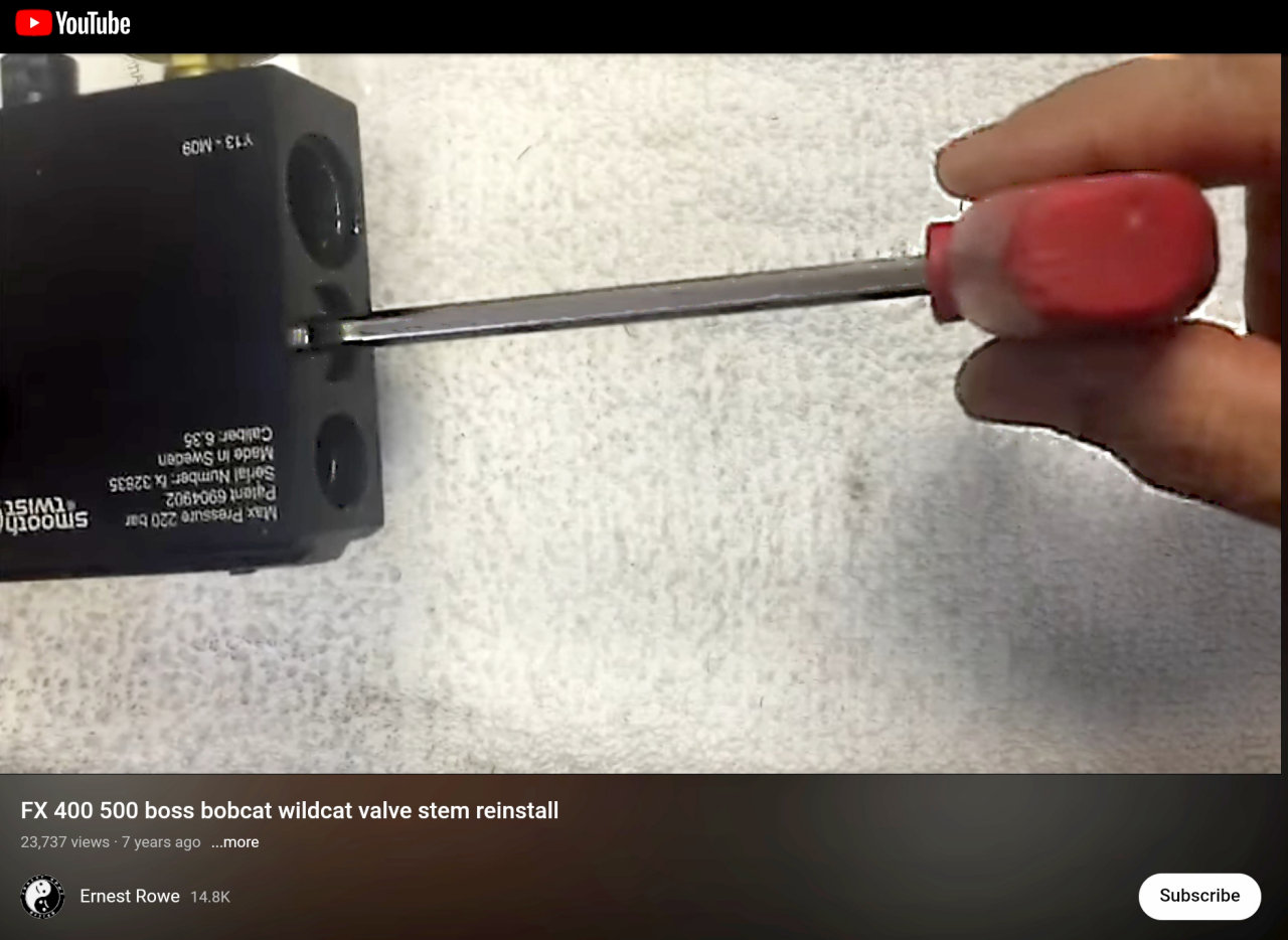

Here's an appropriate video from Ernest Rowe for the FX Royale action. It's a reassembly video so you will have to infer the disassembly sequence. At 2:25 he talks about what I was warning about - do not drive fire it with less than 100 bars of air pressure or you start damaging the valve pin!
Here's a screenshot showing Ernest using a hex wrench to install the valve assembly. So part D24 has a built-in hex socket for removal.
