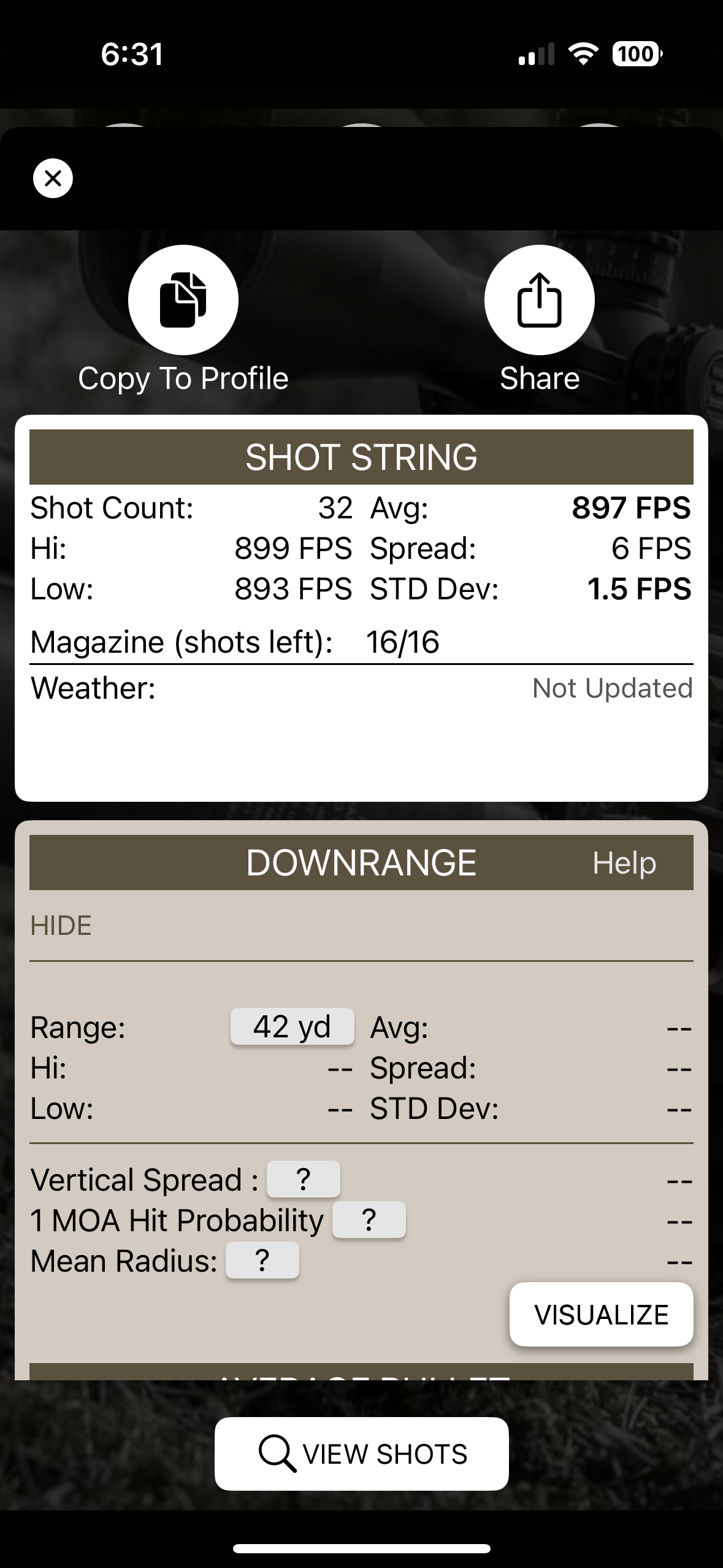

Pic is a factory wildcat string over two mags (chrony missed a few shots), started after the gun sat for a couple of days. Factory reg is perfect on mine. Did you have any issues before you put the huma in?
Reactions: MongooseV8
