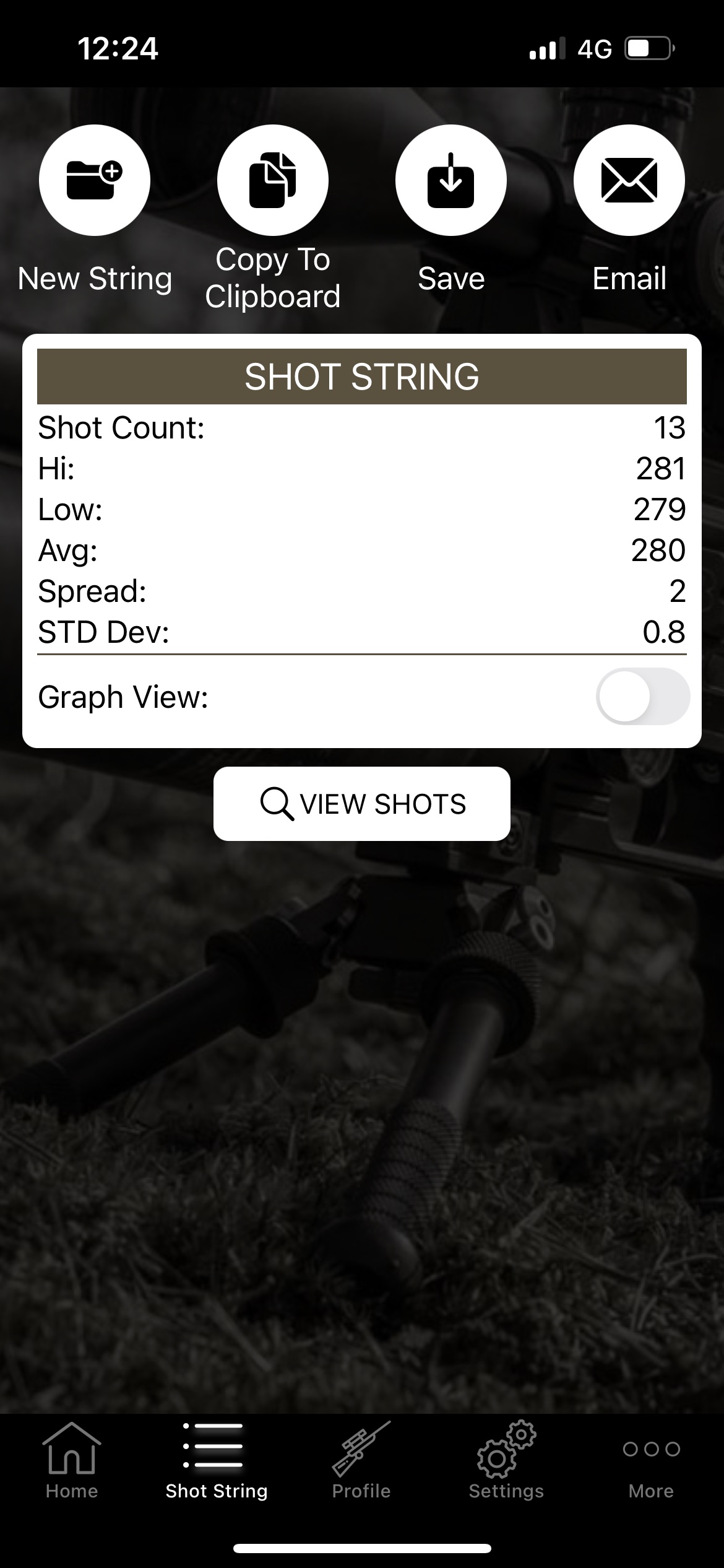

Best 5 shots group with Zan 35 grain slug 280 m/s (look at awesome 13 shots string🔥)

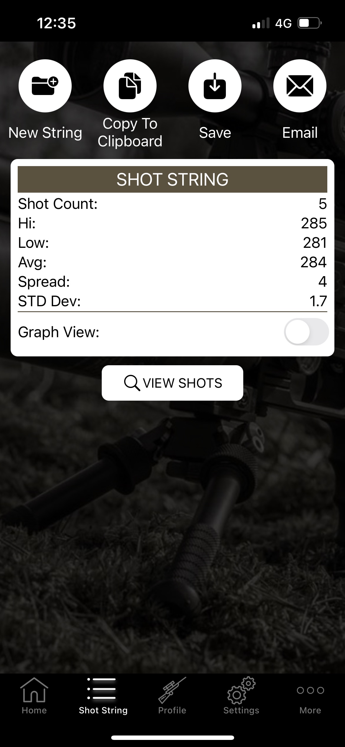

Worst 5 shots group wit Zan 33 grain slug 284 m/s.
Rifle spec: Wildcat .25 Bt Compact 500 mm Heavy Slug liner stiffened wit CARBON fiber barrel sleeve .First reg 190 bar, second 160 bar.

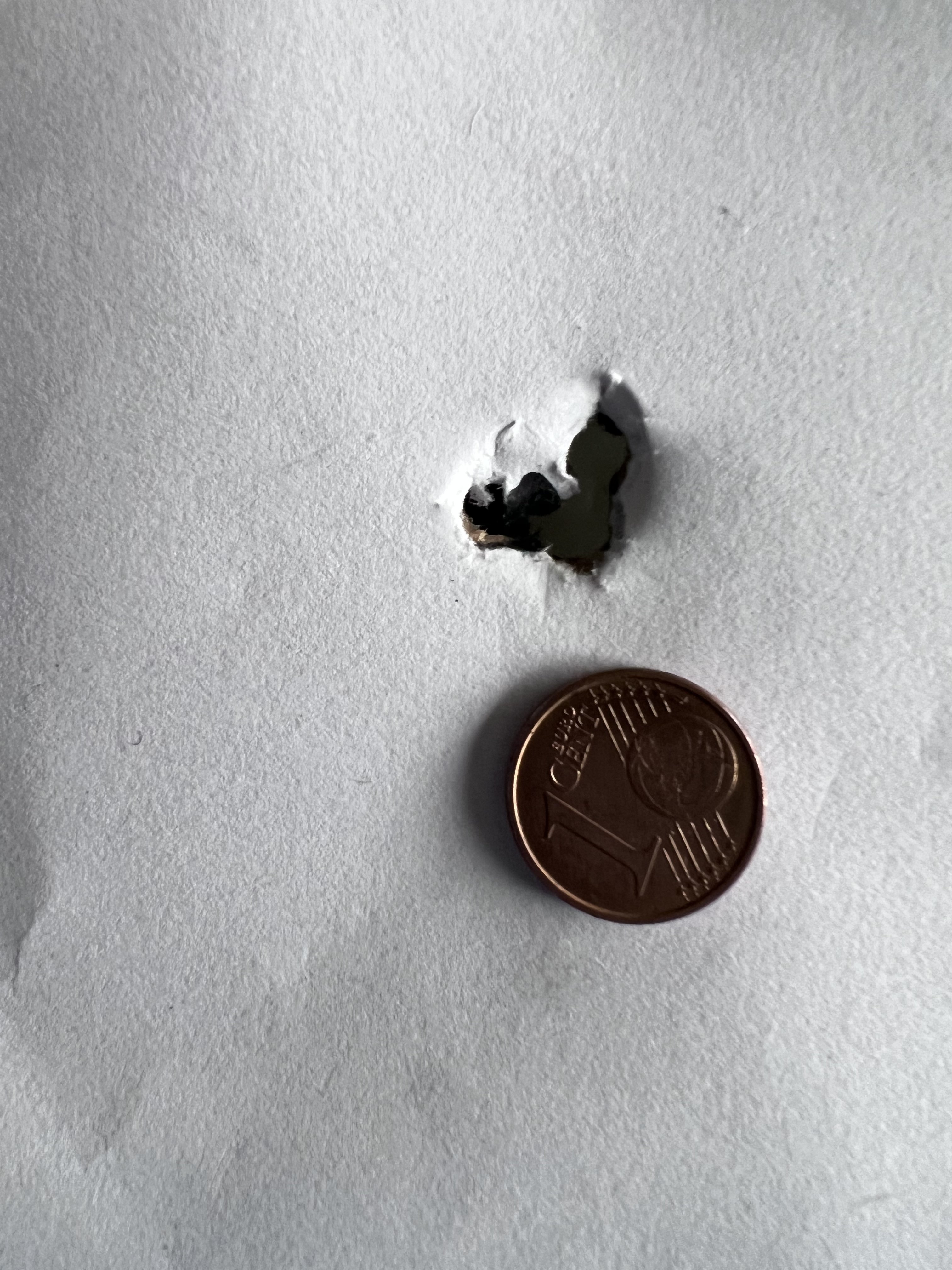

I suppose I should push em faster, like 300/310 m/s. But I did not also try to slow them down like 260/270 m/s.The short barrel is not helping me, need to try with the 700 m and also the 300 cc bottle filled with 250 bar gives me not more than 25 shots x fill. I have to say the slug expansion is great 😊
