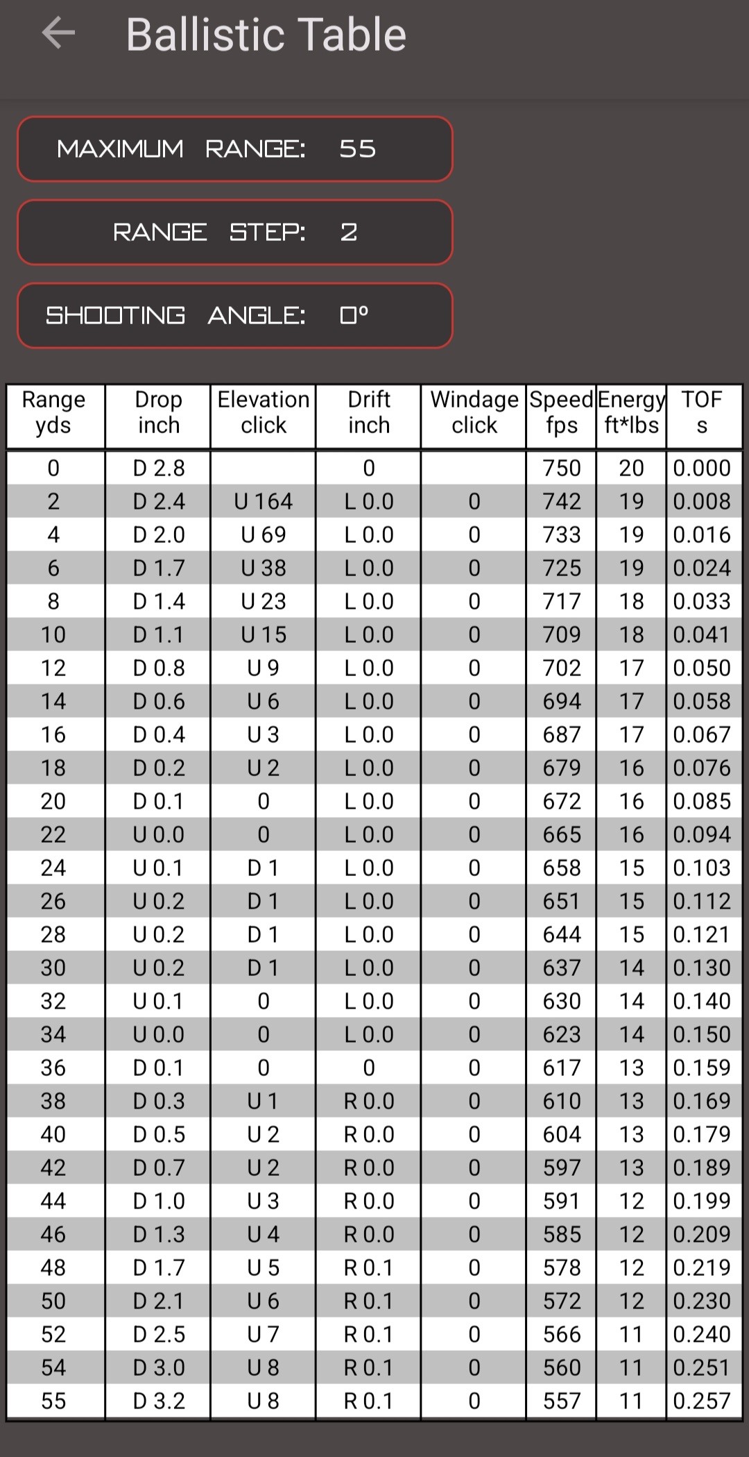

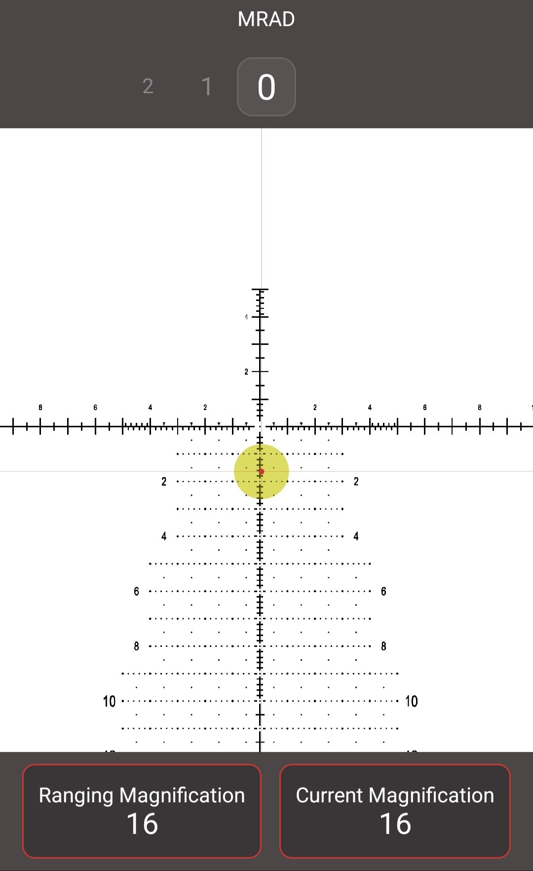

FWIW & YMMV heres my ballistics for my FX Wildcat 22 that I setup for HFT. Its shot with JSB Hades 15.89gr.
I have confirmed these numbers on paper so gonna give it a shot in HFT this spring. Depending how it plays out I may change my zero point. The most difficult target will be the 55yd one which equates to a 1.6mil holdover. I think its workable, if any experienced HFT shooters have any feedback I would love to hear it.
