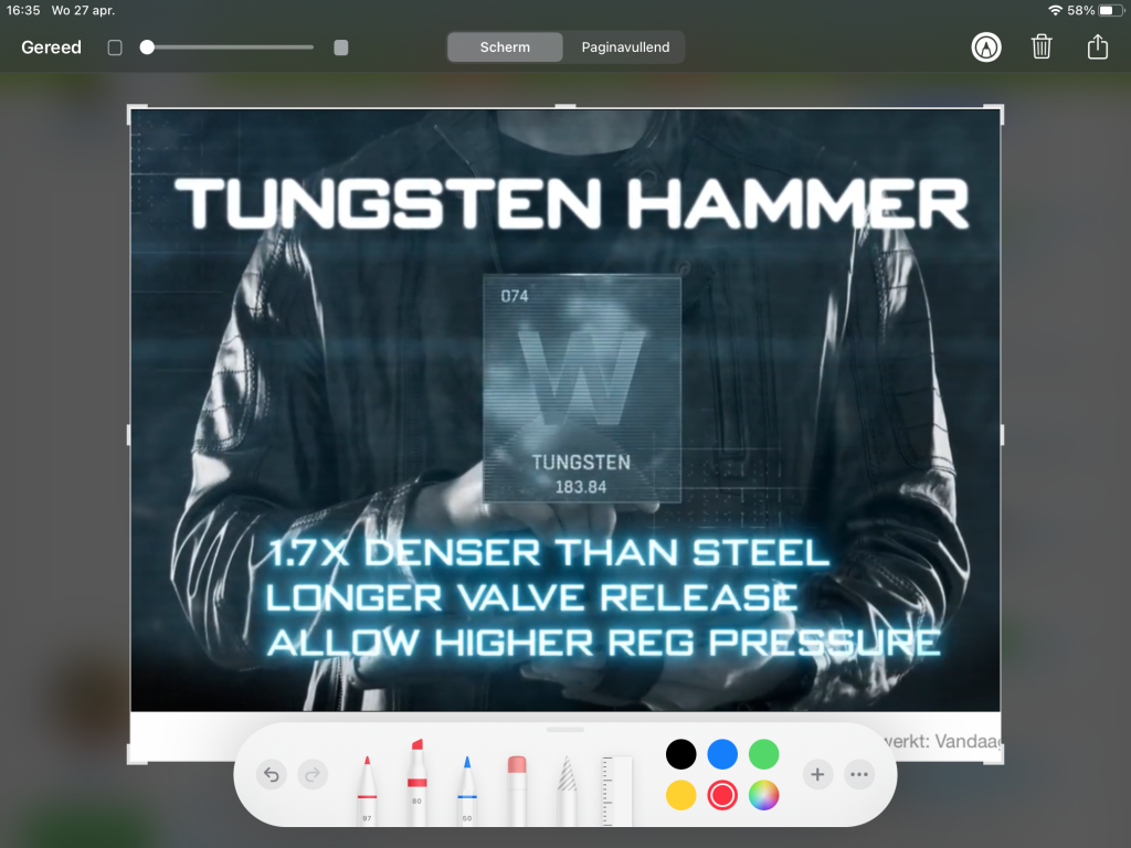

I believe FX already understood the need for changing hammer material as in the newest Impact there will be a Tungsten hammer according to the latest marketing movie
