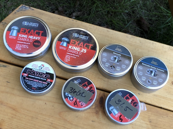

Today I had the house to myself, so I got out the gun and set out to map the BC's of the several common pellets he'll shoot, as well as trying to capture the BC's on two Ratsniper slugs. The pellets tested are shown in the top row below, and include the following: the JSB Lite (25.4 grain), JSB Heavy, Mk II (33.95 grain), H&N Baracudas (31.02 grain), H&N Baracuda Hunter Extremes (28.40 grain) pellets, and the Ratsniper slug (36.0 grain). All were shot through the stock barrel liner that comes with the FX WC, Mk .25 cal (perhaps one of you can fill me in on which variant that is?). All pellets were not measured and were taken straight out of the tin without sorting for weight. No sorting for head sizes was complete either-so accuracy and variability are what you will typically experience shooting straight out of the tin.

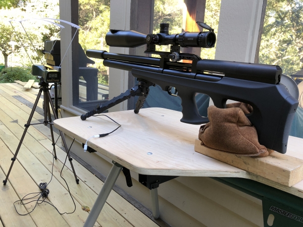

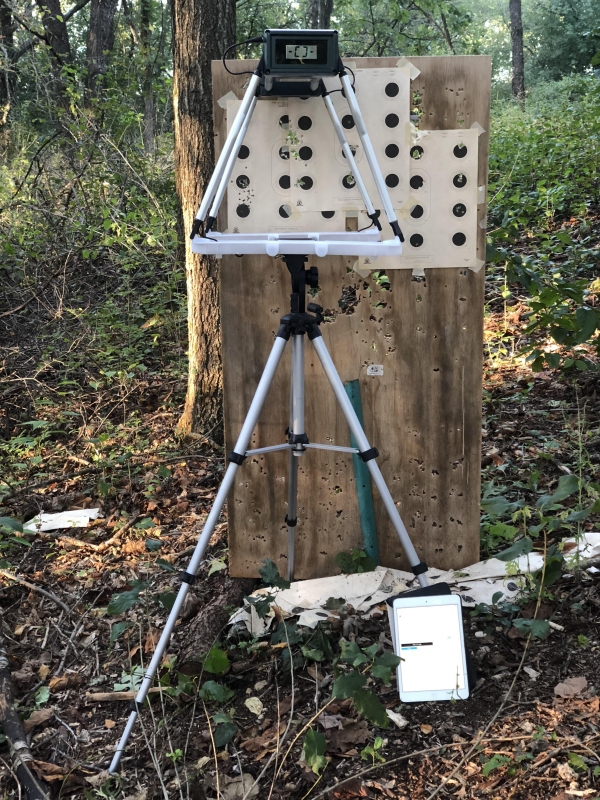

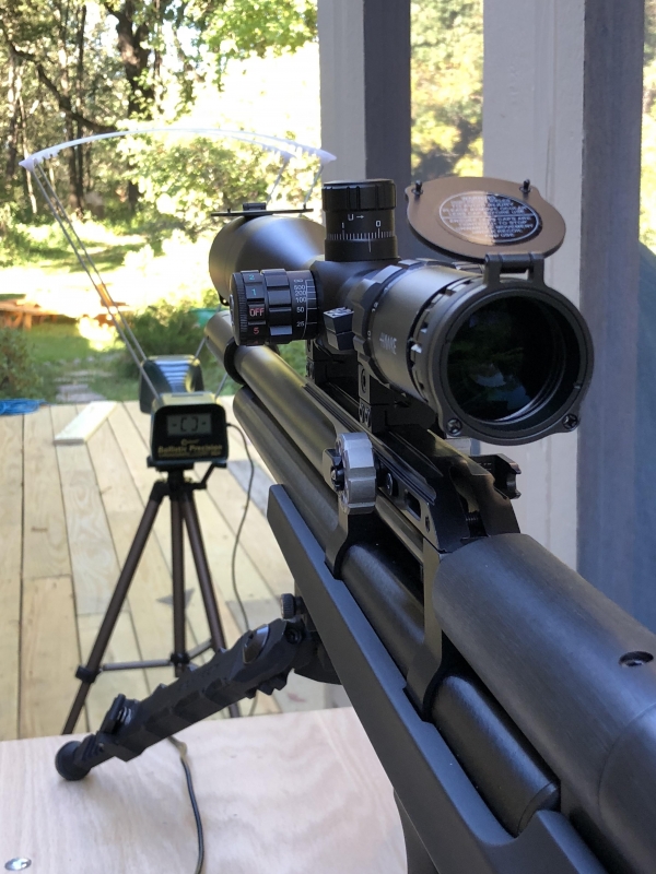

Muzzle velocity, near was taken with the rear window of the chrony at 1 yard (3') from the tip of the moderator. Distance to far measurement, was taken with the rear window of the chrony at 50 yard from the tip of the moderator Delta (distance) between locations: 49 yards (measured with a Nikon laser rangefinder with angle compensation). The closest Chronograph is a Caldwell Ballistic Precision Premium Kit (includes the lights and tripod) that includes a cord to plug directly into the headphone port of a smartphone and record the data automatically. The newer chronograph (just arrived yesterday so I can do this testing for ya'll) is a Caldwell G2 Ballistic Precision which has a bluetooth connection to any smartphone for automatic recording of data (sweet!).

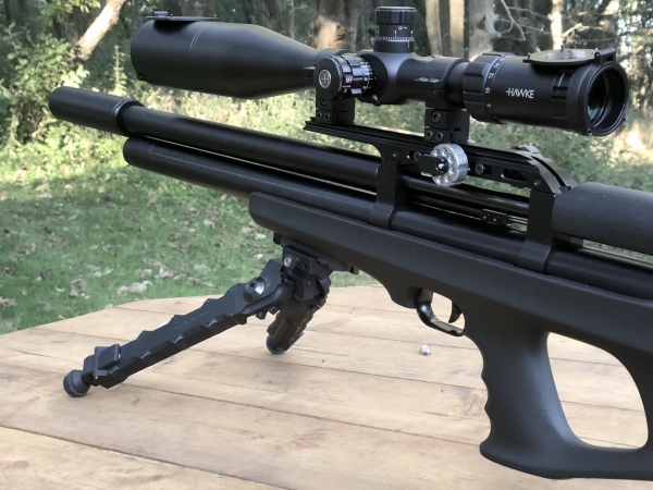

Here's a photo of the near Chrony setup:
Setup​ @ 1 yard:

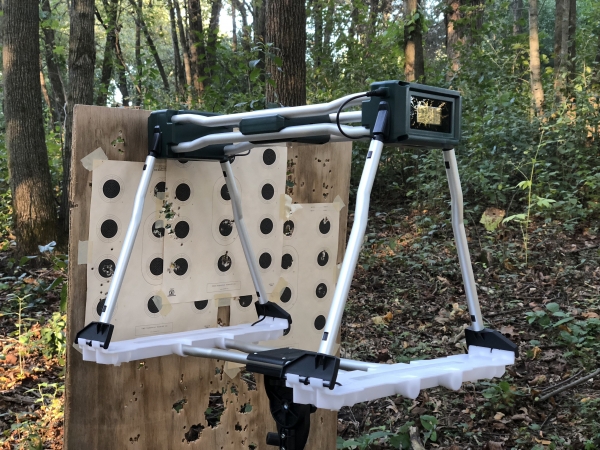

Setup at the target (@ 50 yards, a 49 yard delta): Caldwell G2 Chronograph with Bluetooth link to iPad for data recording

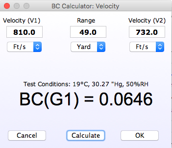

I opened up Chairgun (Mac version) and adjusted the environmental conditions, altitude, etc. I then went to the BC calculator app, plugged in the data, and calculated the following results (below).

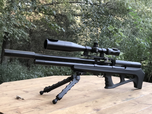

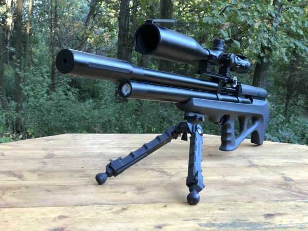

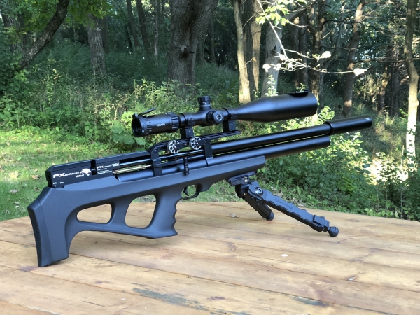

Tested gun: FX Wildcat Mk II in .25 caliber with Huma reg installed, HS tension adjusted, stock barrel liner. DonnyFL Sumo Installed. Tuned to shoot Mk II heavies around 840 fps.

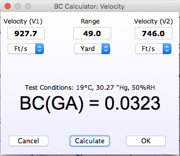

First up: JSB lites (25.39 grn):
1537664471_18916978365ba6e5d761cf26.19277860_FX WC .25 Cal JSB Lite BC-092218.jpg
Shot group:
(Picture may be added later)

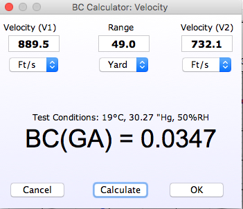

Next up: JSB Heavy, Mk II (33.95 grn):
1537664488_15274330905ba6e5e80b9fc5.29344215_FX WC .25 Cal JSB Hvy Mk II BC-092218.jpg
Shot group:

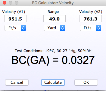

Next: H&N Baracuda's (31.02 grn):
1537664535_1417358525ba6e617829c35.15020581_FX WC .25 Cal H&N Baracuda BC-092218.jpg
Shot group:
Next: H&N Baracuda Hunter Extremes (28.40 grn):
1537664569_7649716695ba6e63997a2b0.98640110_FX WC .25 Cal H&N Baracuda Hunter Extreme BC-092218.jpg
Shot group:
Lastly, I did manage to get one, single shot to register across both chronies for the 36 grain slugs...
Last: Ratsniper Slug (36 grn): (yep, that's NOT a typo-they have crazy high BC's! Same slug in my RAW HM1000x with polygon barrel comes in at 0.0888!).

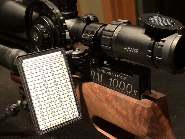

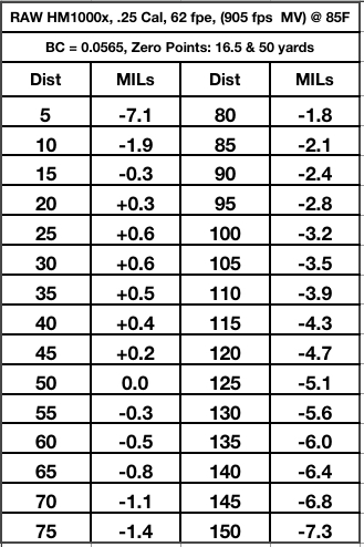

So what do you do with the BC numbers now that they're shown for the combo above? Good question. What I do is feed that info into the Chairgun Pro App and create a ballistics card (range card) that goes on my gun for reference while out shooting. I shoot a MIL-MIL combo so all I have to do is rangefind, dial in the correct compensation, and shoot straight on. Here's a sample card, and what it looks like on my gun:
1537665192_16650468735ba6e8a8124324.93206562_RAW HM1000x JSB Mk I Range Card.jpg

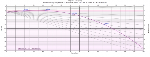

Which is really just a handy reference for the plot shown below:
1537665672_21091034615ba6ea88e55e12.23713239_Ballistics Plot-RAW HM1000x.jpg

Certainly-I would be glad to make you up a card (or several). Would you like me to post it as an image? How far out in range do you want to go? What is your sight height above the barrel (centerline to centerline)? What temp do you want me to set it up for? Those are a few details that get plugged into the Chairgun Pro app to make the cards. If you want to download the app and play around with it, I can coach you a little about how to make up the cards? Just let me know...

Regarding the click adjustments: actually with this scope, they're not needed because the scope is a MIL-MIL scope (MIL dot reticle, MIL turrets). The turret clicks are marked off in full, '1 MIL' increments with every 0.1 MIL marked as a smaller hash mark on the turret. Thus I simply sight the gun in at 50 yards, reset the turret to be at '0 MIL' where it's sighted in, and then read off the card to dial in the compensation. Thus at 75 yards, if it calls for '-1.4 MIL' compensation, I know the pellet will be low by 1.4 MIL at that distance so I simply turn the turret (in the up direction) to 4 hash marks past the '1 MIL' mark and I'm dialed right in. When done, I set it back to '0 MIL' as my 'home location' (so to speak). It's really super easy and there are no click counts needed (nor distance markings on the turret, etc.). From now on, I won't buy any scope unless it's 'MIL - MIL' (or 'MOA - MOA', but I prefer MIL-MIL). Here's the scope I have on my son's and my guns.
