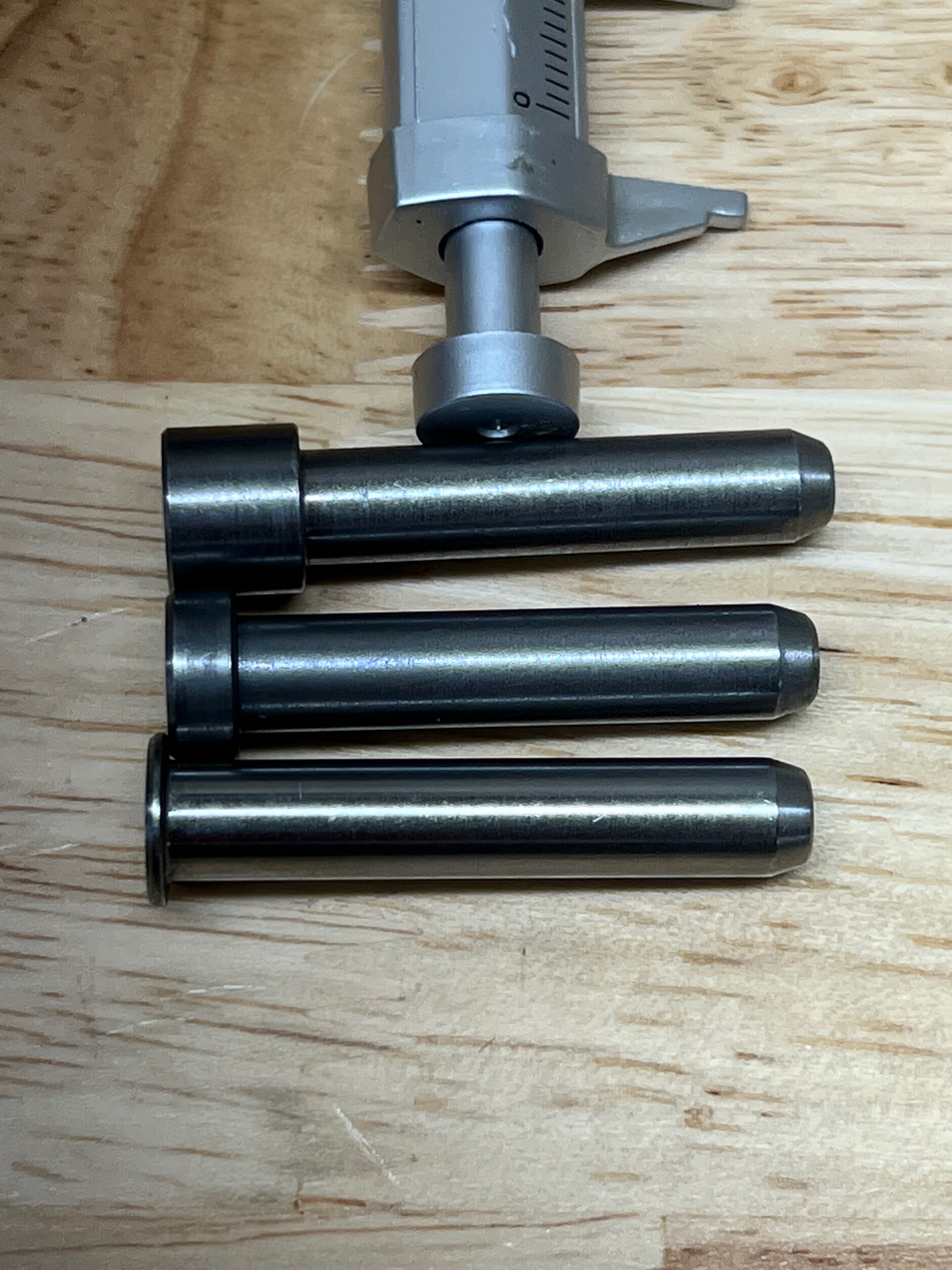

Here you go:
The bottom one is the .177/22cal hammer weight
Middel is the .25cal
Top is the 30cal that comes with the slug power kit.

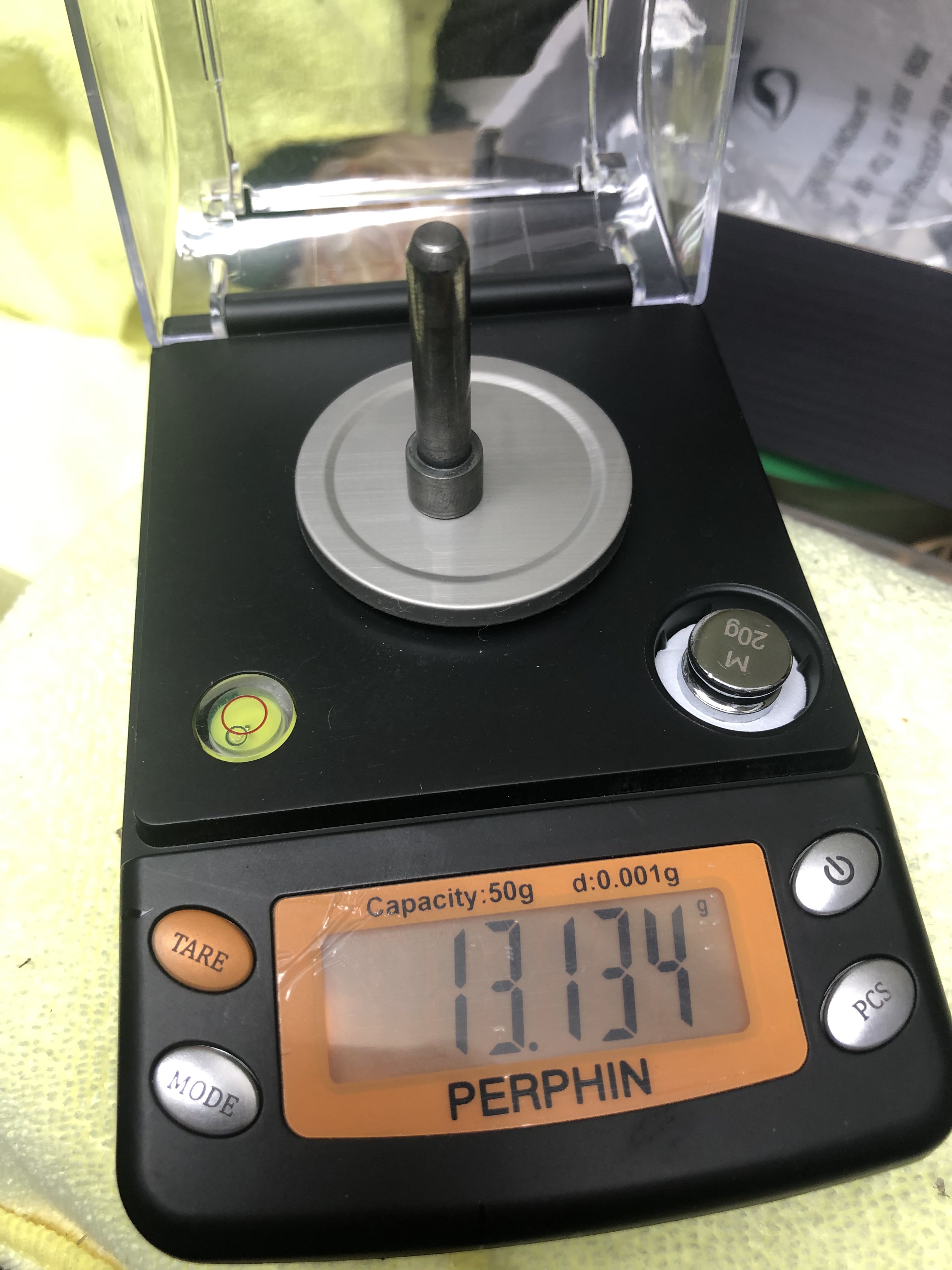

That top weight weighs this much-

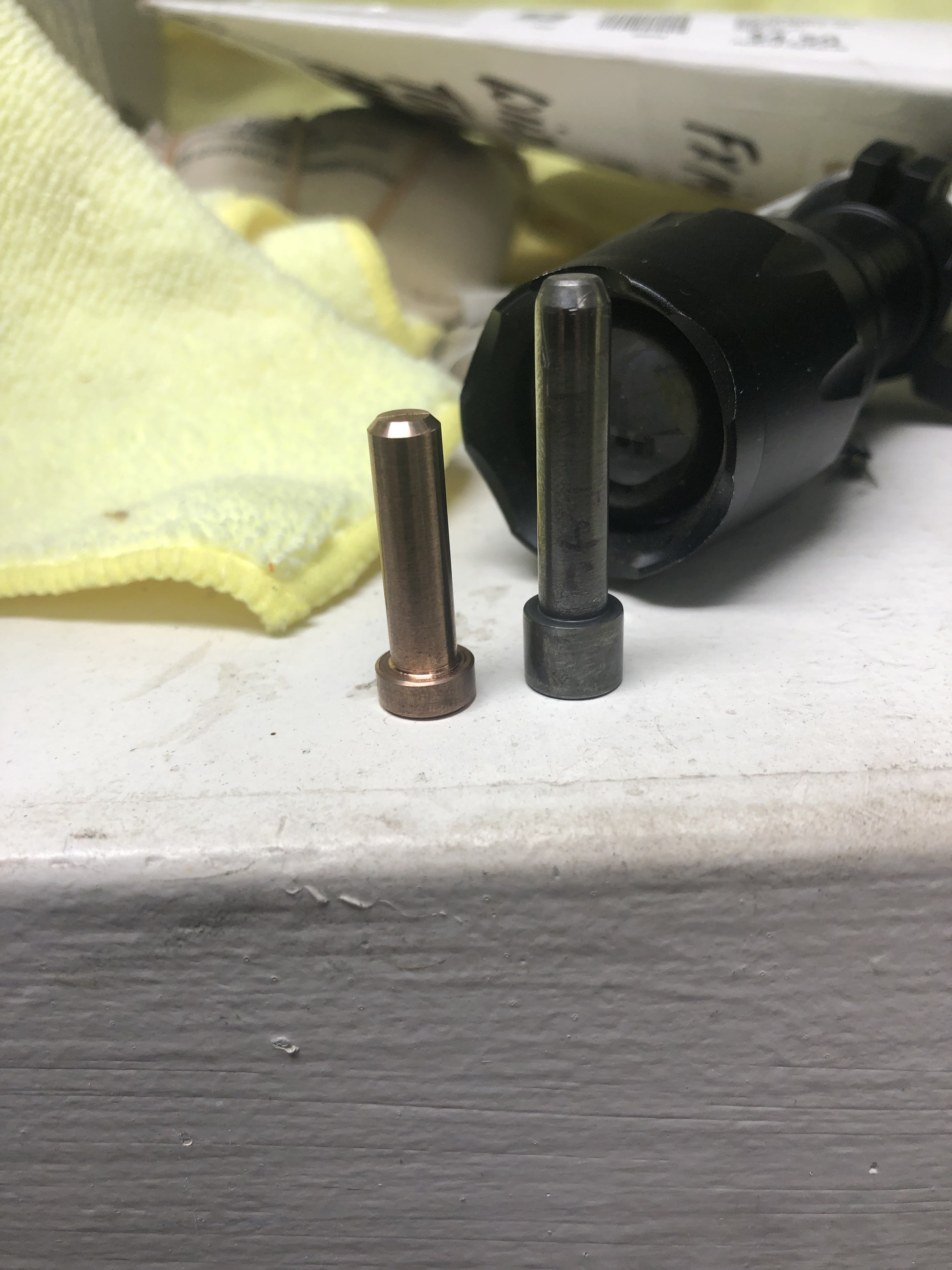

Had it in my wildcat mk2 30 shooting the 44.75’s at around 935 FPS. I swapped it in for a 16G tungsten on the left-
and now I’m at a steady 955 without touching any hammer adjustments or reg pressure settings.
