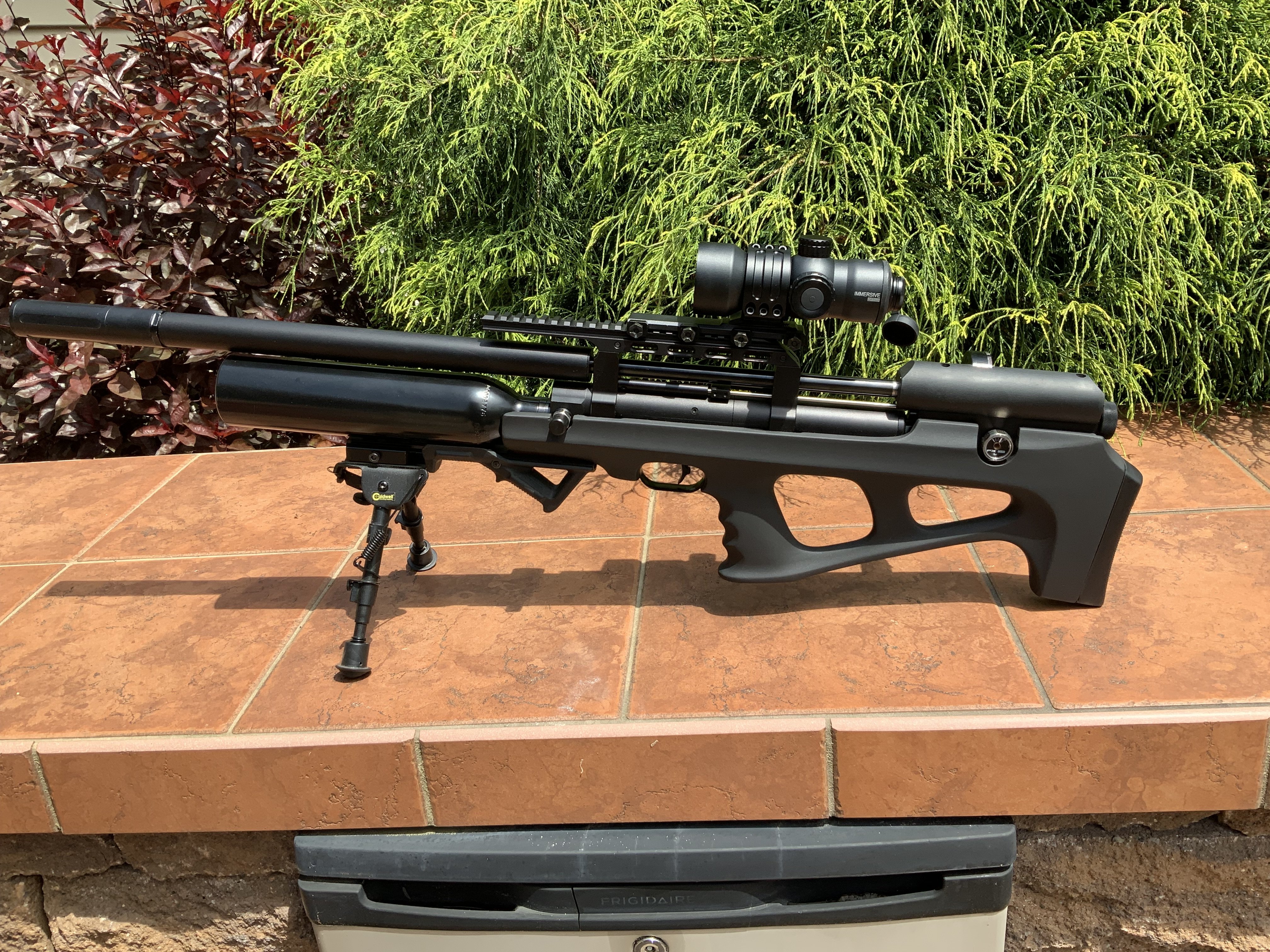

The Wildcat stock‘s forearm has an upward can’t to it. I wanted to mount an extended rail under the bottle so I got a 3” picatinny rail and ground the one end off to align the rail level to the bottle. I then had this tactical handle that I mounted to that rail . That gave me another 3” forward in the handle to slide in another 6” picatinny rail on which I mounted my bipod. one tightened The tactical handle touches the bottom of the bottle so it supports the whole set up perfectly. The synthetic stock is like a hard styrofoam and will compress easily if you crank down on any screw you put through it so be careful and don’t put much leverage on the picatinny rail once mounted or it will break the stock.

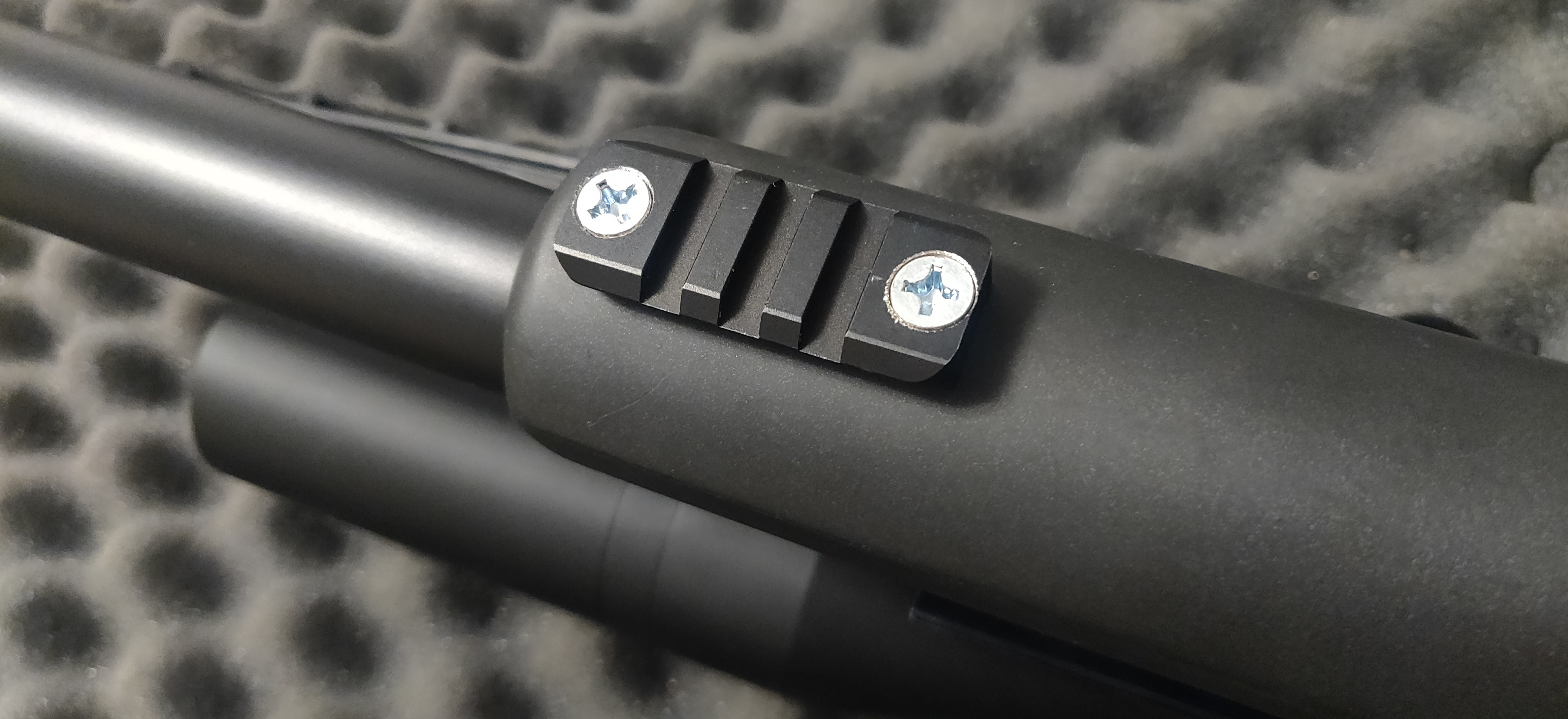

I used 1in. # 10 wood screws from Home Depot and a cheap picatinny rail. I'm confident in this holding up quite well as I have used smaller screws and they lasted. I drilled a hole slightly smaller than the shaft of the screw and slightly shorter than the length. Then screwed the screws in by hand. A bit of one screw poked through which I simply grinded off. Try to get a rail with large enough holes for the screws so they sit flush;)
