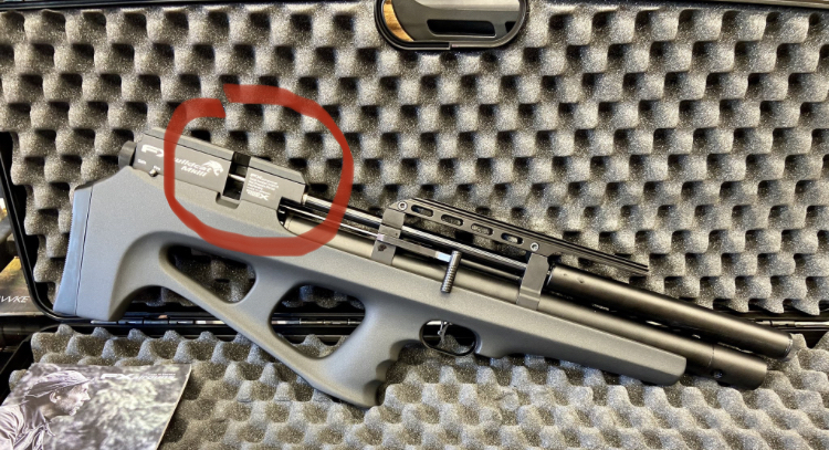

Ist mir bis jetzt noch nie aufgefallen, aber ist es normal das hinten Luft aus dem Lauf kommt wenn kein Magazin drin ist???

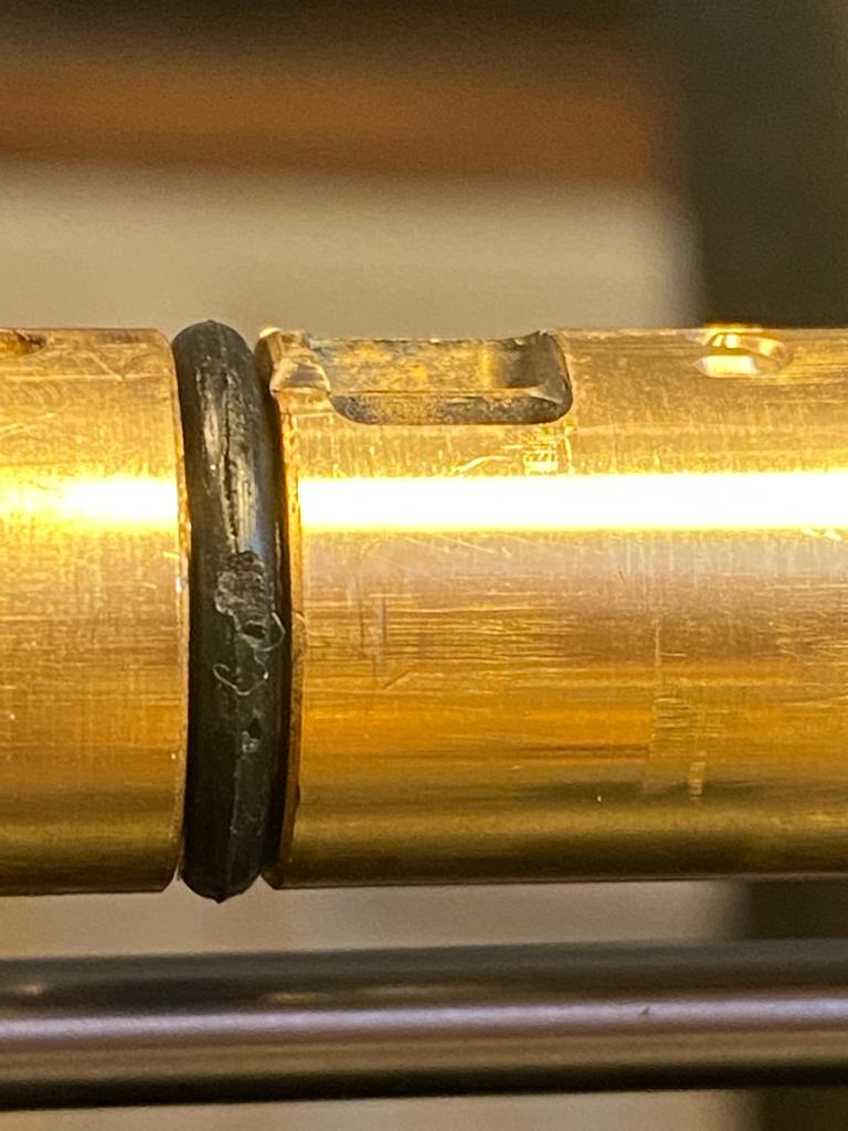

My newest gun, a wildcat mk3 bt, leaked at the breach O-ring when fired. It turned out there where some brass turning chips left in the grove, under the O-ring. The way I diagnosed the problem was that I tried a barrel from one of the other FX guns I have, which worked fine, no blowback. When I took the O-ring out, I noticed there was brass chips left in the grove, when I swapped it with a cotton tip. Blowed the grove clean with a shop compressor, and put in a spare O-ring I had, and everything was working fine. Guess one employee at the FX factory, had not cleaned the grove properly.
