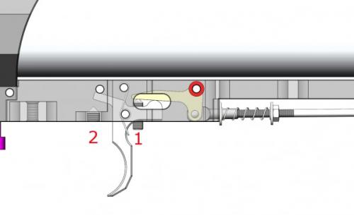

With the trigger in particular, as a critical part of the human-to-gun interface, using plastic here is risky no matter how comfortable it is. Some companies go as far as to gold plate the trigger to project an image of quality. High end airguns, which cost more than most firearms, need to not only be solid and functional, but also present a feel of precision and lasting character when held in the hands.
I wonder what risk are you talking about? I'll tell you my philosophy about it, as engineer. I believe that the device (no matter whether it is gun, train, plane, car or whatever) firs of all should be functionally perfect. I mean the creator should take care of the critical parts to serve as long as possible. On the other hand, the wise creator shouldn’t waste resources to make some parts over robust. As it lead to the increasing the price but without additional reability.
OK, we are talking about Matador/Lelya. Particularly about the trigger. Do you have an idea how it works? Here is the scheme. As you can see the trigger itself, is just a frame. It has no critical surfaces as the work is to be done with the two screws. So, what is the problem is the trigger is made of plastic (very robust by the way, as I’ve shown in the video before, or you can see the crash test of Matador synthetic stock bellow. Do you think if any of laminated or walnut stocks will be able to function after 200 kg (440 pounds) millstone drops on them? But the synthetic stocks even being cracked function father without any problem. So, the engineer’s task is to choose the right material for the right function in the device.
https://www.youtube.com/watch?v=s7fNn7e5o_8&t=3s
Ok, back to the trigger. Since it have the strengthens more than enough for the function it carries, the working element is still steel made I don’t see any problem why it shouldn’t be plastic? And taking into consideration the fact that it is more comfortable in the cold circumstances, it cannot get rusty in the wet condition I think it should be plastic.
Last but not least, the cost of the production for long term perspective and the speed of the production. We used to use erosion for making steel parts, even if I don’t care about the price (and I really don’t care about it if the question is quality and reliability) it took too long to make them and I do remember many times when I couldn’t assemble the guns, waiting the parts from erosion. And the funniest think they work the same way!!! Why should I follow the old methods, good for the small number of guns to be made? Just because somebody has the idea in mind that “metal is better than plastic”? Really?! To talk about what is better and what is worse, engineers ALWAYS consider the place where that part is to be installed.
And one more time, talking about the robustness. I wonder if any of the gun makers can do it with their guns?

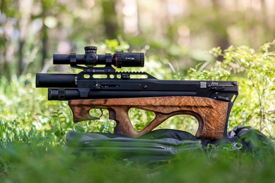

1568193703_2607201195d78bca7632920.24287463_1566826604_575544305d63e06cea4686.42529985_lelya2_...jpg
The high-end guitar companies have been doing this for years, offering hand selected figured woods for hundreds and sometimes thousands more! It turns out there's no shortage of guys that appreciate the finer things that combine beauty and ultimate performance in the same entity.

By the way, regarding the photo of Piotr’s Lelya. Yes, I got proposals many times, to grade the stocks by its beauty and charge more for more beautiful stocks. Thinking it over I thought that I would rather make some clients happy, when they have the nice stock based on the lottery principle :) not everything in this world can be measured with the money…

For R5M trigger, it is adjusted, yes, and even better than it was with R3M, one just need to read manual and adjust it, that is easy.
