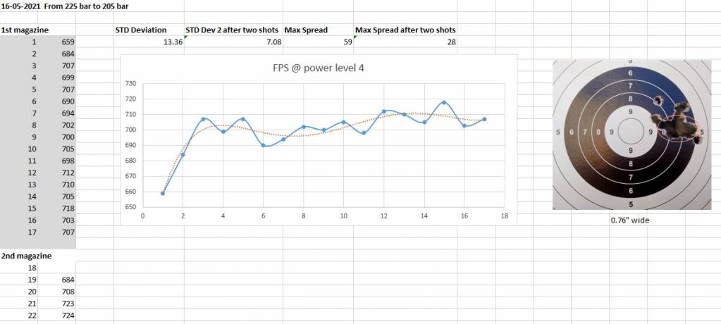

Anyway, I tried another magazine to see if I find any discrepancy in the FPS and here are the results:
The first two shots were way slower than the rest. I don't know why. First shot on the second magazine
low as well. Even without the first two shots the standard deviation is 28 which is horrendous.
The HW97K is having this FX for breakfast...
The grouping was not that bad at 25 yards because I was using a cheap Gamo scope with no parallax adj.
I expect much better results when the new optics arrive. (The group is in the red oval, the rest were from
the second magazine when I tried to see if it will do the same again with the lower FPS.)
So what do you think? Does it need a break-in period or shall I send it back for repair anyway?
Thanks.

Were it me I would just shoot it for a bit to see if the leak completely stops as you said it is less now after a little bit of shooting. Give the gun a few hundred rounds to break in before you condemn it further. It may just surprise you.
Sometimes a gun may arrive tuned to perfection other times it is not quite there. It really does not look that far off to me. You have an adjustable reg and a hammer spring adjuster so tune it to the pellet you are using and at the atmospheric conditions you are now in which may be completely different than the conditions it was tuned for where it came from.
1st shot could be due the regulator or the tune of the gun. Try a little more hammer spring and see what happens.

two first shots that are 40fps slower. You can also see that the FPS curve is not horizontal but it is rising.
Maybe there is also an issue with the regulator. I will keep shooting lead :) and will get back to report my results.
Thanks.
Not sure why a small leak like 5 bars a day someone assume the gun is damaged. Lmao. Like many have said, pcp are bound to leak. It is not the dealers fault. Maybe when they got it, it was holding air. During the time they sent it out it just started leaking. Who knows. My $2k impact was good one day, next morning was empty of air and I didn't freak out calling BS on the dealer and trying make them fix it, even though its still under warranty. I went on YouTube and watch videos on how to tear down my impact and I did the freaking job and I learn how my gun works, how to put it back together, which part goes where, which part does what. I learned so much about my impact just by tearing it down myself. As for the first couple shots to be slower that is normal. My $2k impact does it too. When you let the gun sit for a few hour or over night, the reg will creep some air into the plenum. So when the hammer hits the valve, there is more pressure behind it making it harder to fully open. Thats why u get the slower speed. Just dry fire 2 shots. If a 2k impact does it, why wouldn't a $1300 wild cat do it. Seem like you are making a small leak into something bigger than it really is.
