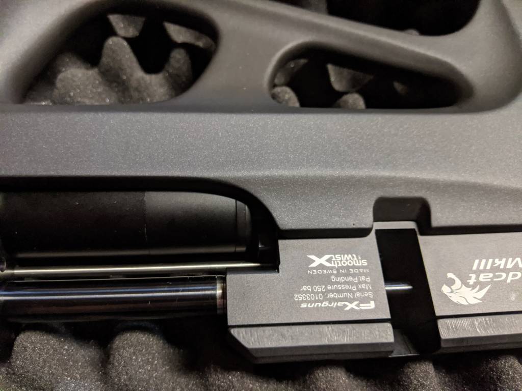

Received wc3 this morning, came with this sheet!
The last FX rep I spoke with mentioned "that special plenum install" so I guess it was "special".
I haven't shot it yet, will do this afternoon, and get some shot counts. I get plenty of 45-50fpe shots from my .25 DL, so I am fine with this one being a high powered low shot count shooter.
As FX themselves set my reg to 170, I don't think i have any warranty concerns.
It did come with a plenum piece installed, I'll get a pick of it later. Much sexier with out the gap from the DL plenum :D

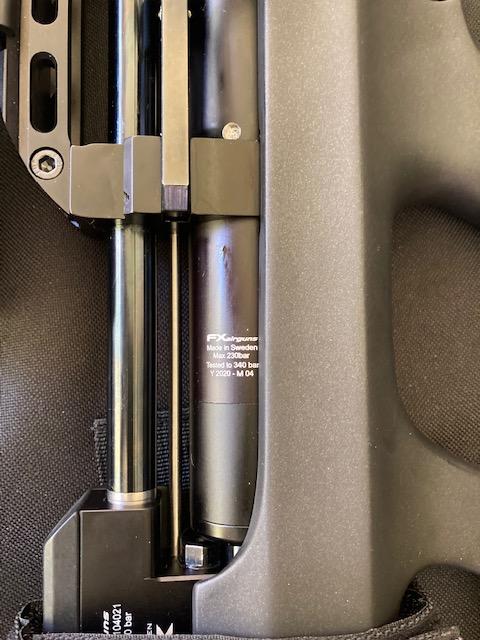

If it di come with the Ernest Rowe power plenum I am sure that is the reason of your power output now . I also have one installed in my .22 compact and this really makes a difference. Fit is perfect indeed. So now we can finally come to the conclusion that the power output FX advertises for their .25 Sniper is not to have out of the box but with the installation of an additional power plenum ( 40 dollar ex. Freight) and a very high reg setting voiding guarantee when we take FX manual by the letter . Wow.... I would set my specs a bit lower if I was FX .
That’s the one ! Got the same . This is a power plenum developed by Ernest Rowe and introduced in this forum by Joekool . Especially made for the Wildcat and Streamline. Main difference ( besides the gap 😉) With DL powerplenum is the fact that the adjustment hole of the regulator remains uncovered. In my case the screw thread resulted in an accessible reg adjust hole as you can see on my pic . And like I said no more need to couple 2 together as a double length version is available .
1f609.svg

Wimpanzee - can you measure that extension so we can confirm if it’s the 1” or 2+” version that can be purchased from Ernest?
And the million dollar question is whether the next batch of wildcats will have this installed from the factory or if it will need to be purchased and installed by the owner.
