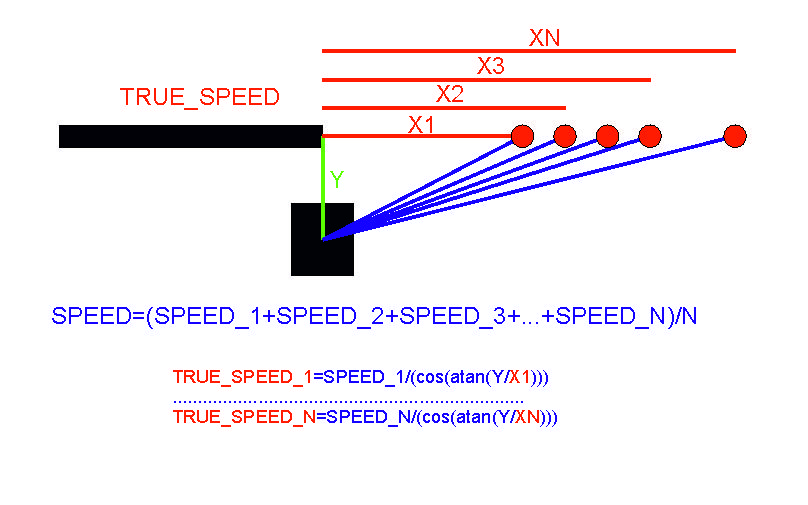

A nice presentation... but if the distance Y of the barrel is higher, an error is higher too.
https://youtu.be/1Mae7F3UuYI
When the XN ( max. operating distance) is short, a frequency of received signal, strongly depends on an angle.
An example 1 (Air Force Texan, assumed X, Y )
Y=4 in
X=20 in
TRUE_SPEED= 953/(cos(atan(4/20))) = 972 fps
An example_2 ( FX Dreamline, assumed X, Y):
Y=2 in
X=20 in
TRUE_SPEED= 909/(cos(atan(2/20))) = 914 fps
