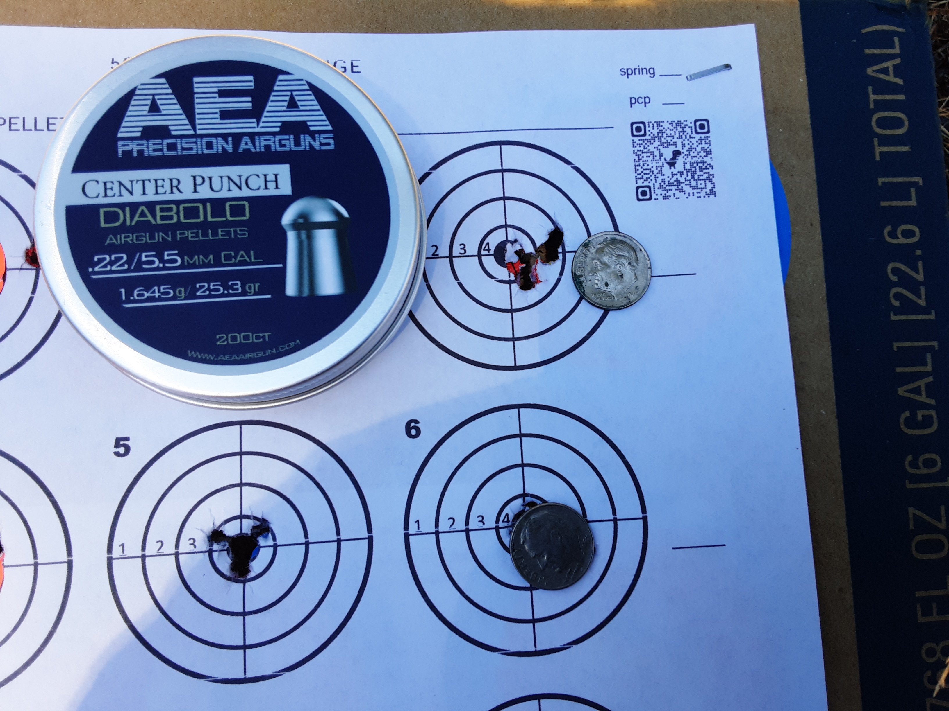

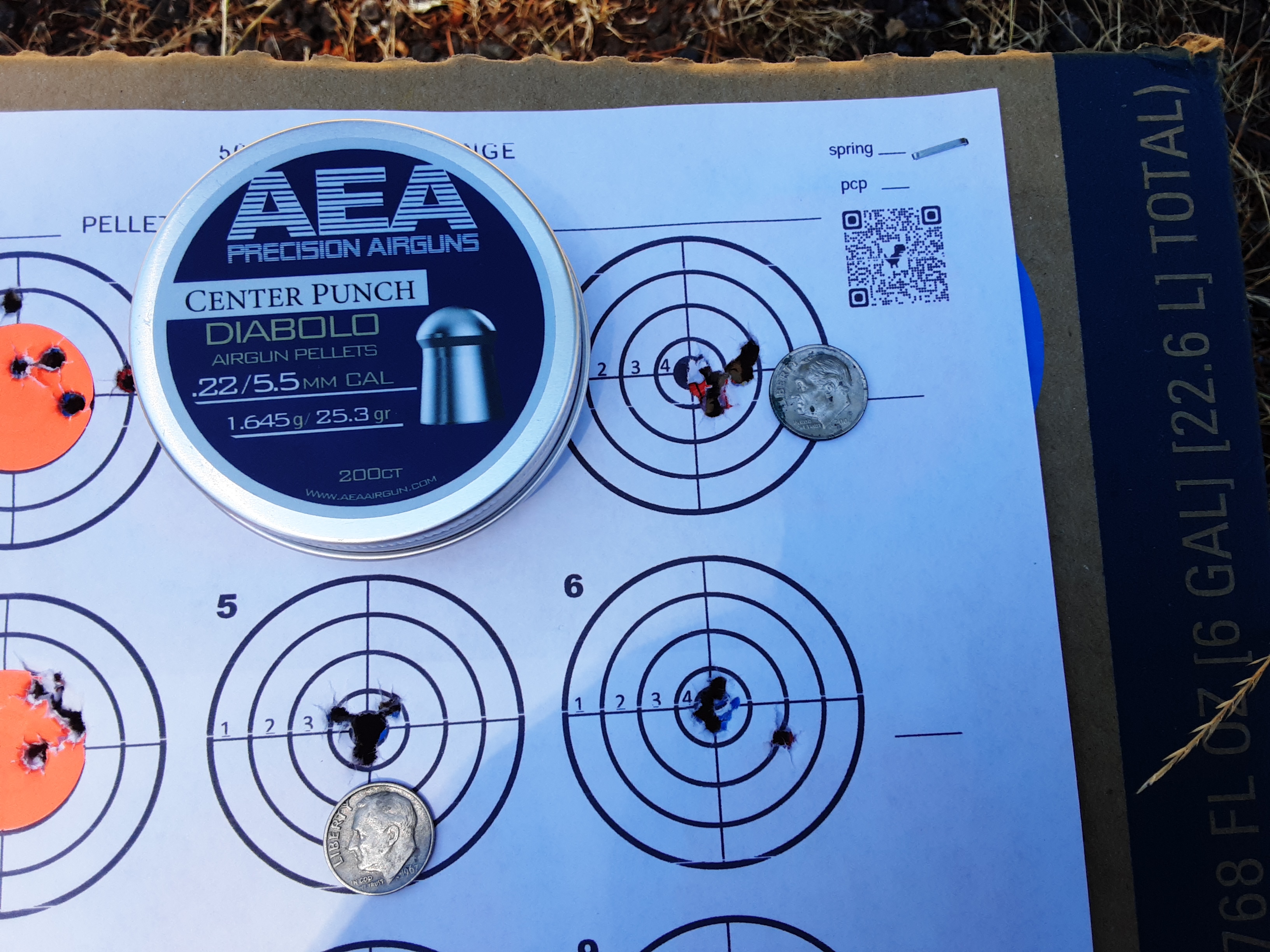

I have a Maverick .22 cal , 600mm with a 300cc bottle. I'm shooting 25.3g AEAs at 910 fps . It's more accurate than my bags, table and I can deliver , at this time. The one I pulled was still dime size . Target is at 50yd .
Reactions: coastal drifter
