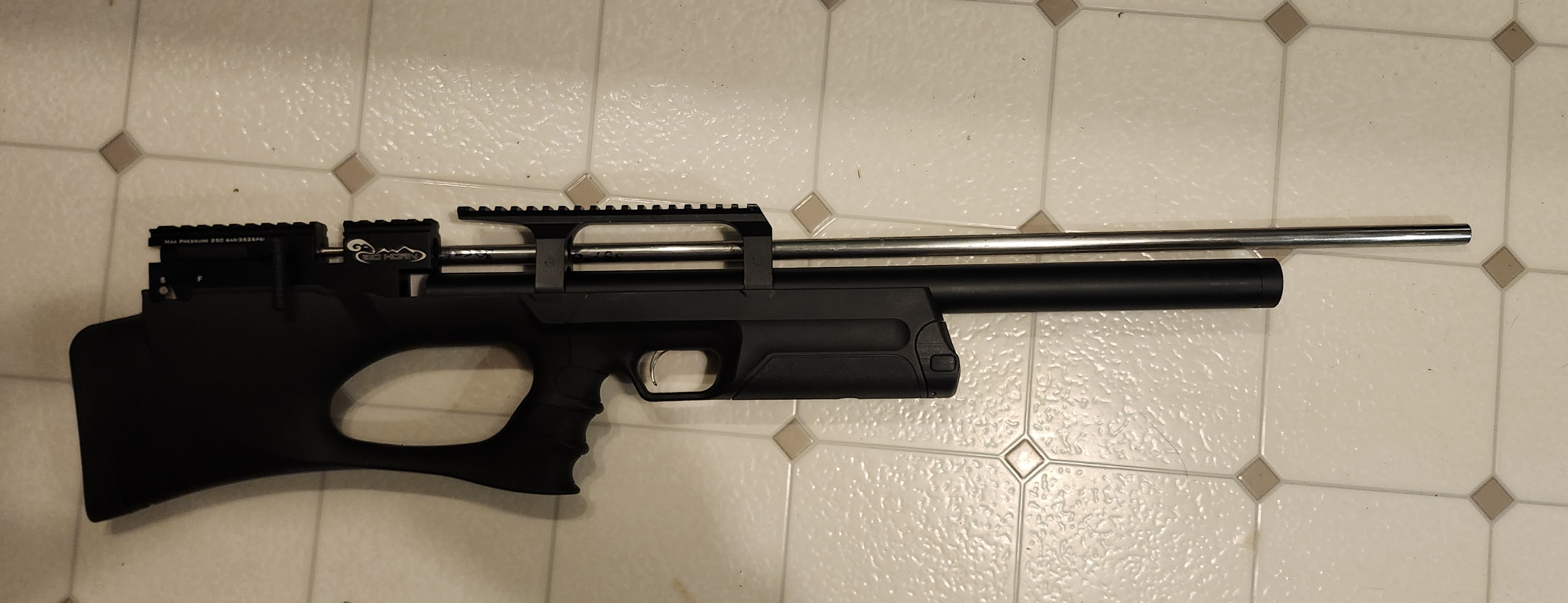

Rough mockup but as soon as I can get my hands on some FX DRS airtubes this is a 7lb bullpup at 36" long capable of over 100ftlbs in .30 with less than 10 orings, a 28" TJ hammer forged barrel and capable of sub MOA at 100 yards with a good shot count for about half the price of an FX Impact. Would be shrouded with a 1/2x20 adapter for a suppressor.

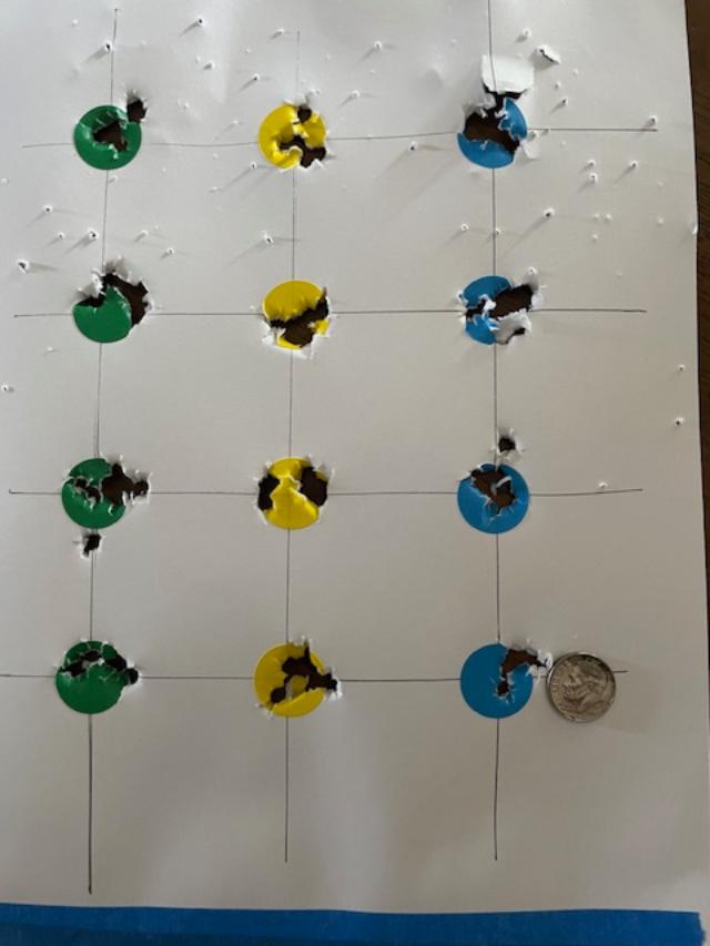

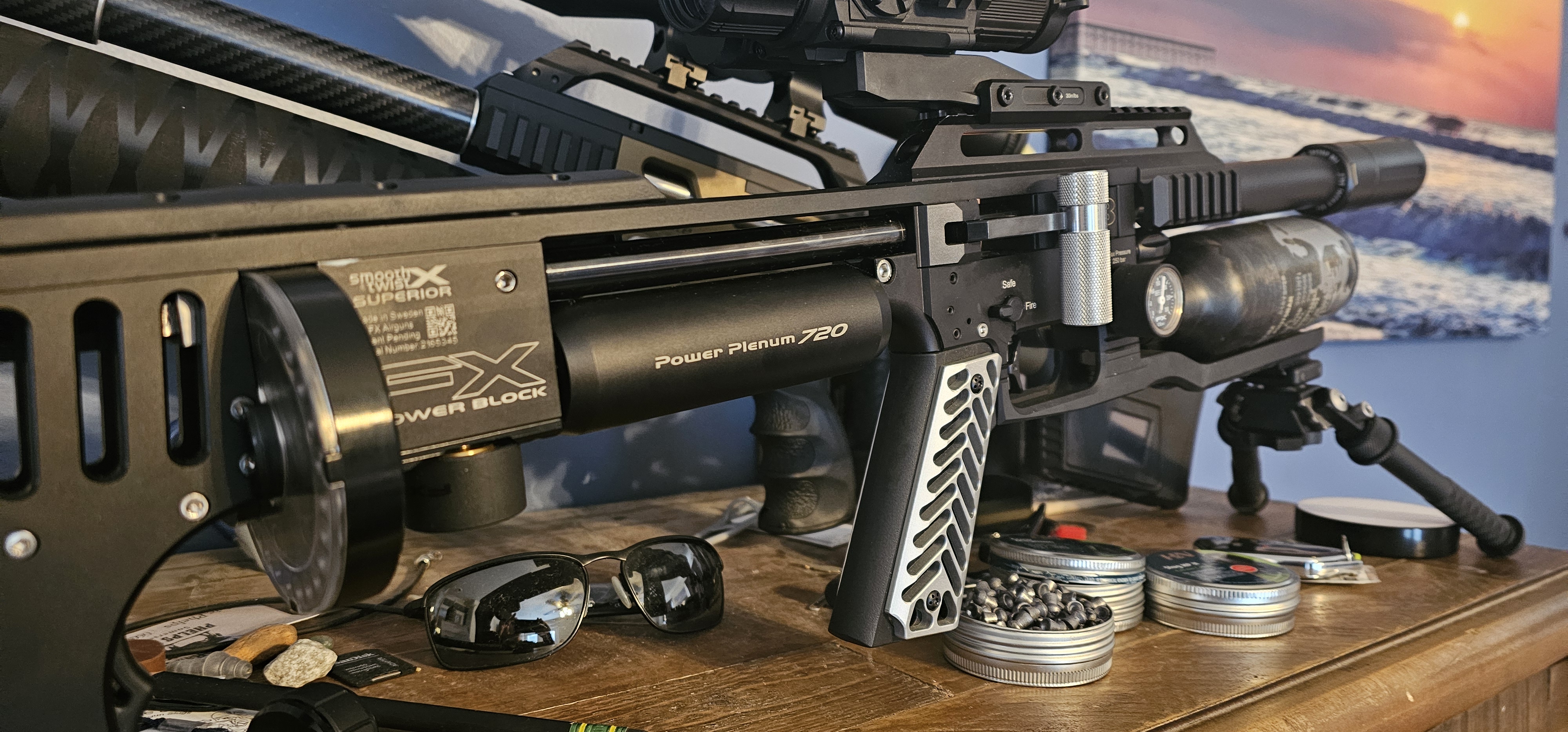

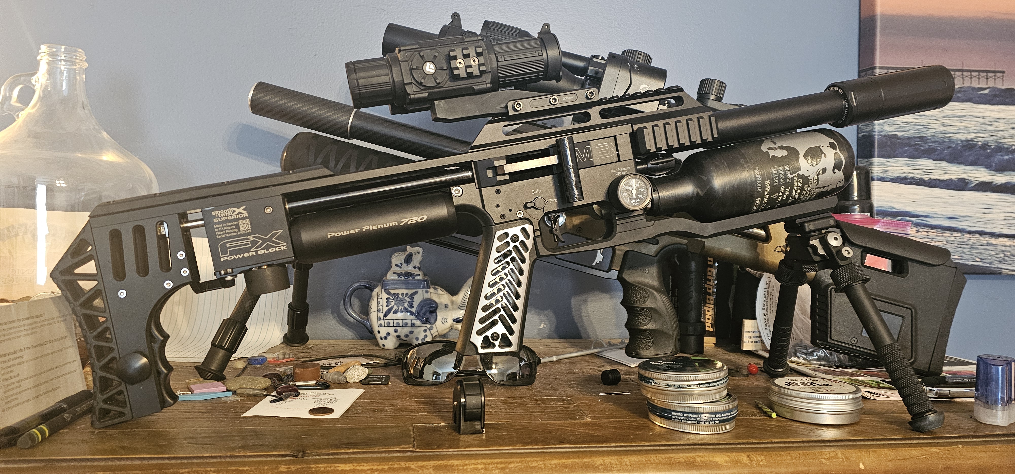

.22 is hard to beat for ammo selection, efficiency with air, quieter than larger calibers. The .25 is a great in between caliber and shoots the 33.39 JSBs at distance with amazing accuracy. The 600mm barrel setup is also a great in between length and you could always change barrel lenths and calibers down the road if you decide to in the future. My M3 shoots the 18gr JSBs @ 900fps+- with amazing accuracy and gives me over 200 shots on reg with a 250bar fill. Picture of average groups at 40 yards on an average day with moderately light winds 8-15mph, 7 rounds on each dot. half inch at 50 on calm days is typical.
Bone stock M3 600mm barrel.
