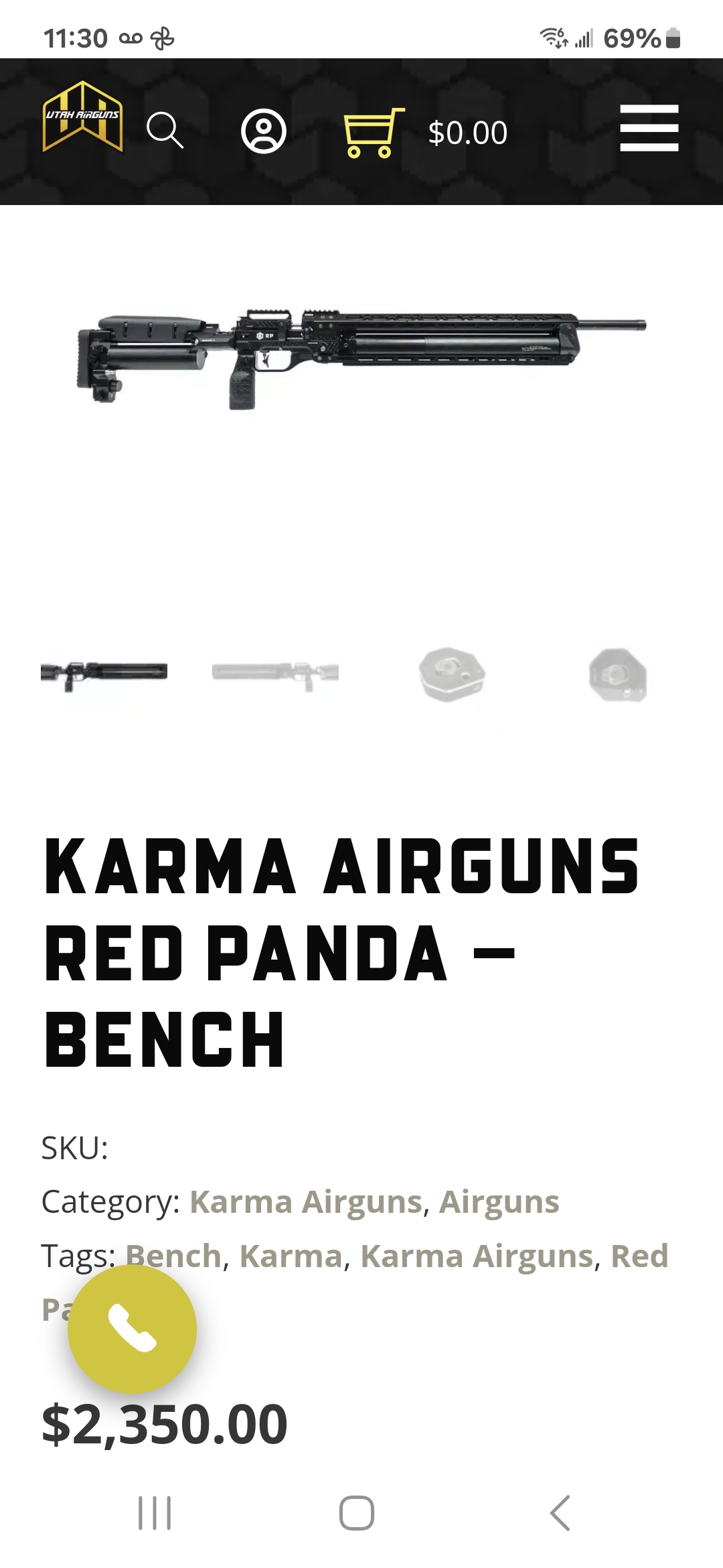

This seem to be the hot ticket for Br at the moment. Keep in mind expensive equipment alone will not get you there. It's the nut behine the trigger that count.
Although you can buy performance, only so much. That said, the top BR shooters, meaning the top 20%, all use the best of the best everything. That means top-of-the-line Daystates, Brococks, FXs, Epochs, and (now) Karma rifles, the most expensive optics, and all manner of shooting aids, accessories, gadgets and gizmos. Suffice to say Bench-Rest competition is a very equipment-'centric' competition. $$$
It wasent that many years ago a guy walked up on a turnement and outshot them all with a stock gun ( RTI prophet as i recall )
I am not competitive shooter myself, but i feel if you are a good shooter and have a OK gun, you can still give those high rollers a run for their money.
So i would just get a good rifle and get under way with the hobby.
Mind you when i say OK gun, that's probably still up there around that price tag on the Red Panda, 1500 - 2000 USD for sure.
Also i dont think you need that expensive badda bing scope to be able to shoot 50 yards benchrest, you should be able to do that just as fine with something priced a lot lower.
Same i feel about bipods, CUZ i have never tried one of those extremely costly Accutec ones, i actually use a airsoft one myself
