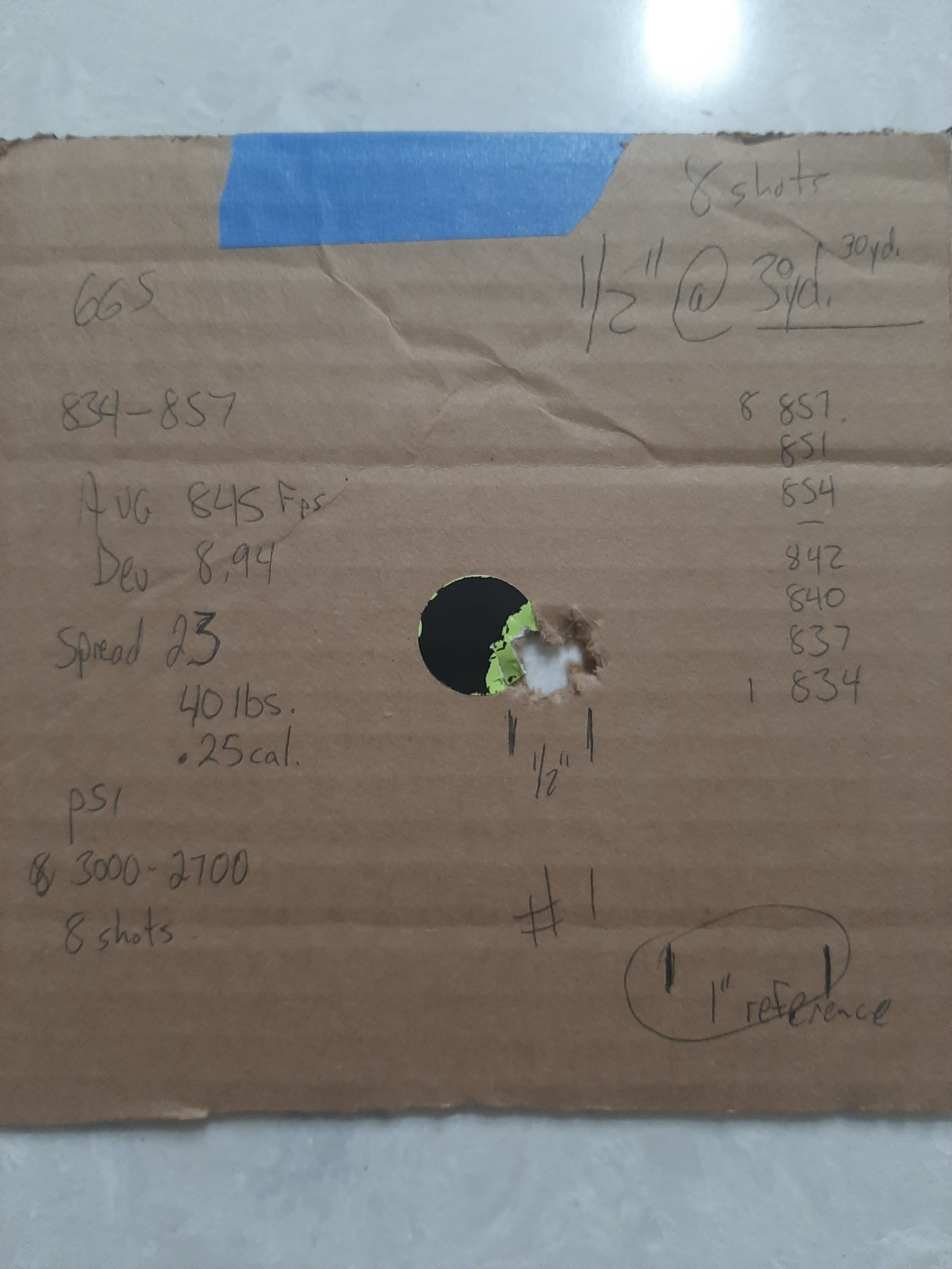

Recently purchased a G2 Mrod. I've tuned the gun first, using Dave Hisownself method, I think called the BLT. It's a 6-6-5 tune. Then I tried the A- team method. I can't seem to get my velocity past 860. I'm shooting JSB king 25.39. I've tried various starting psi and my groups are pretty consistent but I'm not that happy. All the info is on the card, psi start, avg vel, spread etc., but long and short, 8 shot groups, 30yds and this is my best. The last card is using H&N baracuda 30.86g and it's about the same. Is this the best an M rod can do, or is it just me?
