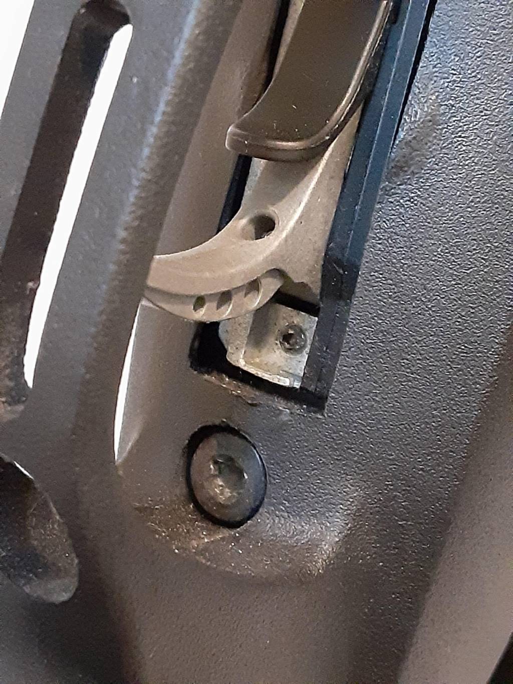

Hey kit I also installed the longer trigger screw, I got it from airgundetectives. Well the recoil is so harsh a piece of that screw literally broke off, so now I can't adjust it. I just want to say to anyone reading this with the gamo magnum, be careful in installing this screw. Just Because it happened to me doesn't mean it could happen to yours. Again just a thought to be aware of. And back to OP topic.

Well with over 30 years experience shooting springers, I purchased a bag of stainless steel screws for like 12 bucks for 100. So far so good. Yep stuff breaks on Magnum Springers and sometimes goes flying such as in the field in the leaves never to be seen again. Grin! As those screws from the Detective are a soft metal, I would take the proper size small drill bit and a dremel tool and gently and carefully drill the screw and them remodel an allen key and sharpen it to 4 edges with a small file, take off part of the filed tip so it fits tight, tap it into the screw hole well, in effect you just made an easy out. If that does not work there are several custom replacement triggers available and not sure if I can name them and follow the rules. As for original replacement parts, do not know of any available and sending a rifle to Rogers Arkansas and paying them them to replace it and with shipping on average 60 bucks each way, the custom trigger is much cheaper. Now......hum.......if it is in far enough take the rifle apart, remove the entire trigger assembly and just maybe with a small vice grip get hold of it where it comes through, possibly. Unfortunately with Gamo there are no replacement parts available other than simple breech seals and a few misc o rings. Gamo does not provide replacement parts.
