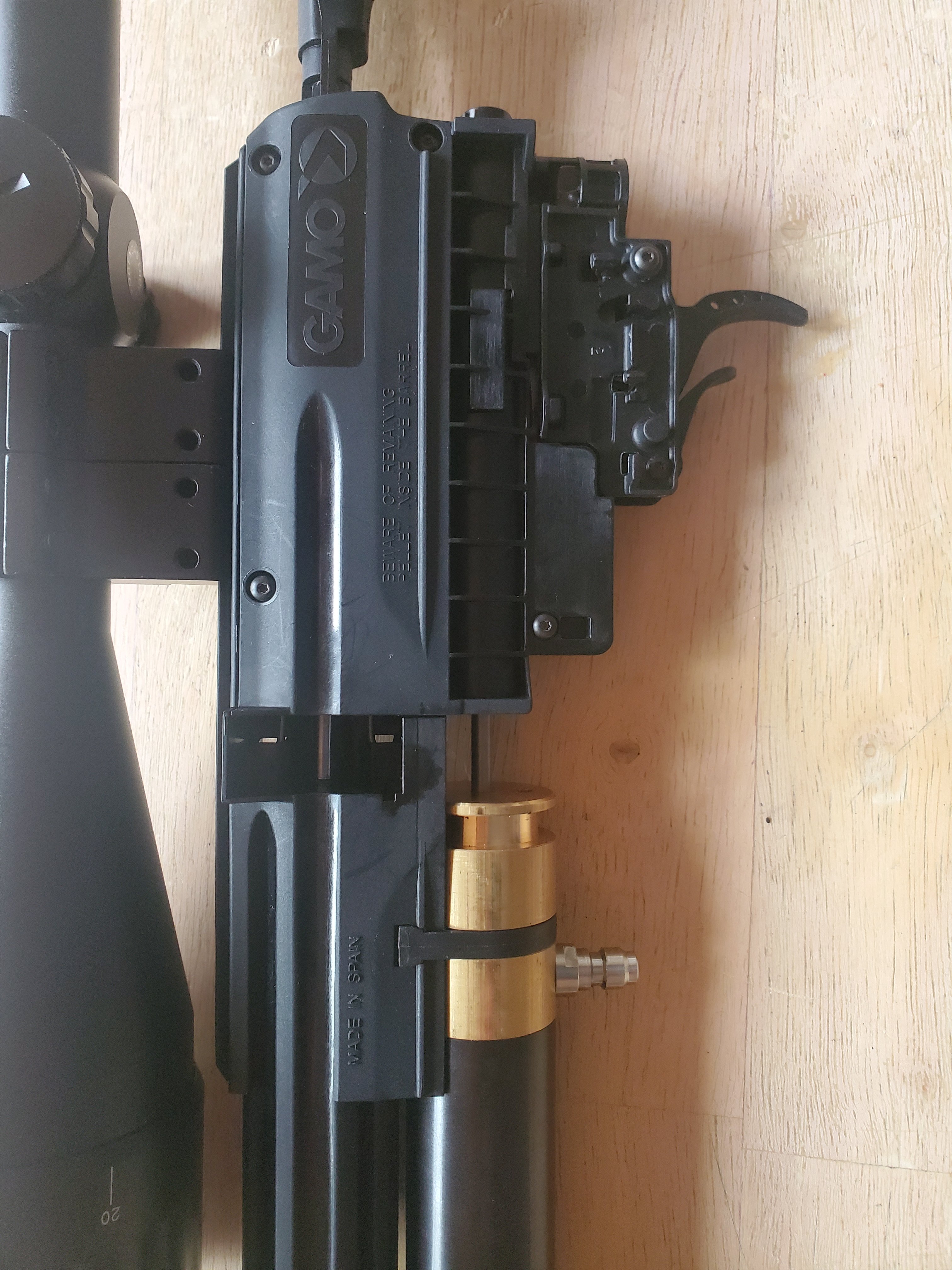

Build quality
On the outside everything is synthetic.
The receiver is entirely synthetics.
The metal screws which hold the left side receiver plate will screw into this synthetic/plastic.
Metal screws in plastic will not last very long.

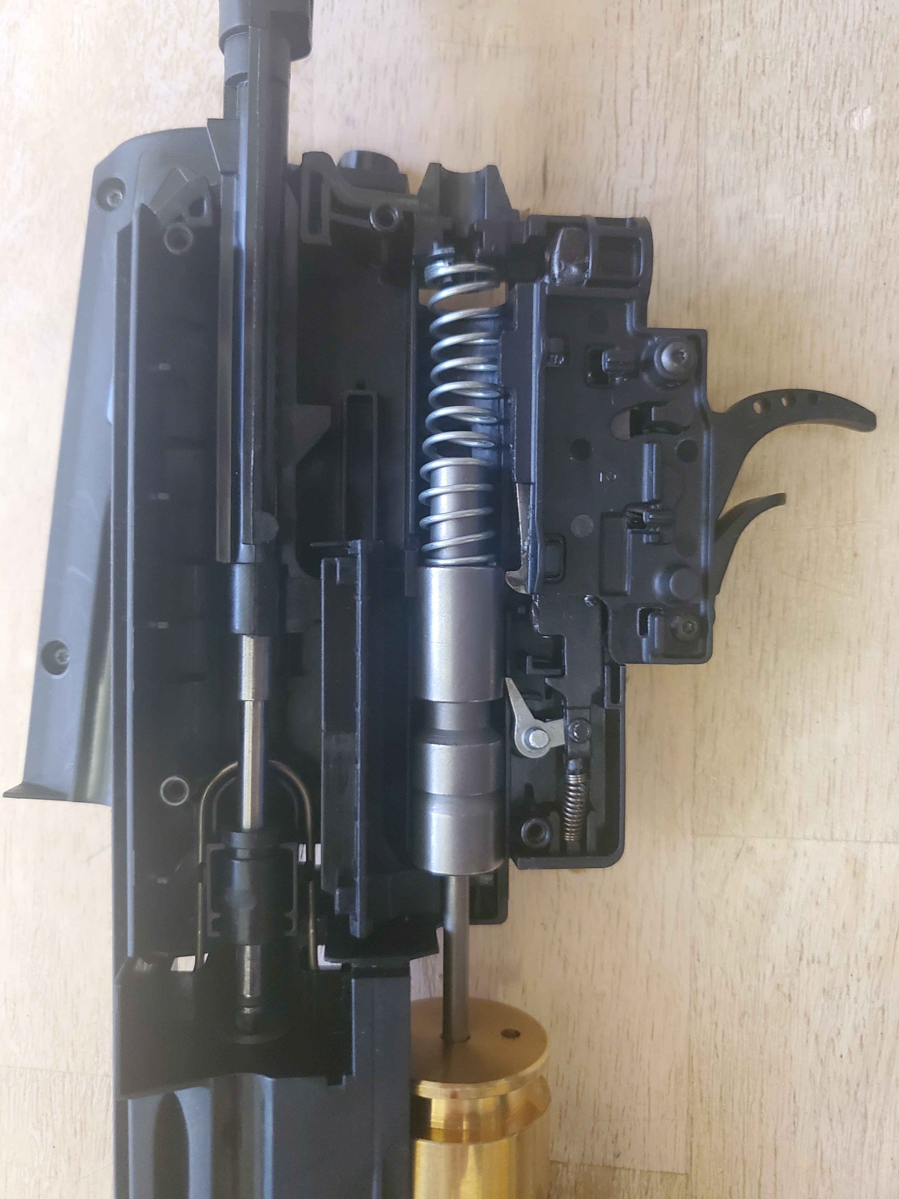

The internal parts are also mostly synthetic, except for the hammer, hammer spring, bolt, etc.
The barrel shroud and the right side of the receiver seem to be one big piece of plastic.
It is impossible to remove the barrel without destroying the shroud, and making the rifle useless.
Two plastic straps hold the air tube attached to the shroud.
The valve is attached to the air tube and you can get them both out of the rifle without degassing.

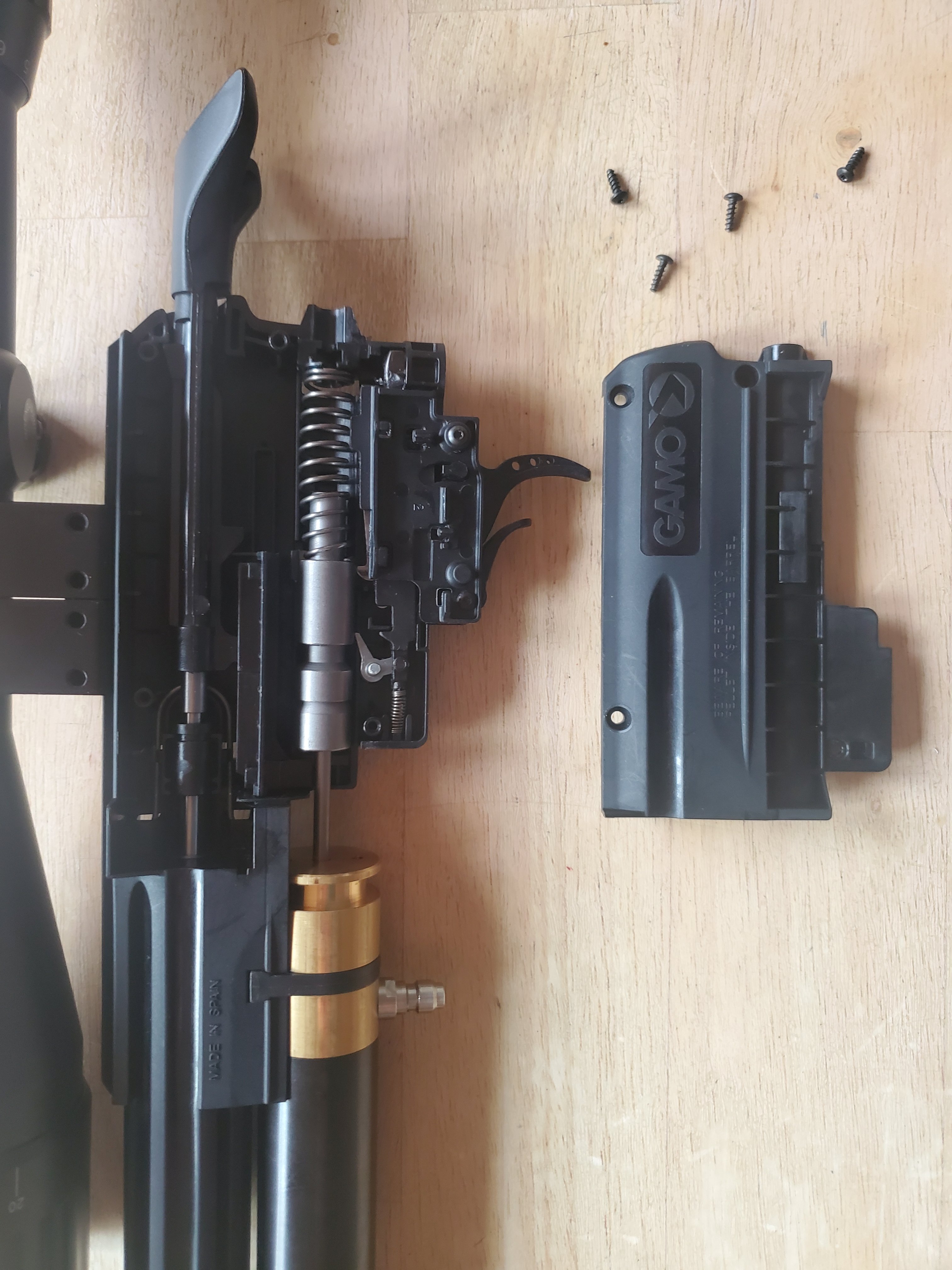

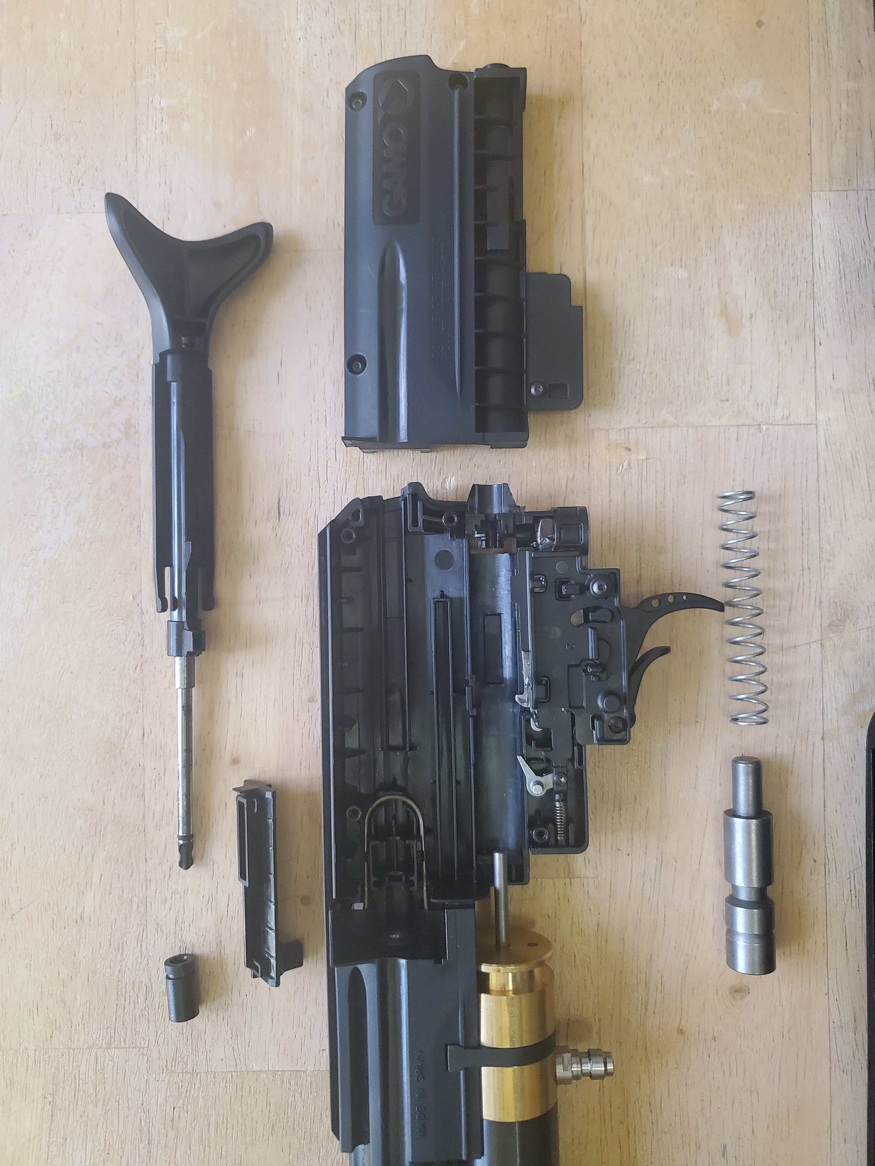

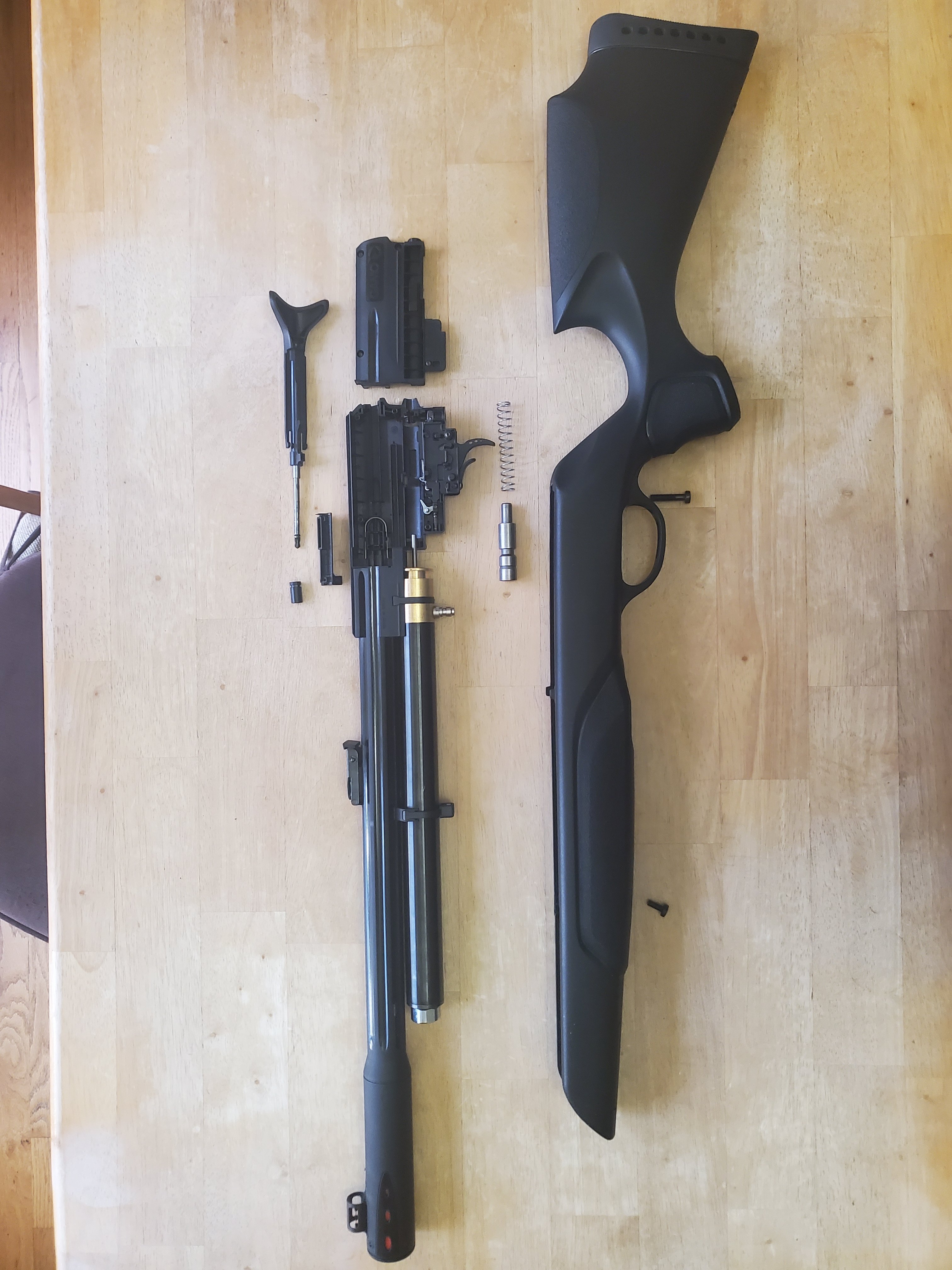

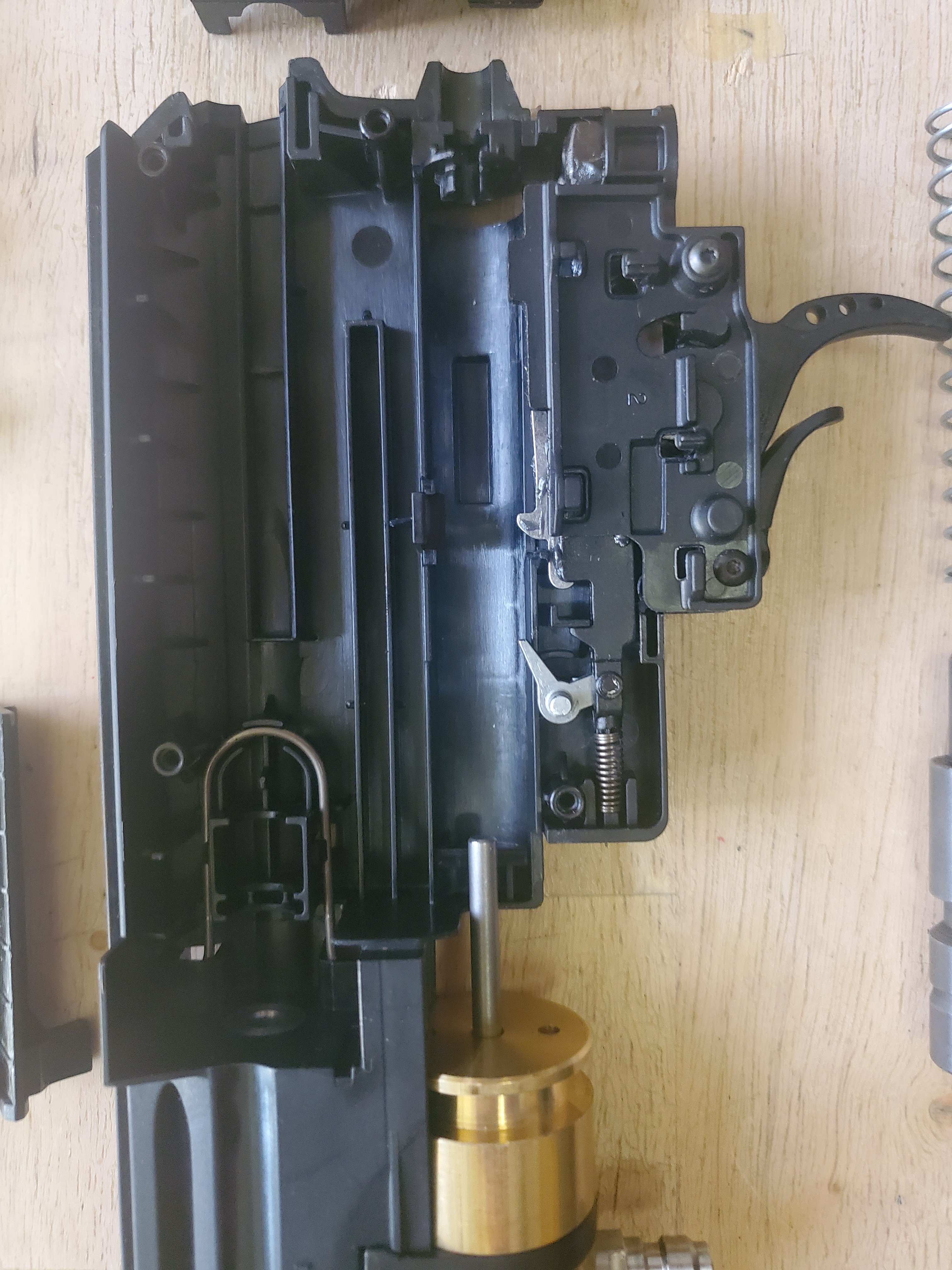

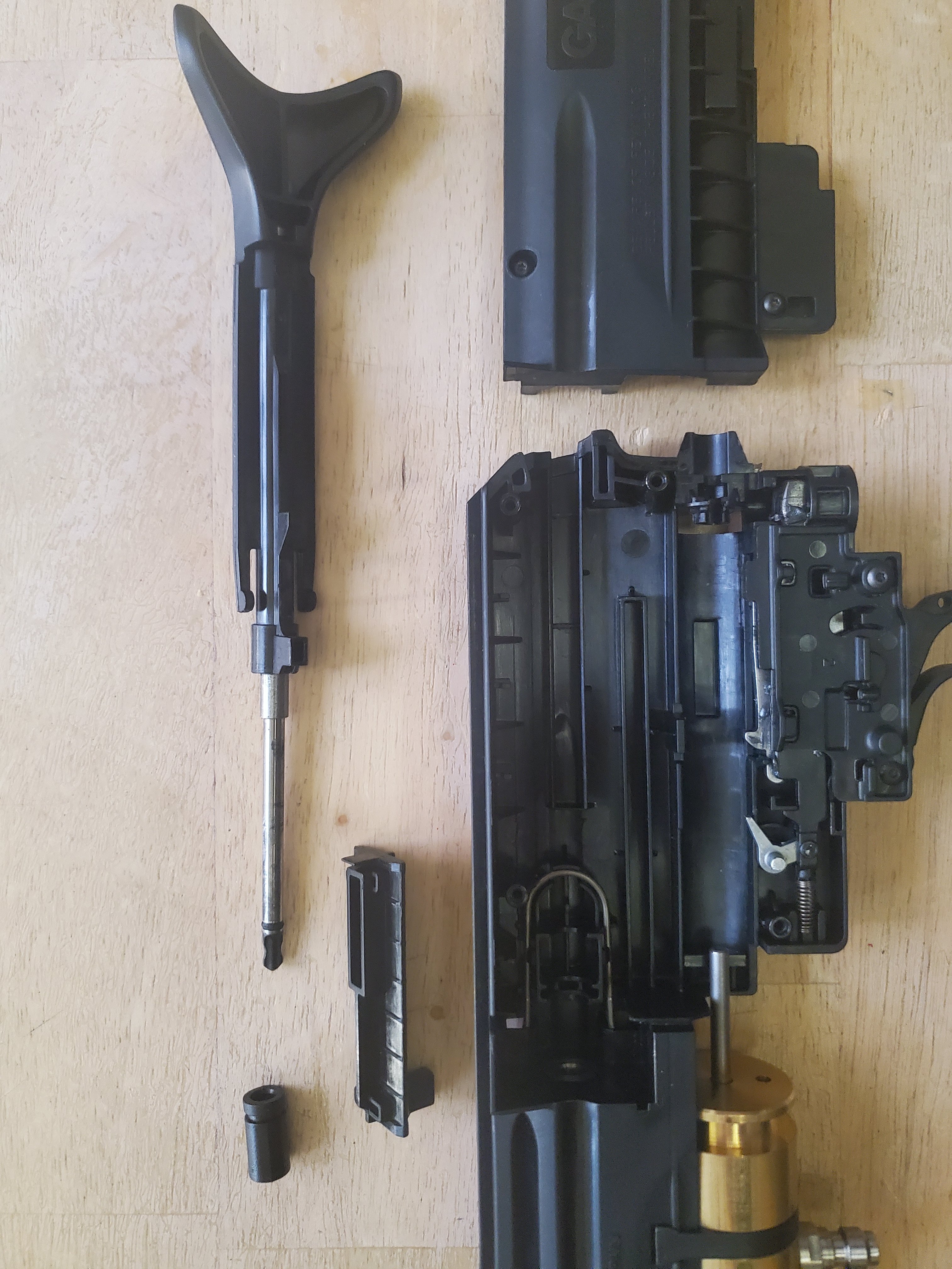

Internals and partial disassembly
The disassembly involves:
-remove the 2 stock screws
-remove the stock
-remove the 4 small receiver screws,
Hold the receiver plate because it can pop out.
-remove the receiver plate
Do the reassembly in reverse order.
Internal photos are attached.
Do not shoot the airgun disassembled because the 2 plastic straps holding the air tube will detach, and some screws will fall out :).

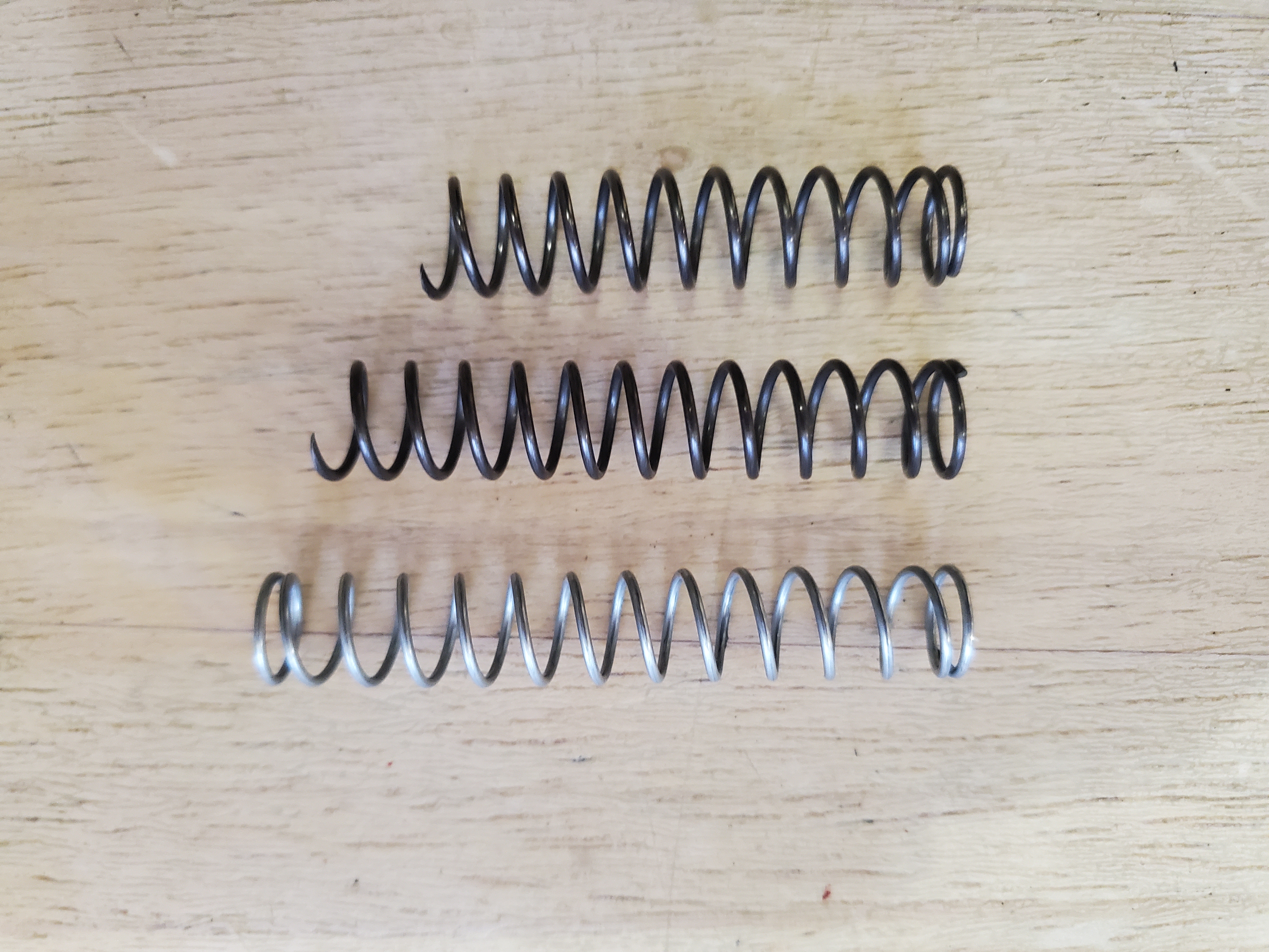

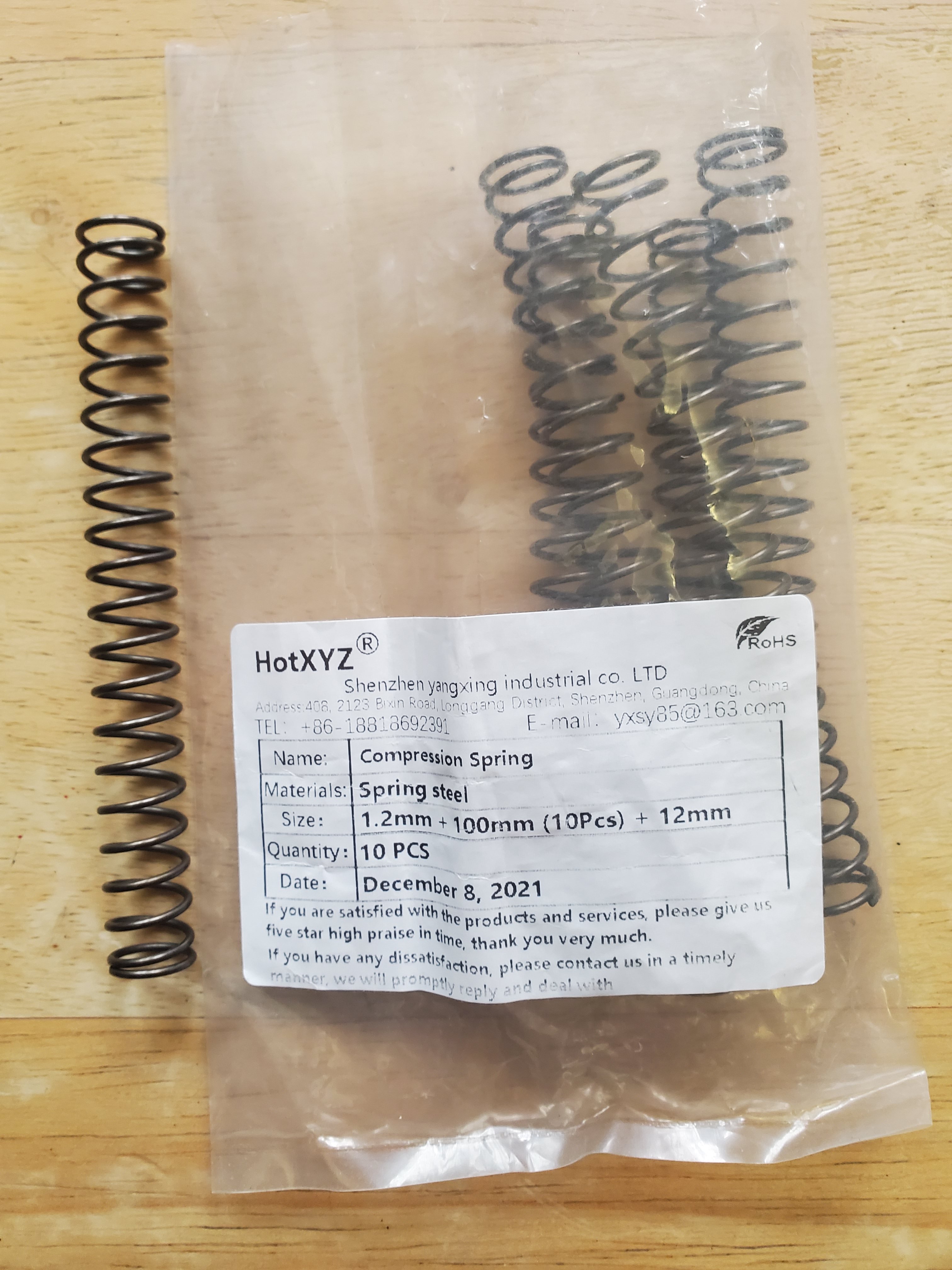

The main tuning involves changing the hammer spring, since there is no hammer spring adjustment.
The original hammer spring dimensions are: 1.1-1.2mm wire, 11.5mm outer diameter, 67.5mm length
For my hammer springs I have used this: https://www.aliexpress.us/item/2255800219014836.html
I have made 2 springs:
-52-53mm long for lighter pellets
-62-63mm long for heavier pellets (Crosman 10.5 grains)
When cutting the hamnmer springs the maximum velocity with Crosman 10.5 grains was around 960-965 FPS which gives about 21.5 FPE.
If you want more power you will probably have to drill out the transfer port.
Another option (if you have a lathe) is to make your own transfer sleeve/port with different diameters.

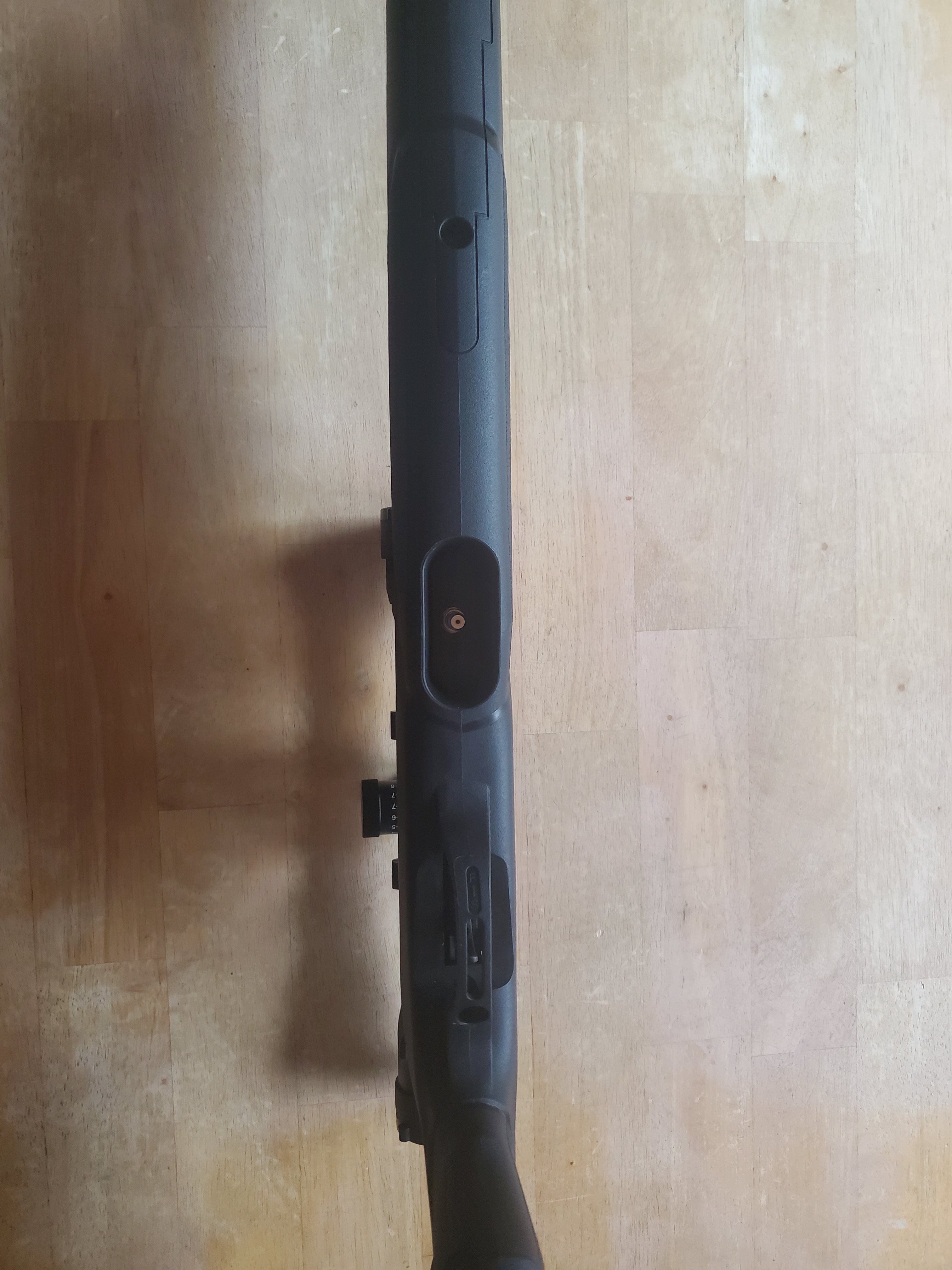

The Foster nipple is located in a very tight spot.
You can use only 2 fingers to attach the fill hose female Foster to it, which makes it pretty hard.
-remove the stock

Similar airguns
Gamo Arrow retails around $220.
Compare the Gamo Arrow to the Beeman offerings (Chief 2 Plus, underlever 1357/1358, Crosman Icon etc).
For about the same price as the Arrow, the Beeman PCPs have a solid build and good to great accuracy.
The only thing that is better for the Arrow is the shot string which is due to the excellent BSA valve.
Other reviews
Troy Hammer's reviews
Tom Gaylord's review
Airgun Depot review (they obviously want to sell this)
There are several youtube reviews which are usually paid and are a combination of clueless and promoting.
Positives
Excellent shot strings, 40+ shots (4 magazines) with a 30-35 FPS spread.
The Gamo Arrow uses the same (or similar) valve as the BSA air guns (Urban, Buccaneer, etc) which explains the shot strings.
3 years Gamo warranty
Relatively low noise
Cheap magazines
The Arrow uses the same magazines as the Gamo Swarm Gen 1.
The magazines cost less than $15, usually around $12-$14.
Negatives
Accuracy which is acceptable, not great.
Build quality reminding of Crosman/Daisy multi-pumps (Daisy 880, Crosman Legacy, etc).
The cocking bolt/arrow sometimes blows slightly open when shooting which will lose velocity and make lots of noise.
Even after many pellets I kept having this issue.
This is clearly a poor design.
Conclusion
After 8 days and over 1000 pellets I decided I had enough and sent the Gamo Arrow back to the store.
Photos
View attachment 424936View attachment 424931View attachment 424937View attachment 424932View attachment 424940View attachment 424938View attachment 424934View attachment 424933View attachment 424935
View attachment 424939View attachment 425018
I didn’t know you can take a new gun apart, modify it and then return it. Ballsy No one cares about the next guy I guess
