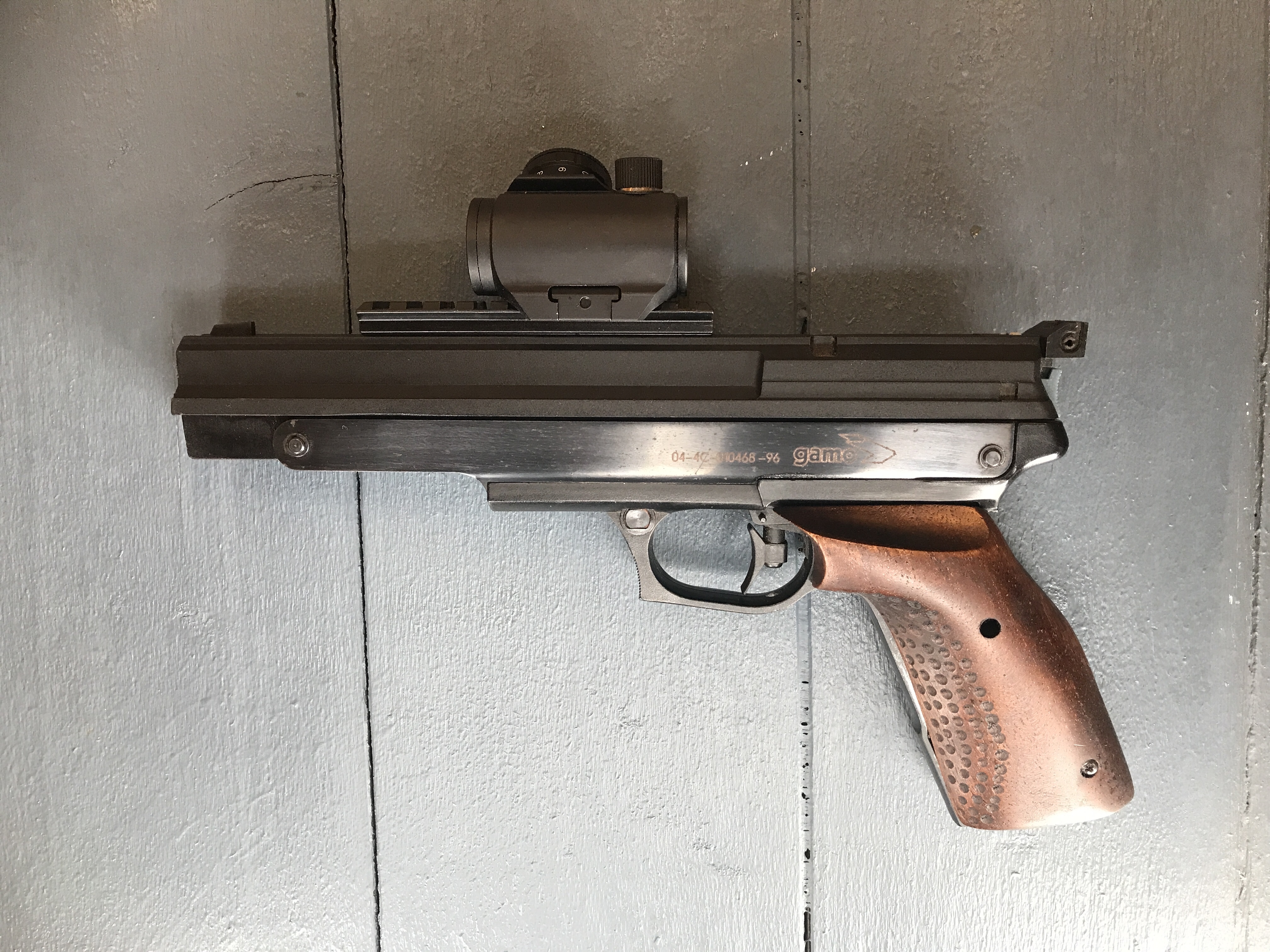

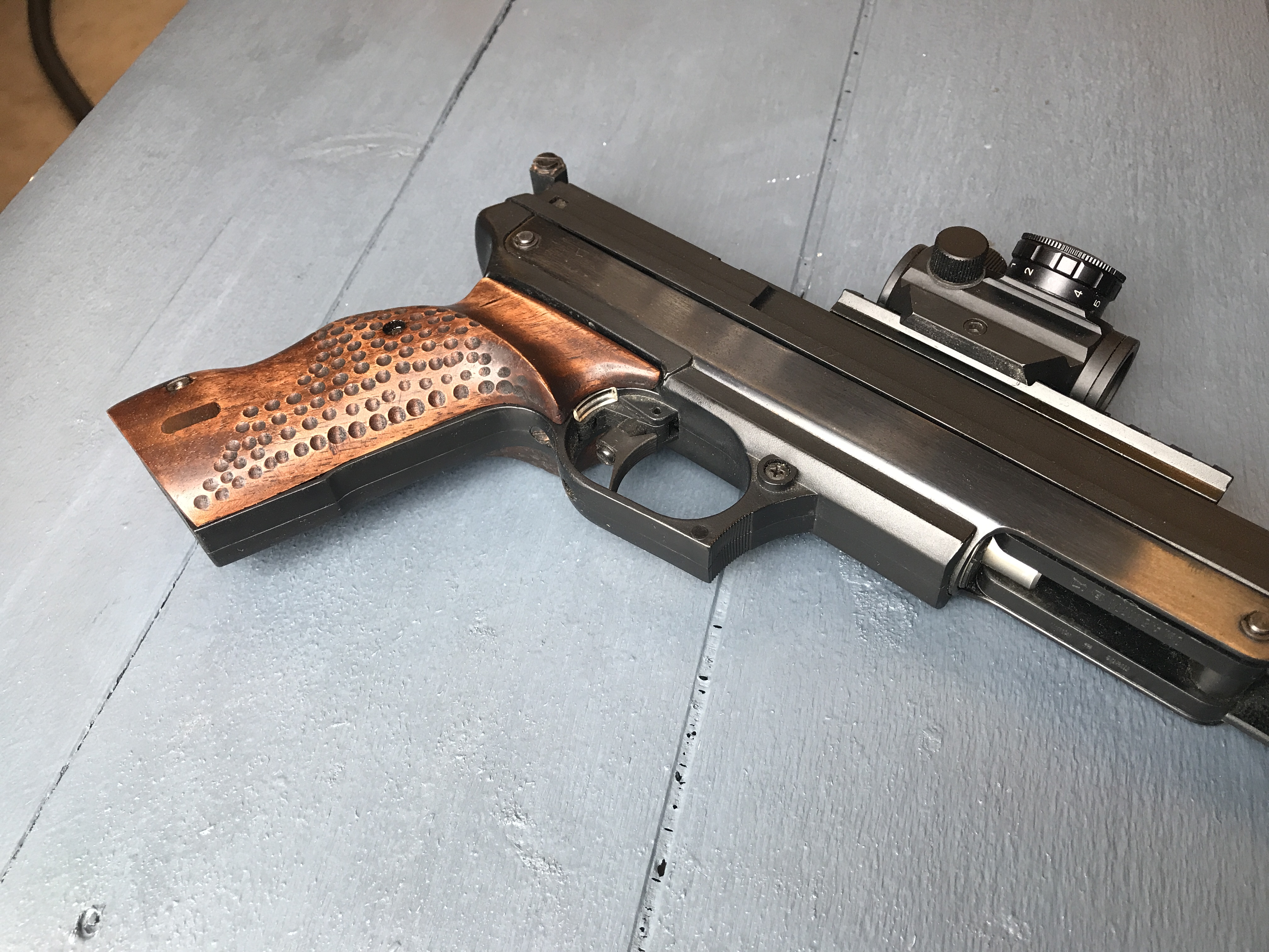

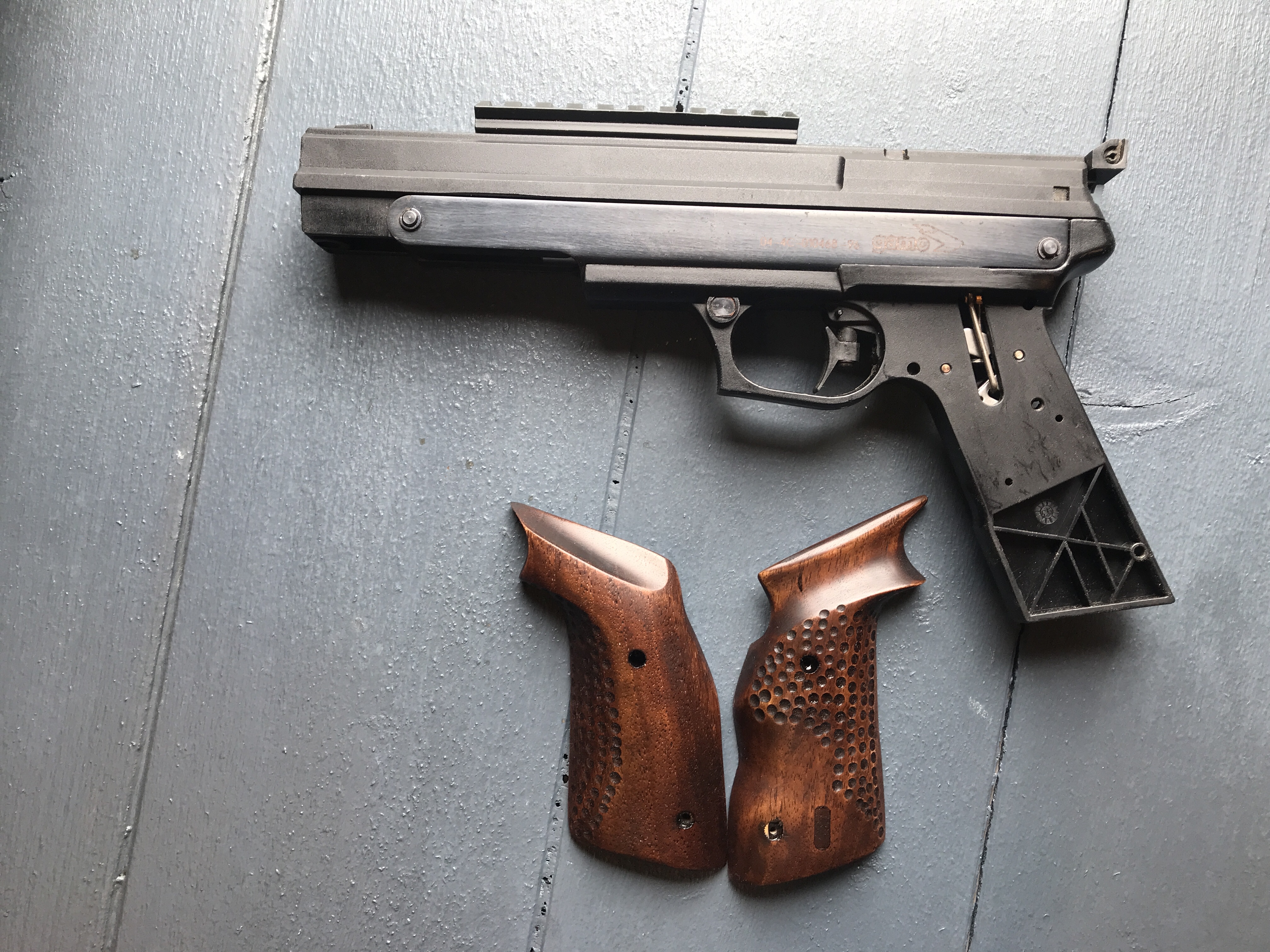

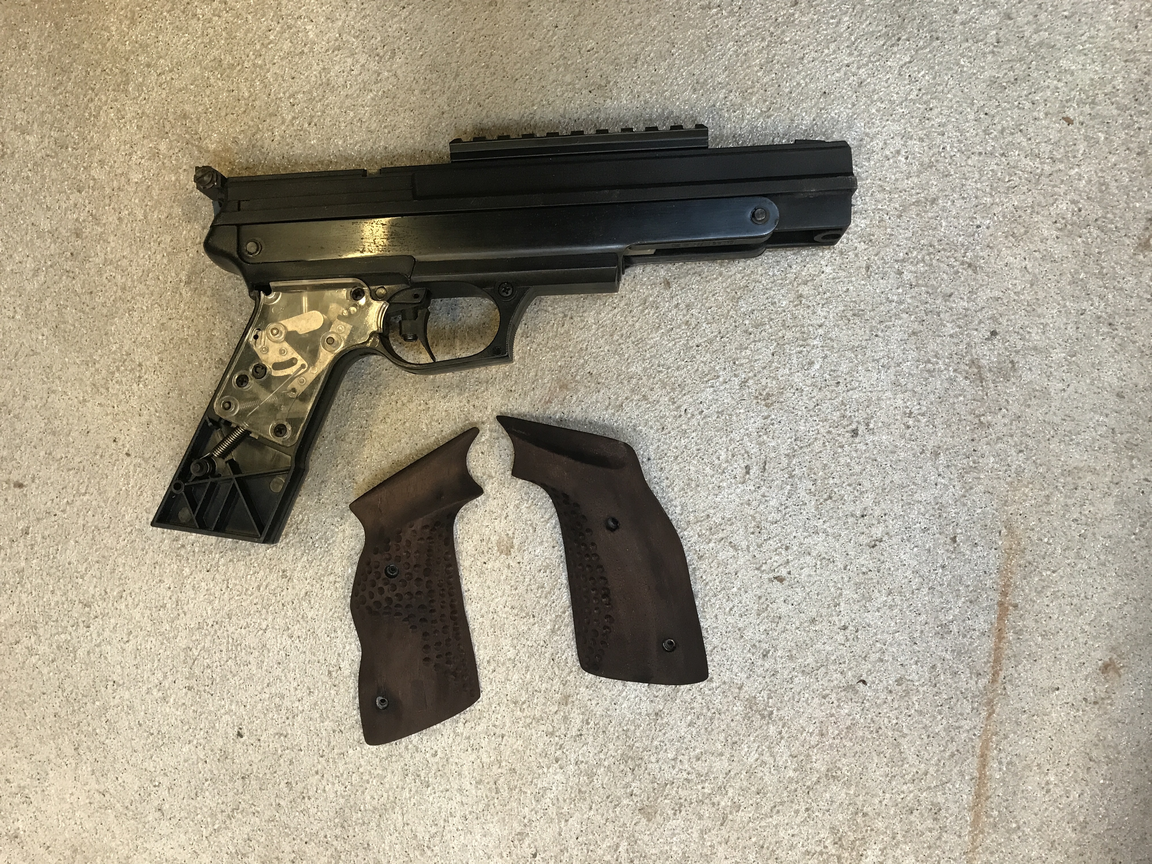

Oh yes, but it’s possible to do something about it. A drill, a band saw, sanding paper, some Herdins dark walnut paint, a picatinny rail, a red dot, and you get a handy, precise and an almost recoil less shooter.
i had worked on a weaver picatinny mount years ago but never finish it milled the cocking handle down and use and low profile mount so the sights still could be used
the project sits next to me as i type this
if you open up the trigger assembly with the plastic cove off watch the trigger
you will notice that the trigger moves about 4mm before it engages anything
put a piece of something in there and tape it over and take the take up out of the trigger, i cut a chunk of urethane
the grips are an interesting take on improvement

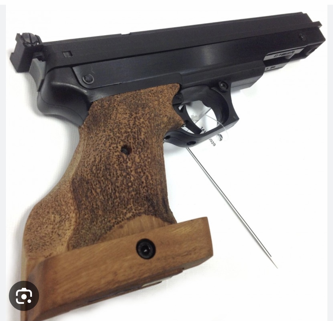

I still have FASsie-Mae! I took off the rail and weights, and shoot her when I want to be humbled. She still shoots so much better than me. Definitely better than the Gamo. The rail and weights are in the box with the pistol. I don't like optical sights on a pistol, and the open sights are so nice to use.

Jockotobling - I can live with a light RD on a pistol (65 years and eyes so,so). Even a small scope when it comes to the high powered pistols are ok in my book. But I am more skeptical when it comes to converting pistols to “small rifles”. Even if it is meant to clip on/of in a heartbeat. It kind of ruins the advantages a pistol represents. Oh yes. Have to admit that I have one. The AP16 with all the rifle converting gear, moderator and bipod….
Filling a suitcase of its own, stored away and never have been mounted.
But a red dot…. Opened a wider use for me, and made pistol shooting so much funnier.
