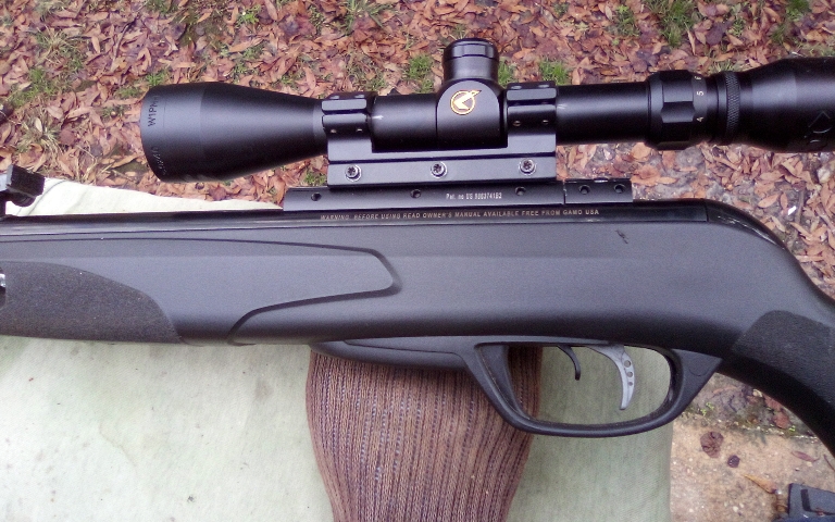

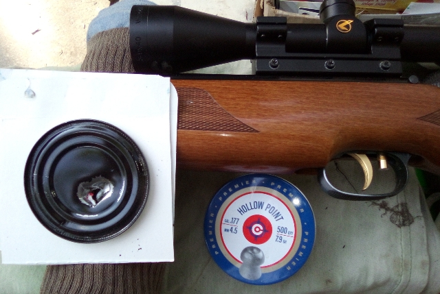

They'll take it or they took 2 from me ( all package scopes). Thing is. Maybe you het a better then maybe not.. i think of 4 i made one good that holds zero . Just can't focus too well and i taped it down to 8 power ( power ring turns when shot ..lol)
Here it is in full glory on the ol'R9 and gamo

But all jokes aside there not the best . But you seen my 100y tried with that gamo package . What more do i ask of one outside holding together...lol
