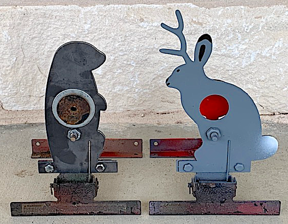

However upon receipt, I worried about the considerably heavier paddles falling consistently to clean hits; especially from 12 foot pound AAFTA pistol hits... out to 35 yards. But upon upgrading a few of my most beat-up Gamo targets with the QUALITY face-plates and paddles, I was impressed enough to start wondering about their possibilities for Extreme Field Target use.
First things first, I tested the jackalope below at 40 yards with my 10.5 foot pound AAFTA pistol. Much to my relief, the jackalope functioned flawlessly with 7 foot pound hits from 8.4 gain JSBs.
My first question answered, even if the 1/8" thick, non-AR500 steel replacement face-plates are tougher than original Gamos, no doubt they won't hold up to Extreme FT rifle hits. But not easily deterred, and having ordered all the replacement face-plates with 1.5" kill-zones in order to accept heavy-duty (THICK) reducers I have on hand, by also using 2.25" O.D. steel washers between the reducers and face-plates the face-plates might have some chance of surviving hits from EFT rifles. Unfortunately that question will go unanswered until which time foul weather and other priorities allows testing.
So for the time being, the prairie dog target above, left 'in the raw' for illustration purposes with the reducer and washer in place, remains 'food for thought'... aka- a question. I'll answer that question soon as weather and priorities permit. Meanwhile,
