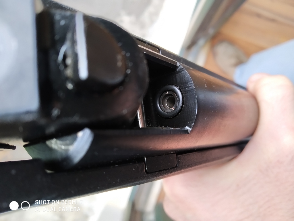

Can anyone tell me what is the diameter of transfer port for full power version (45j) of this rifle? I bought my rifle online and got reduced power version so i drilled my transfer port to 3,5mm (1.37795 inch) but still i dont have full power like original 45j model. Is now my hole bigger than it should be or i need to drill a bit wider hole?
this is my gun before drilling:
this is after drilling :
and this is how transfer port looks on original 45j model :
Am i loosing some power because my exit hole (just under barrel breech) is bigger than diameter of transfer port hole and it is not parallel with barrel breech like in original 45j model??

I hope you meant 3.8mm to 4 mm. I really don’t think the transfer port is the way they reduced the power . I would be willing to bet that the gas ram installed even though it has the same part number has a lower fill pressure or it has leaked slightly . The other thing to look at would be the catch on the piston , could very well be that the stroke has been shortened .

This is a futile effort! In Spain, the Airguns Rifle "Gamo G-MAGNUM 1250 Mach 1" is sold only with a reduced output power of 24 Joules and also with a weaker gas spring IGT - 160 Atm. Also, the transfer port is a little strangled - I estimate that the diameter of about 2.4mm. However, with this IGT gas spring (160 Atm / 80kg) it is possible to achieve an output of about 30-32 Joules, but larger values are probably not!
I'm afraid it is not enough to just drill a larger hole in the transfer port, but it is also necessary to increase the spring force. For Airguns G-MAGNUM 1250, enhanced pressure springs from Russian manufacturer Vado 123 are sold on eBay :
Premium VD” - 180 Atm / 90kg … transfer port cca 3,2 mm - 36 Joules
Megapower VD” - 200 Atm / 100kg … transfer port cca 3,5 mm - 40 Joules
Gigapower VD” - 220 Atm / 110kg … transfer port cca 3,8 mm - 45 Joules
However, it should be noted that this result can only be achieved at the cost of an extreme increase in gas spring pressure to 200 to 220 Atm, as well as excessive stress on mechanical components, increased recoil and lower accuracy of firing and airgun life. Personally, I would not recommend increasing the power to 45 Joules much.
Optimum performance 36 Joules Airgun "Gamo G-MAGNUM 1250" with a compression cylinder 29 x 120 mm can only be achieved with a perfectly balanced gas spring mechanism with an optimum pressure of approx. 170 Atm / 85 kg.
These gas springs from Vado 123 also have a drain valve so that the pressure can be adjusted to the required value. By mutual varying the transfer port size and the spring pressure, an optimum balance of the entire pneumatic system mechanism can be achieved.

Thanks for the valuable advice! However, the recess in the Transfer Port hole does not have such an effect on the performance, after all, there is another cavity in the pelet's skirt that has an effect on the compression!
As far as I know, no one with the original Gamo IGT gas spring has yet managed to achieve the declared marketing value of 45J. Usually it ends at 32J to 36J because these springs are only pressurized to 160bar (Atm) for export. 😭
It is necessary to pressurize to a higher value… 😅
180 bar … transfer port cca 3,2 mm - 36 Joules
200 bar … transfer port cca 3,5 mm - 40 Joules
220 bar … transfer port cca 3,8 mm - 45 Joules
