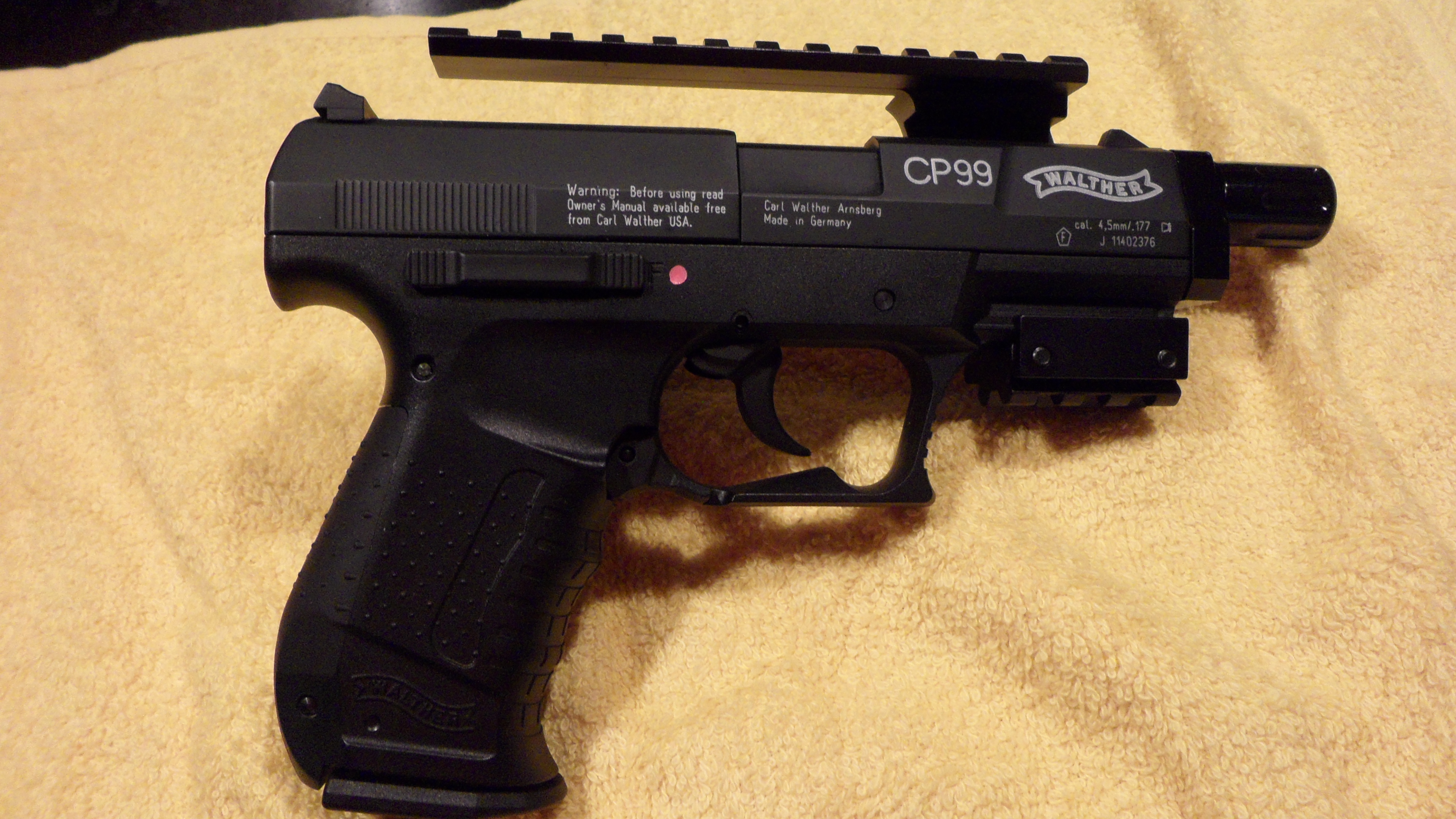

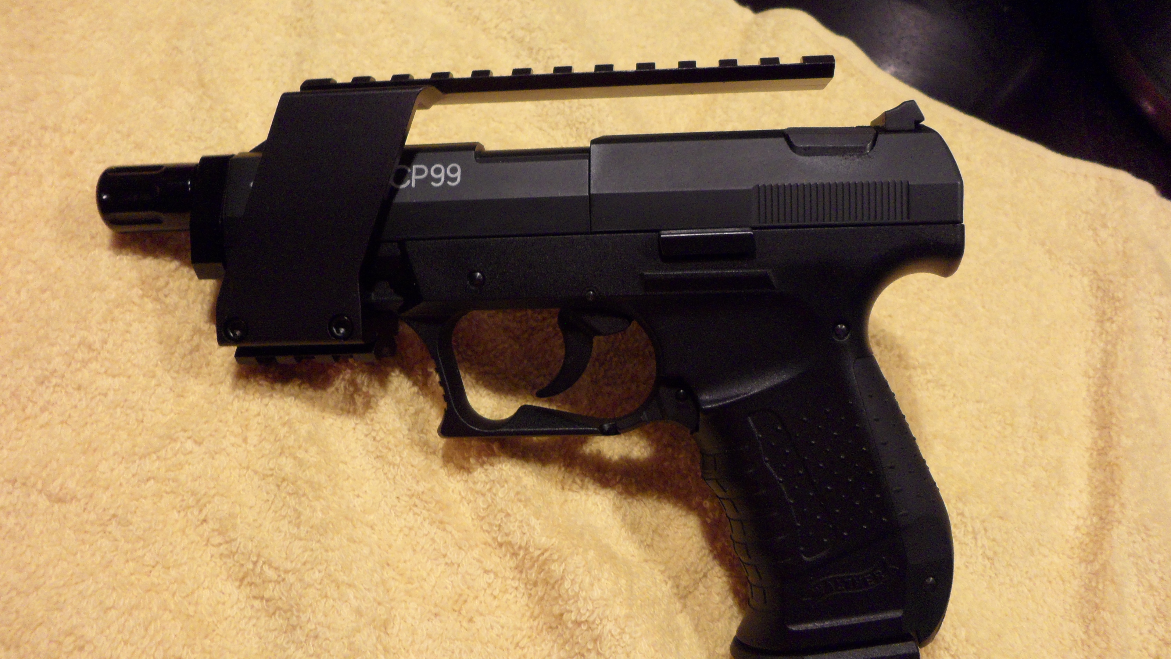

or you quit fight the cheap fixed sight and get one of these
https://www.ebay.com/itm/153215316323
then go to Ebay or Amazon and get one of these
now the reflex sights have 3 dozen different names on them but they all the same
https://www.amazon.com/Feyachi-Refl...ight+picatinny+rail+ohulu,aps,127&sr=1-6&th=1
or fight the sights
here is my Walther CP99 pellet with the mount on it is dead centered
just an idea nothing more
https://www.amazon.com/Feyachi-Reflex-Sight-Adjustable-Reticle/dp/B01HPWATOC/ref=sr_1_6?crid=3T6DW344C6VCI&keywords=reflex+sight+picatinny+rail+ohuhu&qid=1695354698&refinements=p_72:1248957011&rnid=1248955011&s=sporting-goods&sprefix=reflex+sight+picatinny+rail+ohulu,aps,127&sr=1-6&th=1
or fight the sights
That is an interesting mount I have never seen one like that. Hehe, I have 2 of those exact same reflex sights. Have to look on Amazon for the mount I don't do eBay, got scammed there to many times and eBay is of no help.
Found one on Amazon. https://www.amazon.com/360-Tactical...tinny+rail+under+to+over,aps,113&sr=8-79&th=1
