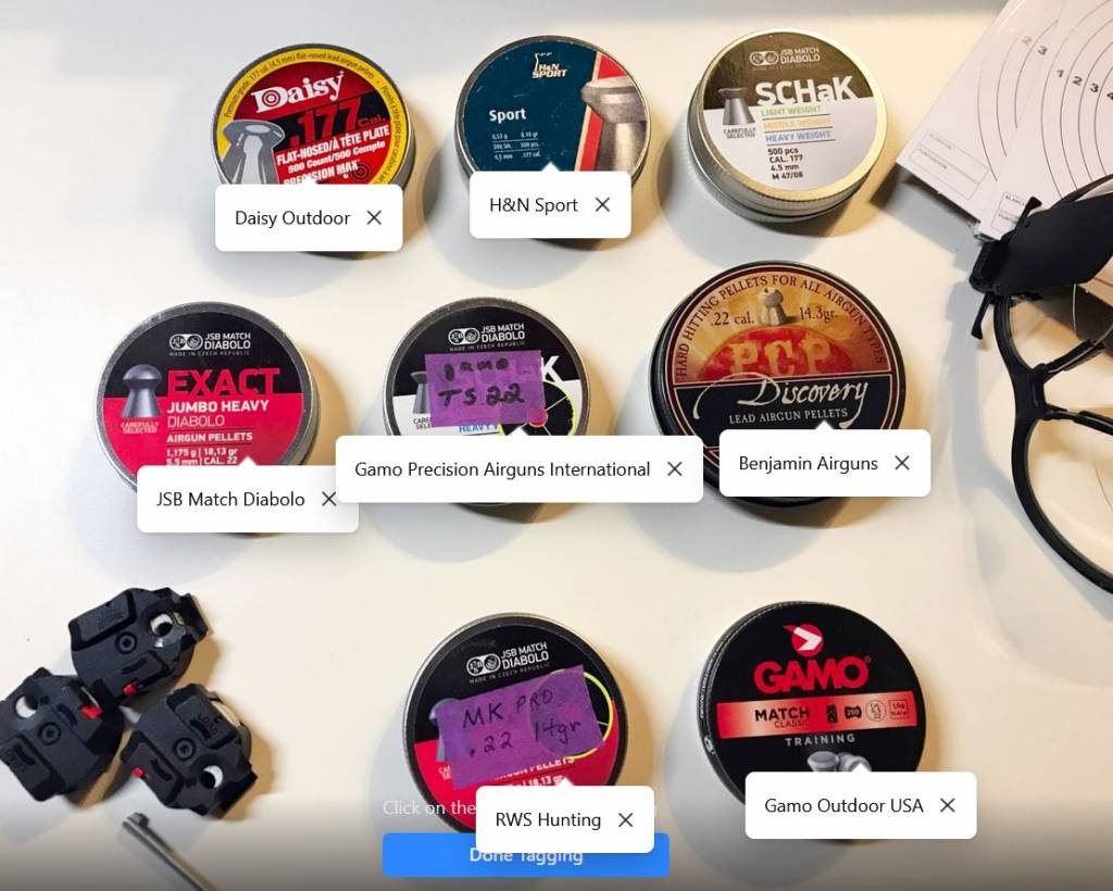

All this is just IMO... buuuuut..... :) At 20-yards, any pellet that isn't junk or defective will be about the same. Crosman and Daisy make great inexpensive pellets for #backyardplinking. JSB, RWS, and H&N for more consistency and quality of pellets.
I just bench-tested these recently, and all shot close enough to call the same. Sub-1" at 25-yards. In a break-barrel. (.177 and .22)
Now, if it were the Olympics, and going for 10.9s off-hand, 60 shots in a row, there-in lies the need to spend $40 for a hand-picked box of 100.
Otherwise, meh, pick up some Crosman or Daisy ammo. Wadcutters for shorter distances (10-yards or so) and clean holes, and round/hollow for better accuracy further out.

So what are those? Well find a good pellet. Spend the money on the ones that are most commonly used in field target. They are H&N FTT and the JSB line of round nosed pellets. If you can get them in specific head sizes, test out a tin of each size. You will find a pellet your rifle "likes". When you do, buy a sleeve of them.
