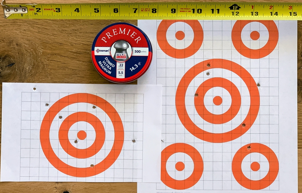

I've shot firearms competitively for decades. I just got my first air rifle, a Gamo Swarm Magnum (.22 NP), for dealing with varmints in my back yard.
After cleaning the barrel and sighting in (with the Gamo factory 3-9x40 scope) I shot the following two targets at 50 yards with Crossman Premier 14.3gr pellets. I shot from a rest in zero wind. (I understand that the scope is fixed focus at 25 yards, but I believe I am experienced enough at minimizing parallax error by concentrating on maintaining a consistent position in the eyebox.)
Is 5" extreme spread at 50 yards reasonable? I hope not, because that's not nearly enough precision for dispatching varmints. I assume the next step is to try different pellets? If so what should I try?
Your rifle does not like that pellet.
You should be able to get 3 MOA or better without too much testing. Reducing that to 1 MOA in a springer platform is decidedly non-trivial. Can certainly be done but it will take some experimentation and experience.

If your only choice in pellets are Crossman Primers. I suggest washing them with warm water and dish soap. Then sort by weight. But I really recommend just ordering some H&N field target trophy’s or something from JSB. Second I’d say replace the scope and get a bubble level for your scope. Lastly, start off shooting at 25 yards.

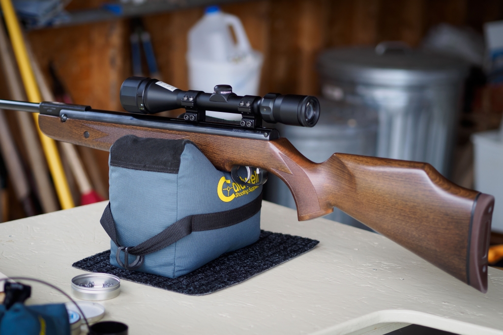

Hi there. Many springers do best when rested at or just in front of the balance point. If you are resting your rifle at the forearm tip as you might with a firearm, that could be one contributor to poor accuracy from the bench. Shooting as shown below, I get groups hovering around an inch at 50 yards, or roughly 2 MOA. This may not prove to be the best way to rest your rifle, but it is not a bad place to start. Then experiment with RH grip, cheek pressure and shoulder pressure until you can get the crosshairs to hang on the aim point through the shot. I put my thumb just to the right of center and use light cheek and shoulder pressure. Rear bag is optional. This approach should produce decent accuracy.
If not, then certainly try different pellets. Actually, you will want to try different pellets anyway. The JSB brand in several different weights is a good place to start.

A new springer in the hands of someone unfamiliar with shooting springers?yyeah 5" at 50 yards isn't surprising at all.

The Gamo scope is so bad I don't understand why they even bother. For $60 I got a Hammers 3-9x40AO airgun-rated scope in rings and a single-piece mount. That's less than I have ever spent on just the mount for a gun scope, but per Amazon ratings it does well on airguns when it's not DOA. Fit, finish, and function on the scope are really good for these short ranges.
I bought 18gr H&N Sniper Magnum and an assortment of Benjamin 14.3gr pellets. I moved the target up to 25 yards and put another 50 rounds through the gun with the new scope. The H&Ns are the best so far, mostly staying in a 2" diameter. Benjamins string vertically, and the Crossmans ... to avoid crying I'll just attribute their performance to me still settling into a natural shooting relationship with the rifle.

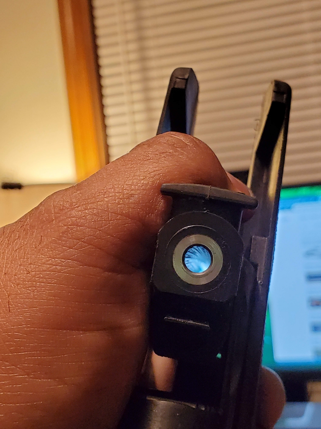

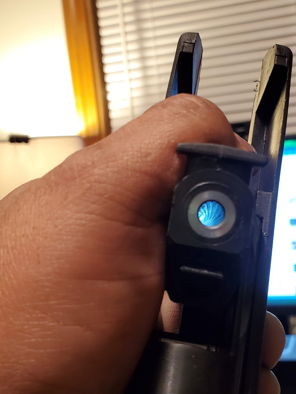

I've have gotten a significant increase of accuracy lately by taking a closer look at the barrel. ... BUT first off you really need to hone in on the discipline this magnum needs . Like everyone else says HOLD ,FOLLOW THROUGH AND Concentration play important roles . Compared to my other break barrels like WEIHRAUCH, RWS AND AA pro sport. This particular rifles can reward you with dime size accuracy. THOSE ARE still kinda hold sensitive but has as much compared to GAMO which interesting seems to make make everything out of plastic and once in a while throw a wooden stock. Having a little weight helps alot when looking for tight groups. Now . The barrel hmmmm now where do I begin . I took a look inside the barrel with a bore scope and I've noticed that barrel has alot of imperfections compared to an entry level Diana 34Pro compact. When I compared the two the Diana is Far more superior than the GAMO barrel. Diana barrel was extremely square and straight . No dips, Nics, or even gualing which I saw first off in my GAMO barrel. If GAMO would take the time to make a barrel as TRUE as let's say, a (Loather Walther) barrel ? And Add a wood stock for a little more weight . I really believe it would destroy most BOX retailer air guns out there today.
 You can see some of imperfections in the rifling but I've been taking time to polish the barrel and it seems that it's been making some improvements in accuracy. Still work in process. But I've been thinking of fitting it with a LOATHER WALTHER barrel and then add a pound in the stock to see if it will improve its accuracy.
looking at this angle about the 10 to 11 position you can see major gualing in the rifling. I think this is where most of our problems might be at. .
@r8lmpz – are those photos and that assessment made after attempts to give the barrel a thorough cleaning? The grooves do look like a mess in your photos, but the lands not so bad. (If it's lead galling from shooting that's not as big a deal as galled barrel steel from the rifling process!)
Before I put a pellet down the barrel after purchase I cleaned it with CLP and got a significant amount of brown-orange out (rust? oil? I don't know).
What are you using to polish the bore? Given your attention to detail I imagine you have JB Bore Paste or equivalent. Did you try a full treatment of that?
