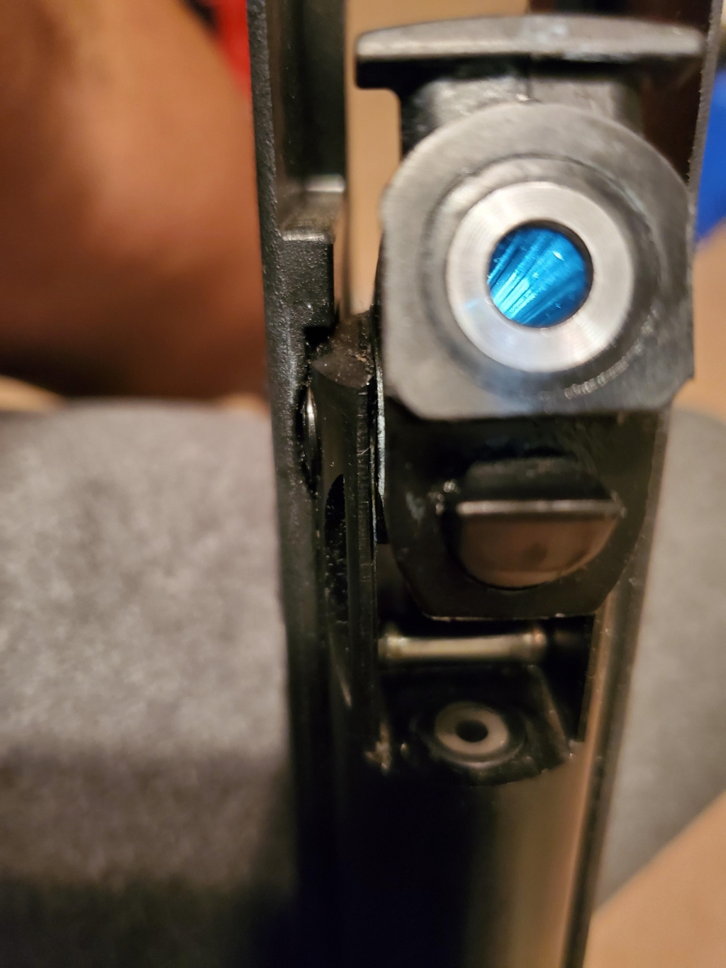

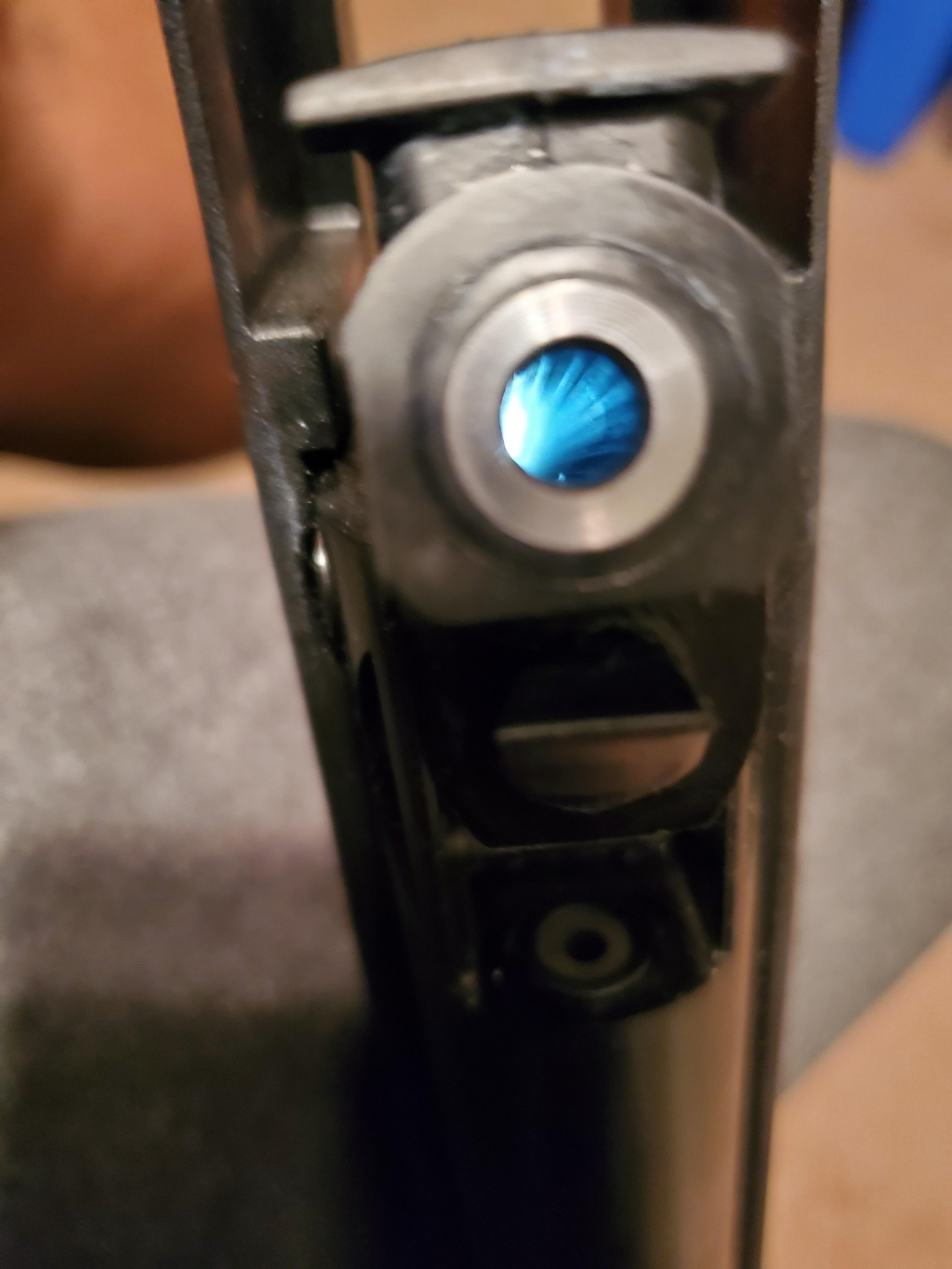

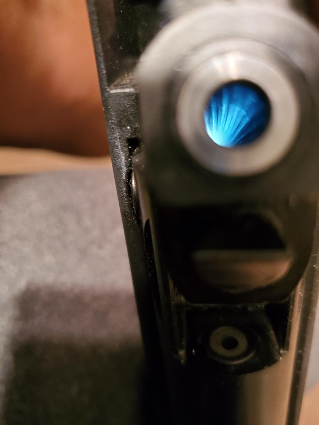

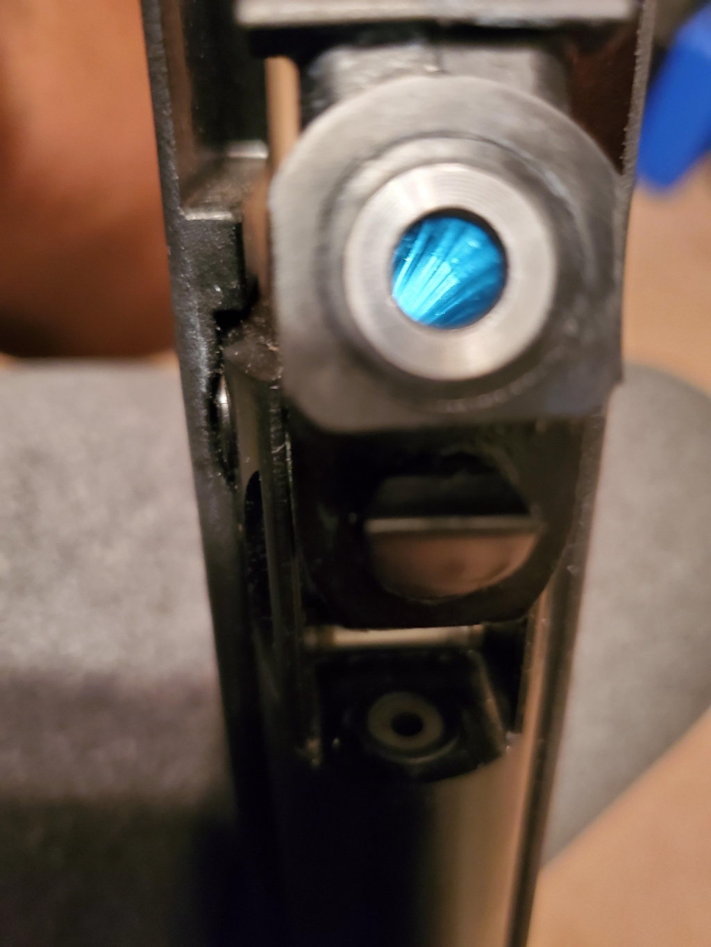

Yes even after good cleaning. I did use some JB. bore paste. However just little only cause I wasn't sure if these barrels are choked at the end so I kinda doing it by feel. Even the lands in a certain spot had a burr in it cause I felt it when I inserted a jag and sure enough it jammed about halfway in. So I'm pretty convinced that these a simply mass produced and like any cutting tool towards the end of its life begins to make dirt cuts which would look like I have and to include an almost wavy cut in the LAND portion of it. I mean I looked through my RWS barrel and everything was perfectly SQUARE . I DONT know their process but it seems kinda sloppy compared to some others.
So I managed to polish it up just a tad, and the photo dont do any justice. But the burrs are gone and the barrel finally showed it's nice flat lands and the channels are nice and clean. I finished it up with some FLTIZ polishing cream it ialmost gave a mirror finish but not quite, and what a difference. So soon I'll get to take out and see how it shoots. My Gamo Magnum Swarm will be at doorstep tomorrow.i can't wait to see what the condition of the barrel will be like. Hopefully it don't need nothing.
So i got the Swarm Magnum Today. And actually the barrel looked really good. So I think I was right about mine. Like some people say when their Swarm Maxim some shoot good and some shoot terrible. I really think it's just the barrel. Some come out good and some just stink. I believe their QUALITY CONTROL IS getting too laxed for the sake of profit in my opinion. But the Magnum I got today was a refurbished one . It was new to say the least. But the rifling in that barrel was actually pretty clean . I'm not gonna polish that one until I take out and shoot off a few rounds. I'm kinda tinkering with a new toy like a .17 WSM ? Damn that thing is fast hahaha.
