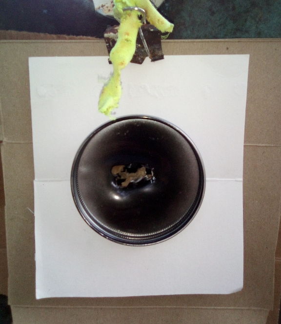

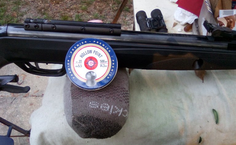

My 6year old well used and abused gamo with cphp.22 ( the warranty send in gun )
On stock irons and 50 yards .. can't complain..
