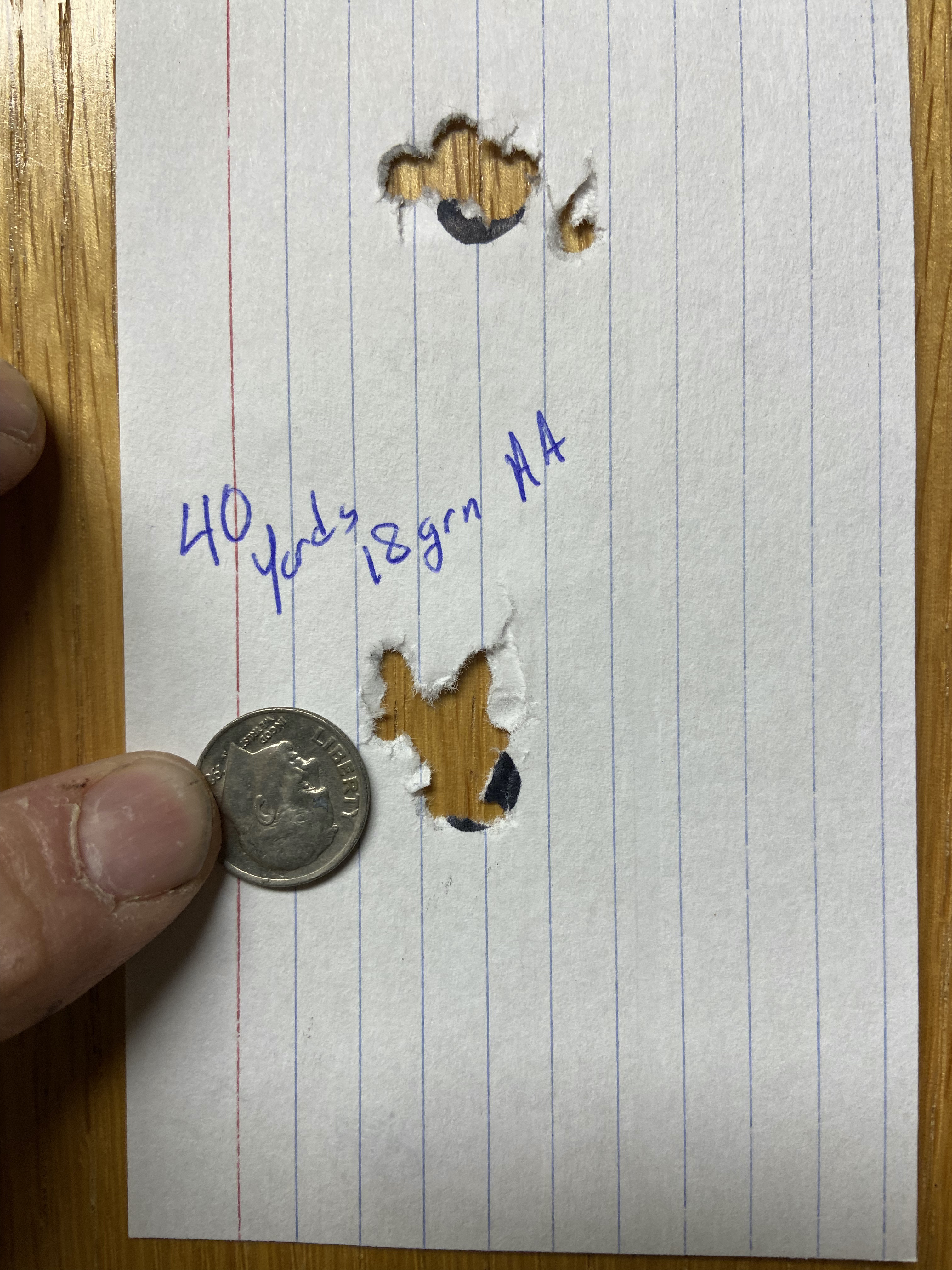

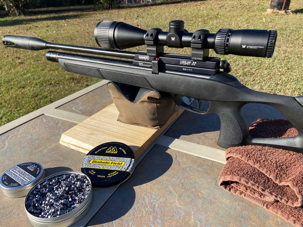

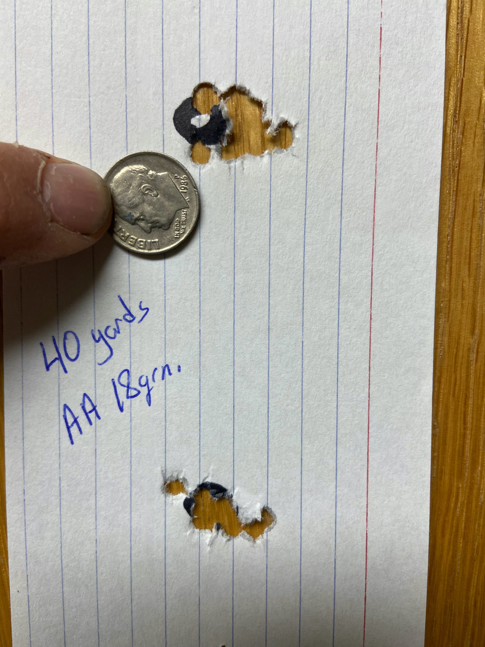

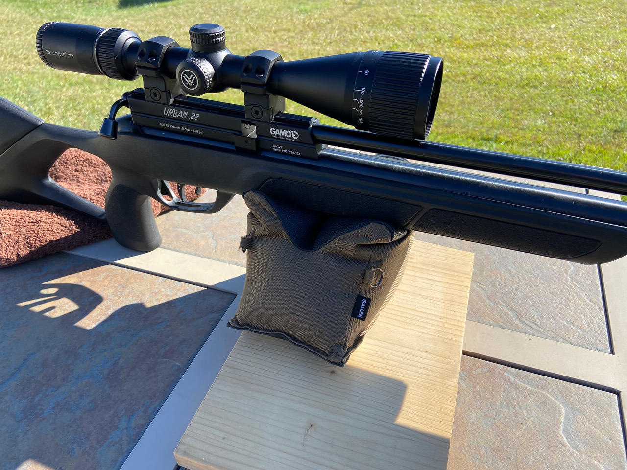

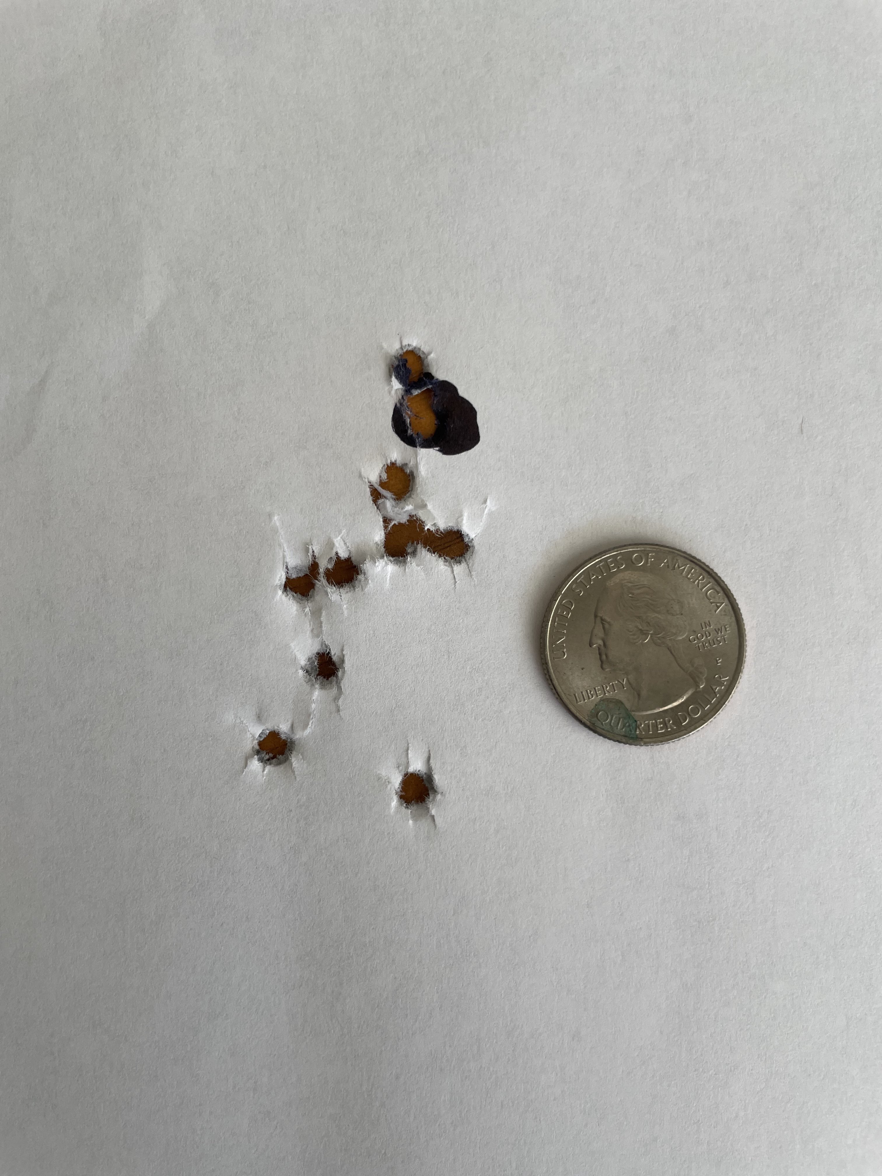

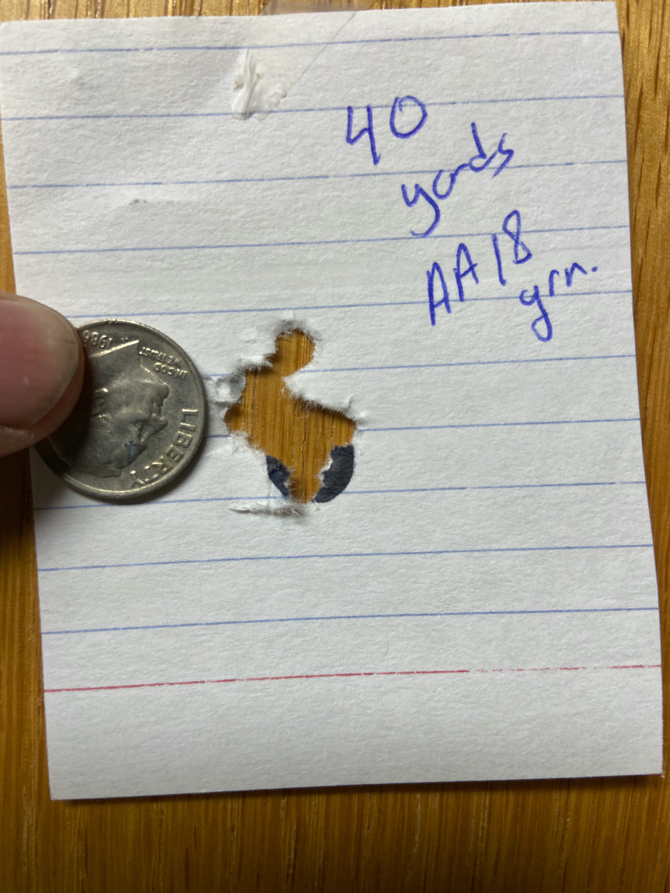

About two weeks ago I picked a new Urban .22 out of pure curiosity. I have heard so many people speak of how accurate and well made these Urban's are and that many wish they had never gotten rid of theirs. So....I decided to see for myself. At a $300 price tag, what the hell? It's really just a BSA Buccaneer (It is definitely a BSA, I think it's pretty much a Buccaneer) and is made in Birmingham England. Not China. But everyone knows that. But anyway, I have spent three days over two weeks shooting this Urban. I was very impressed by it from the first magazine full of pellets. It took a few adjustments to get it "dialed" in . I ended up removing the barrel band, which did alleviate some poi shift that I was experiencing. I replaced the 2nd stage trigger adjustment screw with a new one that was just a bit longer. This got the trigger pull lightened up to my liking. It is actually a pretty good trigger after some adjustment. Today I adjusted the hammer spring just a bit to increase power slightly. The end result....a really sweet shooting and very accurate little rifle. The urban has an excellent stock, is light weight, and can shoot lights out!! What a gem of a pcp for only $300.
Below are ten shot groups.
I am not finished with this Urban. I have a lot more that I want to tinker with and am looking forward to hunting with it. The above pictures are with Air Arms 18 grain pellets. Very good accuracy with them. It also shoots AA 16 gr and Crossman 14.3 gr Hollow Points pretty well. The Crossmans would have 2-3 fliers in a 10 shot group however. I didn't like that. Still a lot of testing and tinkering to go.

Look, the Urban is what it is. For $300, and can be purchased new for less than that even, it's really a good little rifle. Not everyone can or is willing to spend a lot of money on a pcp. I understand that. That is why so many people are on here looking for information on a descent quality and accurate air rifle that just may be in their budget. I know it gets frustrating for many of them because they can't afford a Daystate or a FX. There are other options and the Urban is just one of them.
As far as the grouping that this Urban is capable of. Well, it can actually group a bit better than what I showed in my post. That was just one day of trying different pellets and what not. Quite honestly, most people can't really shoot to their rifles capability anyway. Often the shooter is the weak link.
And as far as that being a good 100 yd group, not 40? This rifle isn't the rifle you NEED to be using at 100 yards. And most that would be interested in the Urban have NO intentions of using it at that range. It serves VERY well as an out to 40-50 yard max back yard or small game rifle. I am enjoying it as that and have no issues with it delivering.
