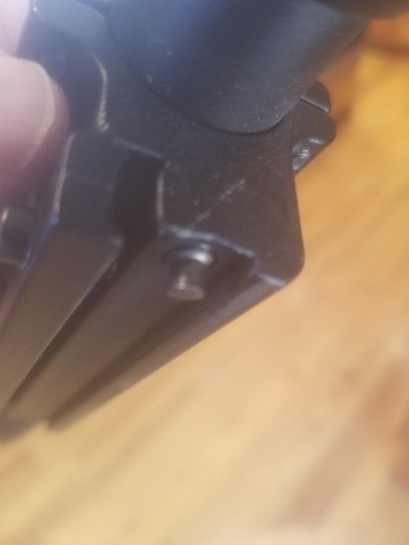

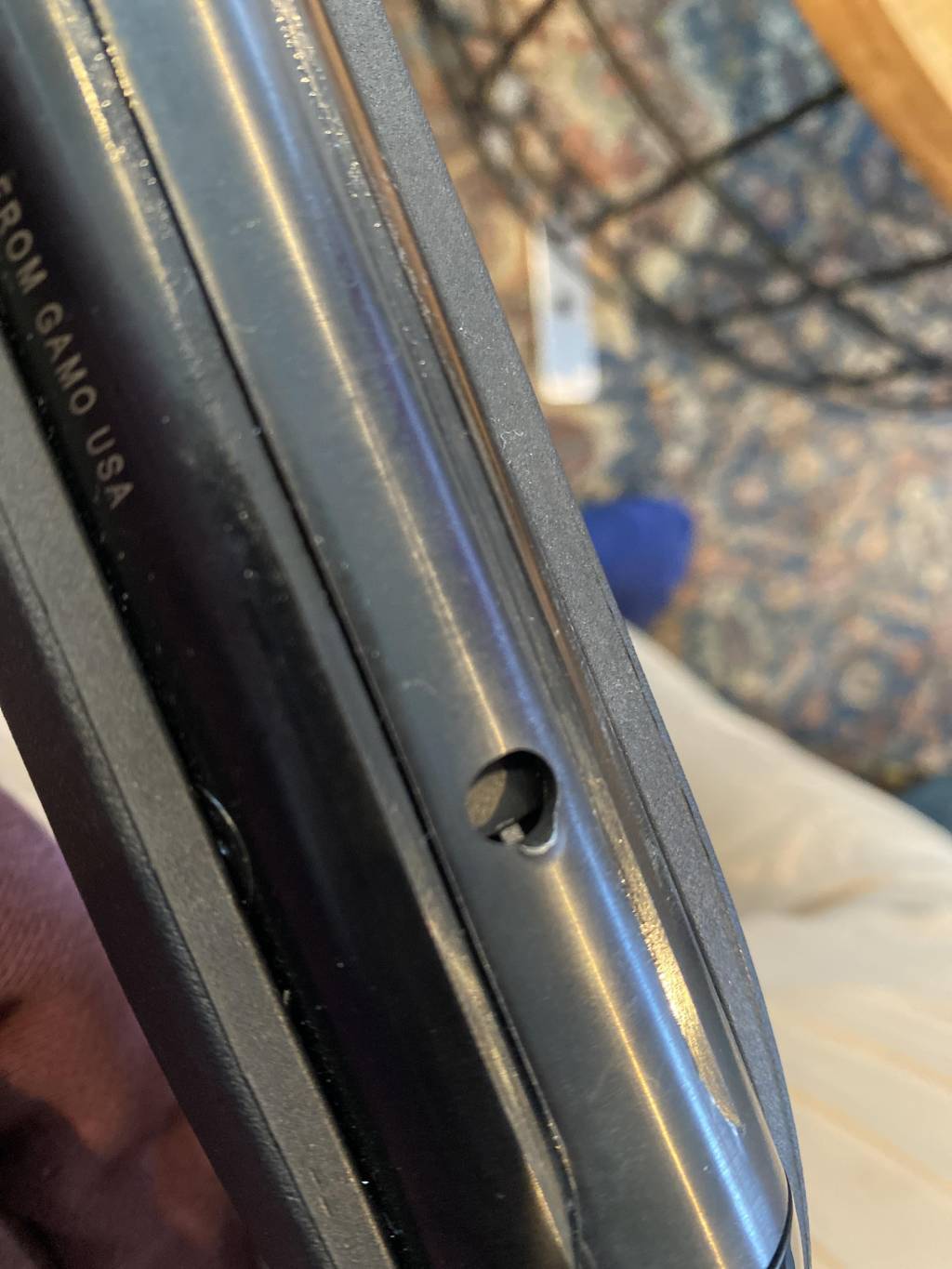

It didn't shoot much better so I decided to swap scopes. Upon removing the scope that came with it I noticed that the riser block that mounts to the rifle's dovetail had damage to it in the hole where the stud on the scope mount sits.

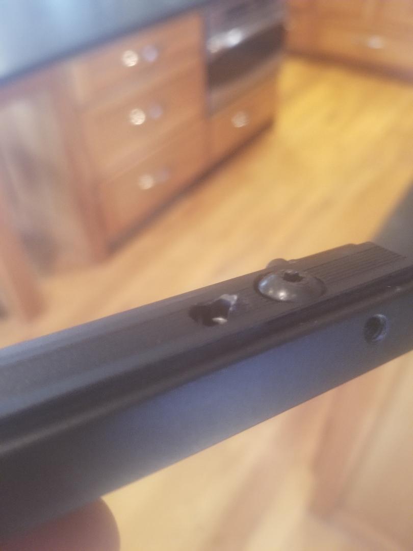

I also noticed that the steel stud on the underside of the scope mount also had damage. It is hard to tell from this picture but it is bent.

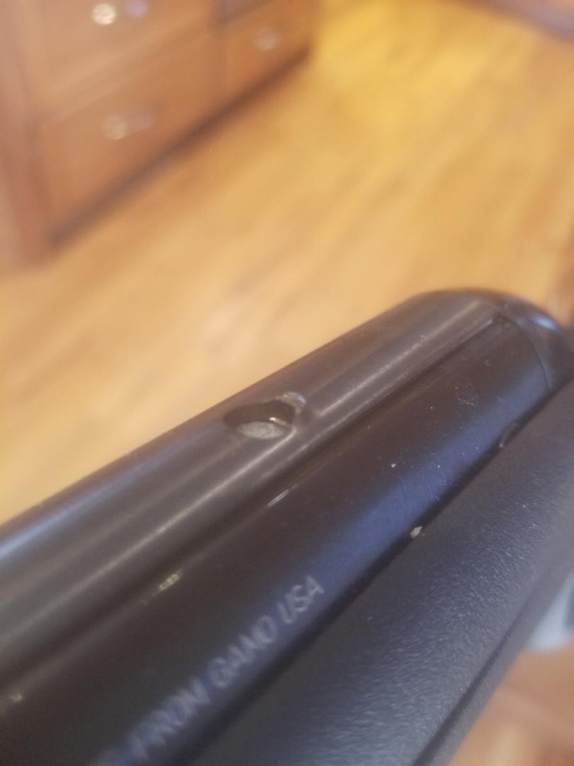

And of course the hole where the riser block screws into the rifle's dovetail is also damaged.
Is this normal for these guns? I believe my cousin bought it as a floor model at a local Cabelas so the only thing I ever did with the scope was slide it back in the mount for better eye relief. Is it possible the riser and scope wasn't mounted correctly originally? I don't see how that could be it since the riser block screws to the rifle and the scope mount indexes with the riser via a solid stud. The screws that tension the riser on the rifle's dovetail seemed very tight to me, as were the screws on the mount.

it has happen many times before on other rifles, should it happen no
heavy recoiling guns play havoc on scopes and mounts and your is a good example of that
if there is move put a ring stop behind the mount or cut a ring down and use that as a stop
but you have damage and that will make the new mount harder to stop
what the real problem is the stop pin is too small for the hole, if it were a tight fit it would have more support
in any case good luck with your repair and if it were mine i would find a stop pin the same size as the hole and replace it in the mount
you need to find a dog point set screw
https://www.google.com/search?ei=jIVqXoSuEa-q0PEPiYWxqA0&q=dog+point+set+screw&oq=dog+point+set+screw&gs_l=psy-ab.1.0.0j0i7i30j0j0i7i30l2j0l2j0i7i30j0i30l2.9987.10834..12491...0.2..0.76.312.5......0....1..gws-wiz.......0i71.z7Mq5Ka8MoY
everyone one should replace the stop screw if it is too small for the hole for better holding

That's a hard recoiling gun to do that much damage. Gamos tend to be light for the power they make which adds to the harshness of the shot cycle. Sounds like that gun could be a scope killer so try the open sights to see if it will group before risking a good scope.
You should be able to mount your rings or 1 piece mount directly to the gun. Most springers have the scope grooves cut into the round compression tube. If you go forward with scoping that gun, degrease the scope grooves and try to find a mount or adapter that has a stop pin and at least four mounting bolts. Run the stop pin into the hole in the gun and slide it back till it hits the back edge of the stop hole. Then snug the bolts and run the pin all the way down. You can get dovetail to picatinny adapters with offset if you need to.
