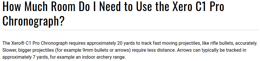

The Xero uses a 24GHz RADAR signal, using the Doppler effect, to bounce signals off the projectile as it flies. The reflected signal will be at a slightly different frequency than what was transmitted. In addition, the reflected frequency is altered by whether the projectile is moving towards or away from the Xero. These frequency shifts of the reflections yield the velocity. Lighting and sound (another medium where the Doppler effect takes place) have no effect on the system.
From https://support.garmin.com/en-US/?faq=lUHEZtJsvn0WleviVnMnT7&productID=771164&tab=topics :
