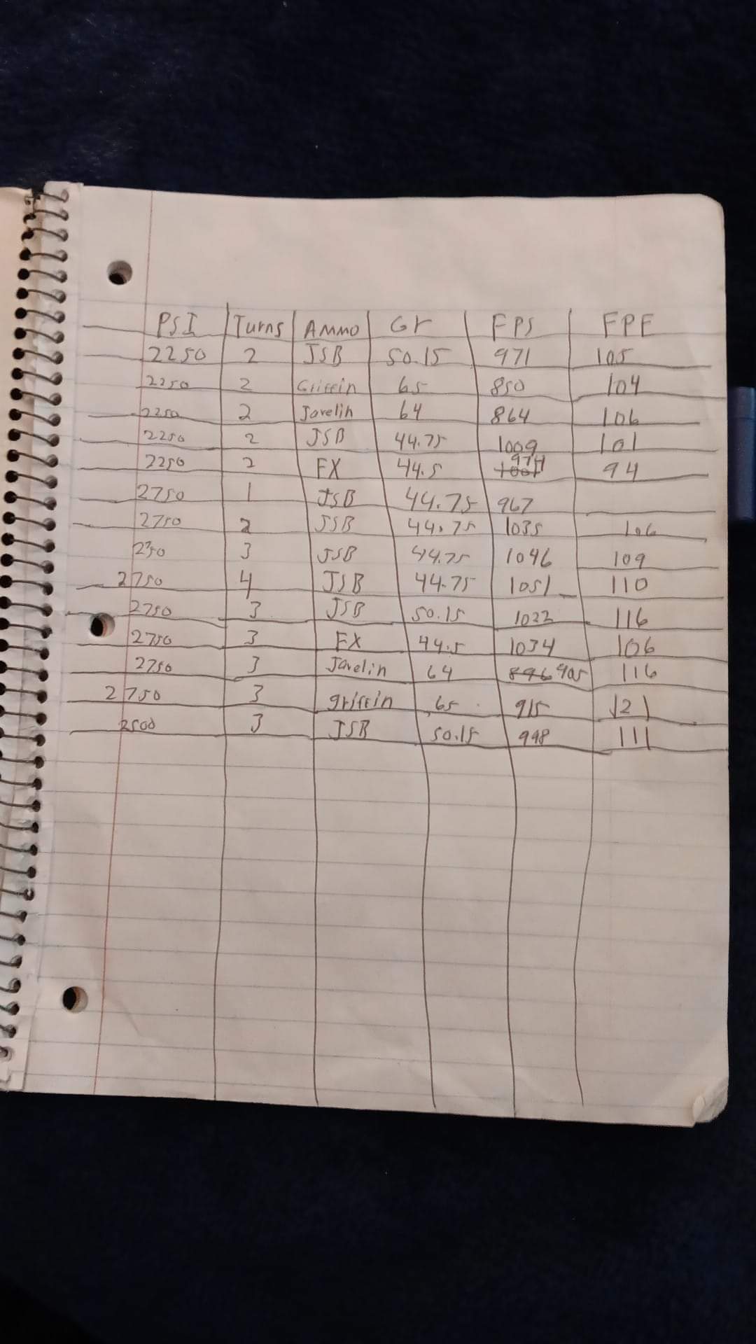

That's interesting, this means I should have a lot of hammer adjustment to tweak on my .30 it's currently shooting 44gr Hybrids at 1010fps woth the reg at 2800psi
At stock I was shooting the jsb 44.75 at 1077 and the fx I think were 1069 maybe. That being said one of the shots read 483 and then I only shot 2 mags before having to refill. You have to adjust your hammer spring with the reg.
Nice, I'll adjust and update to see how fast I can get the 72gr Griffins and the 50gr Varmint Knockers.
