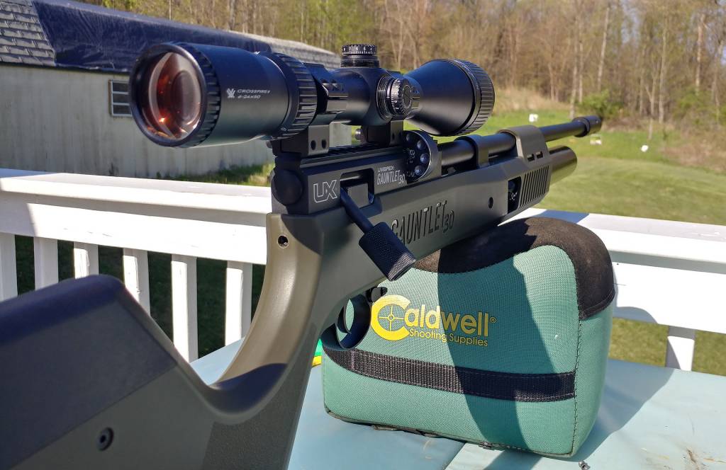

Thanks to kaylaindy here in the classifieds, I got my hands on an early release Umarex Guantlet 2 .30 caliber.
Came in the mail today. Mounted a Vortex Crossfire II 6-24x scope and it was a 2 shot sight in at 50 yards.
Also put on a DonnyFL "FX" moderator, which is the only one I have in 30 caliber. Stole it off my AEA HP SS 30+ which I suppose can go unmoderated now, in light of the new acquisition. I did not shoot the gun without a moderator on it, so I can't (yet) tell you how much louder it would be. However, it's still got a bit of volume to it even with the LDC. Backyard friendly? In my back yard, "quiet" enough. In yours -- depends on your neighbors. They'll know you're shooting some kind of gun for sure. Maybe a Sumo or bigger moderator would quiet it down, but even the sound of the pellet/slug and impact is noticeable with this.
I put maybe 100 rounds through it this afternoon. So these are early impressions, and I plan to update this thread as I spend more time with it and experiment further.
First impressions-- so it's a bit darker and greener than my .25 caliber Guantlet 2. I loved that gun so much I was certain I wouldn't be disappointed with the G2 30. So far so good. The only noticeable differences besides that are:

So I started with the 44.75 grain FX pellets. I did not bother to take out the crony today, but I will soon. The trigger is the same as the Guantlet 2 .25 so I was hitting bullseye at 50 yards with ease. Pulled a few shots but the gun clearly shot exactly where it was pointed.
