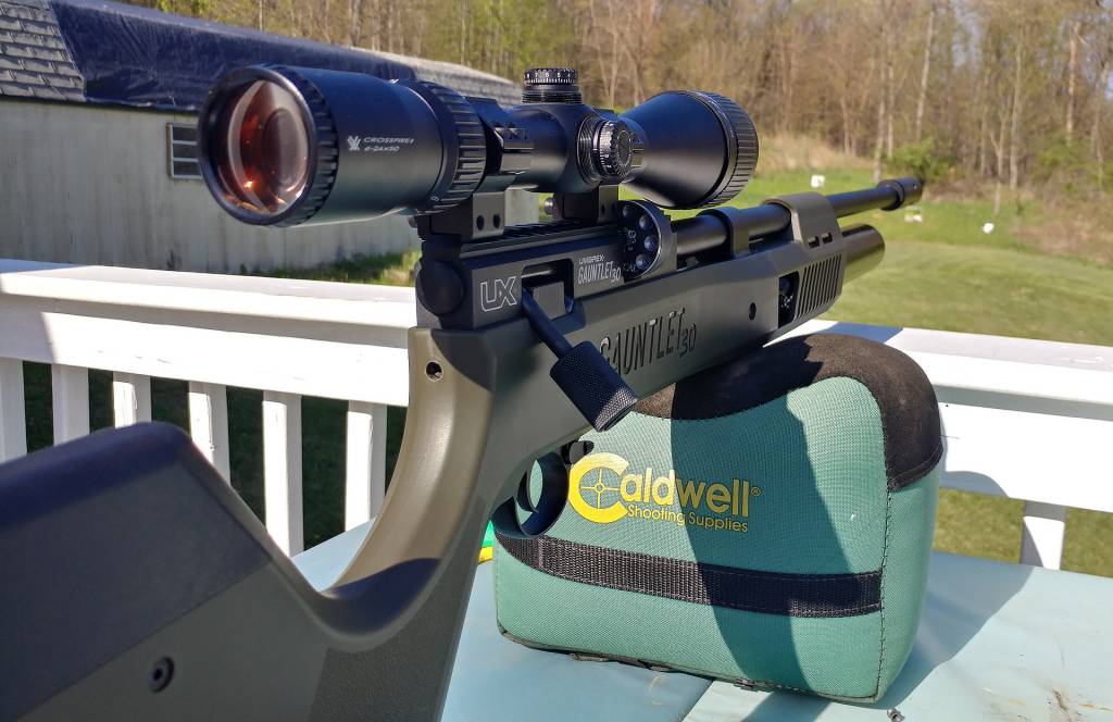

Came in the mail today. Mounted a Vortex Crossfire II 6-24x scope and it was a 2 shot sight in at 50 yards.
Also put on a DonnyFL "FX" moderator, which is the only one I have in 30 caliber. Stole it off my AEA HP SS 30+ which I suppose can go unmoderated now, in light of the new acquisition. I did not shoot the gun without a moderator on it, so I can't (yet) tell you how much louder it would be. However, it's still got a bit of volume to it even with the LDC. Backyard friendly? In my back yard, "quiet" enough. In yours -- depends on your neighbors. They'll know you're shooting some kind of gun for sure. Maybe a Sumo or bigger moderator would quiet it down, but even the sound of the pellet/slug and impact is noticeable with this.
