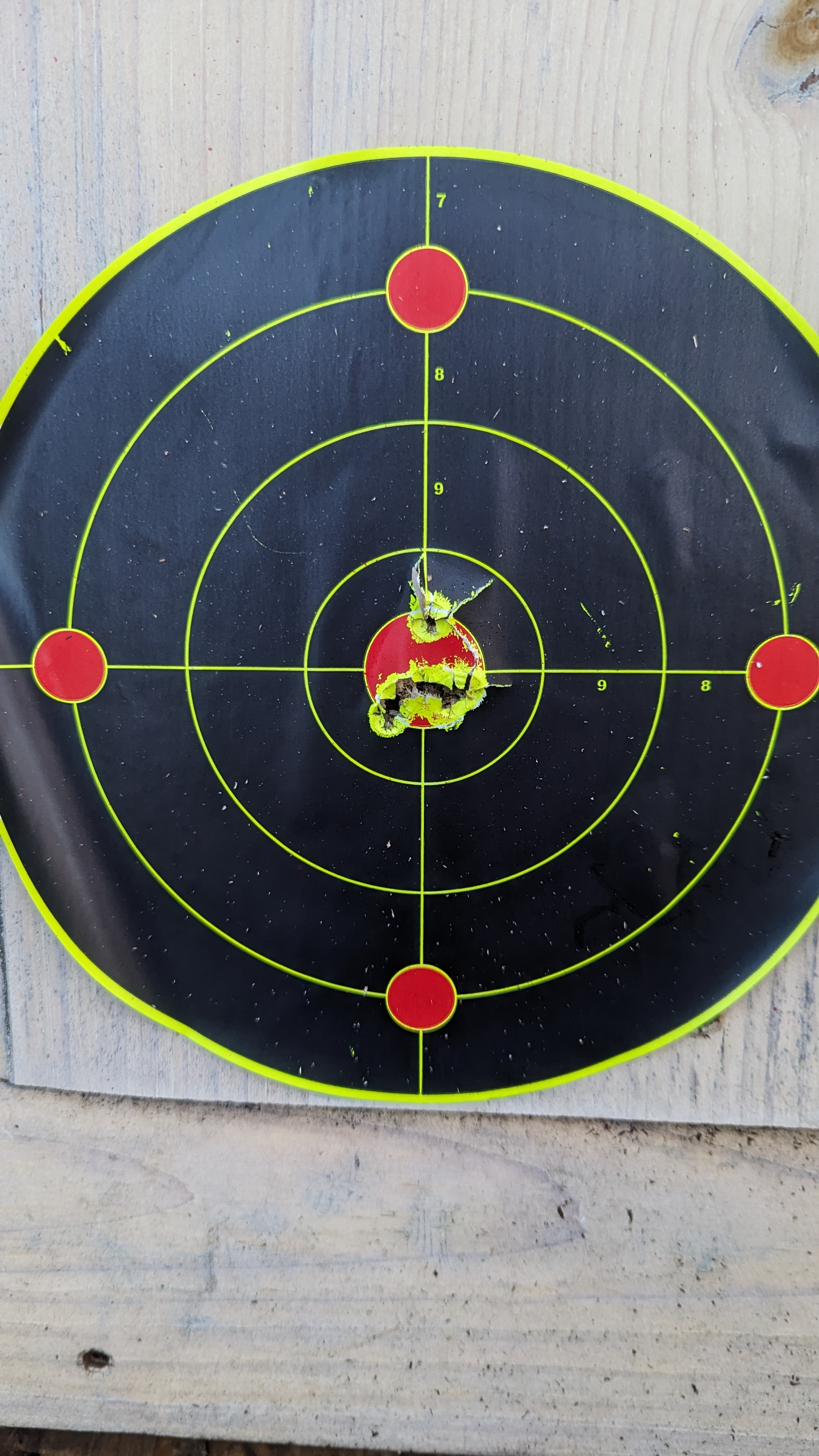

I have the Cuda Max 30, it is gorgeous and after two tins through it I haven't had one problem. I think it's one of the newer ones because i took the stock off and it has the venting ports that I've heard people doing to their stocks. I got it from New England Air guns and now there out of them they still have the .22 and .25's in-stock but not the .30 I would probably be leery of getting it from the Pyramyd because it might be one of the old ones before they fixed em. I'd wait and see or call New England and see if and when there gonna get more in. I've only taken it out to 50yds but that's all i need where I'm at. I've only used the JTS dead centers but if it warms up anytime soon i have the FX hybrid 44.5 grain slugs to see what it will do and I have many JSB 44.75 DiabOlo's that I have for another unit, just haven't tried them yet. The pic attached is me at 50yds on a 25 degree day shivering and the high one is me hurrying,,,lol that's an eight inch target. I think the cold opened up my groups more than the Cuda. It's not the best group but I think that was me. I fill it to 3500+ but not by much and I get two mags (14) before it's 100 psi above the reg. I have a 3Liter bottle filled to 4500 and I can get four fills so it works great. I don't know how heavy the Umarex is but this guy is pretty heavy. Beautiful gun though and mine has been flawless so far. CudaMax30@50.jpg

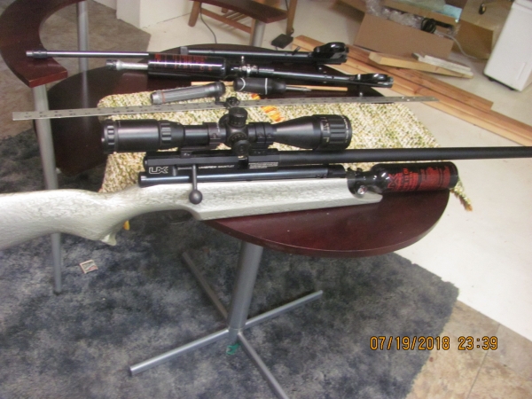

Have only seen gen1 gauntlet's (so no .30 at all) but if outside measurements have not changed a gauntlet will fit any QB stock with slight work. Need to make a bit of clearance for the bottle, likely need to change the stock bolt or add washers. That;s it.
Some must know if the .30 gen 2's are the same as the gen 1 or not. I would like to know.
Gen 1 gauntlet in a modeed QB78 stock:
You could use any QB stock and it does make a large difference in weight yet somehow the balance is great, I thought it might be front heavy but it is not.
