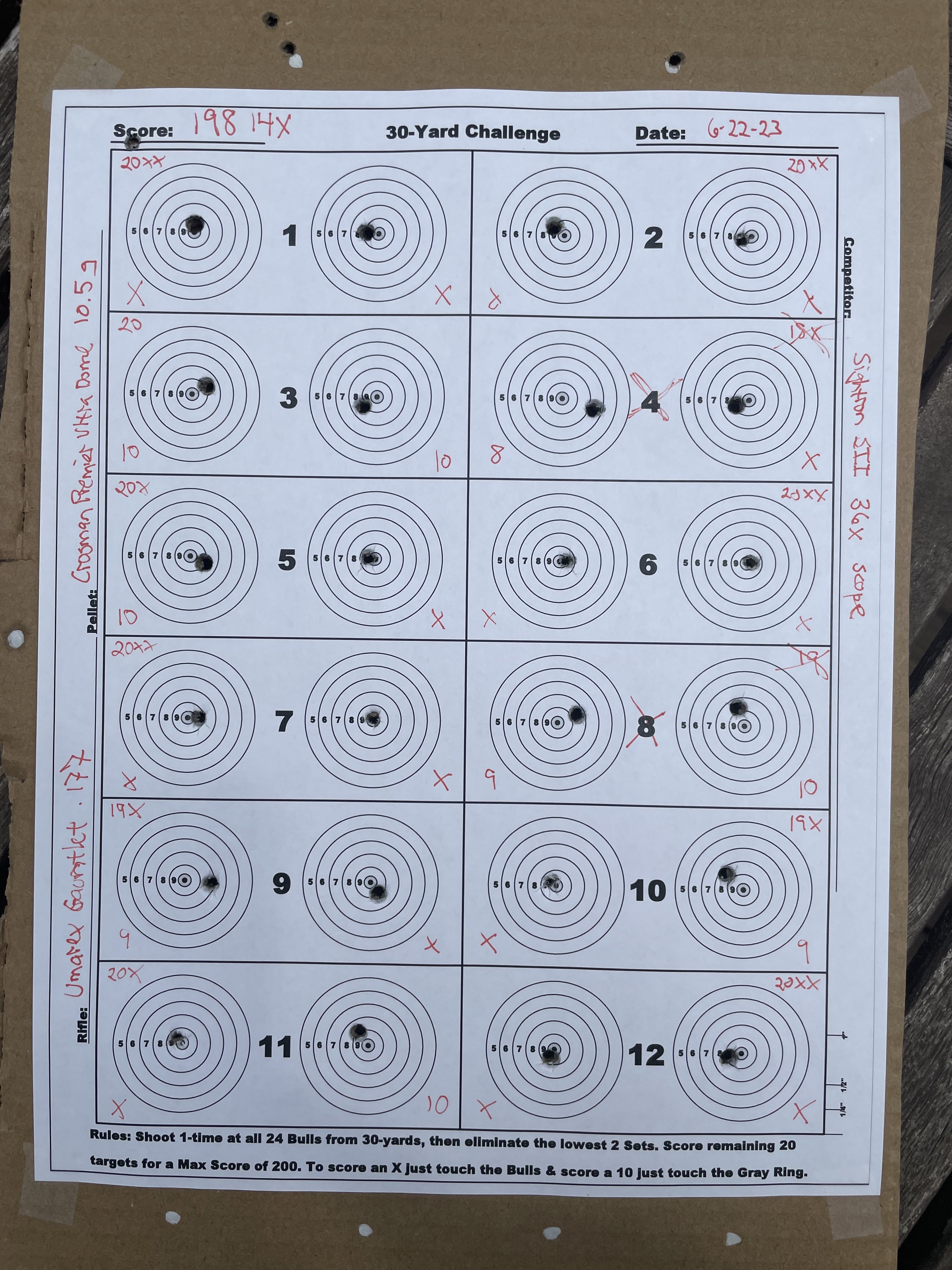

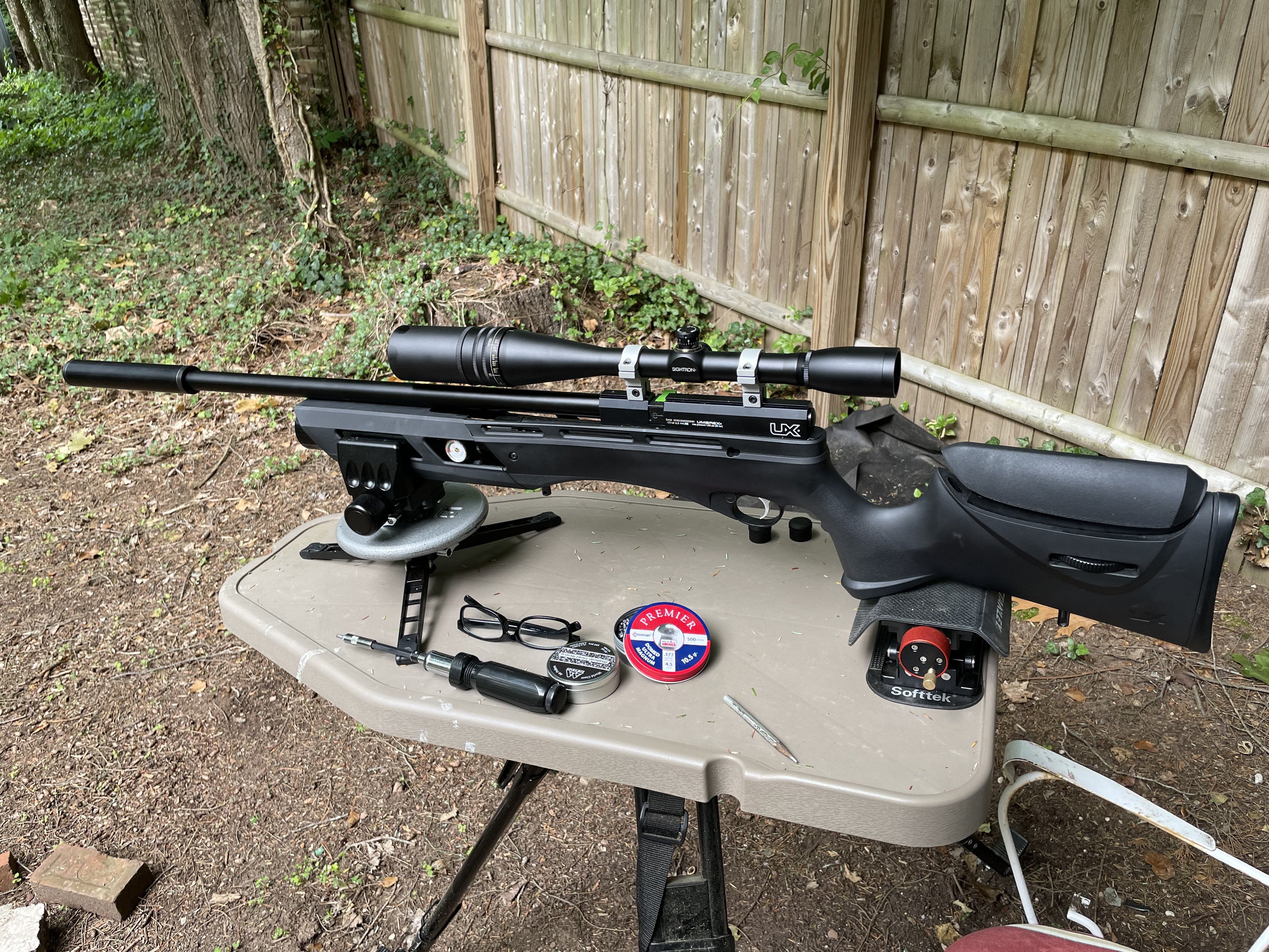

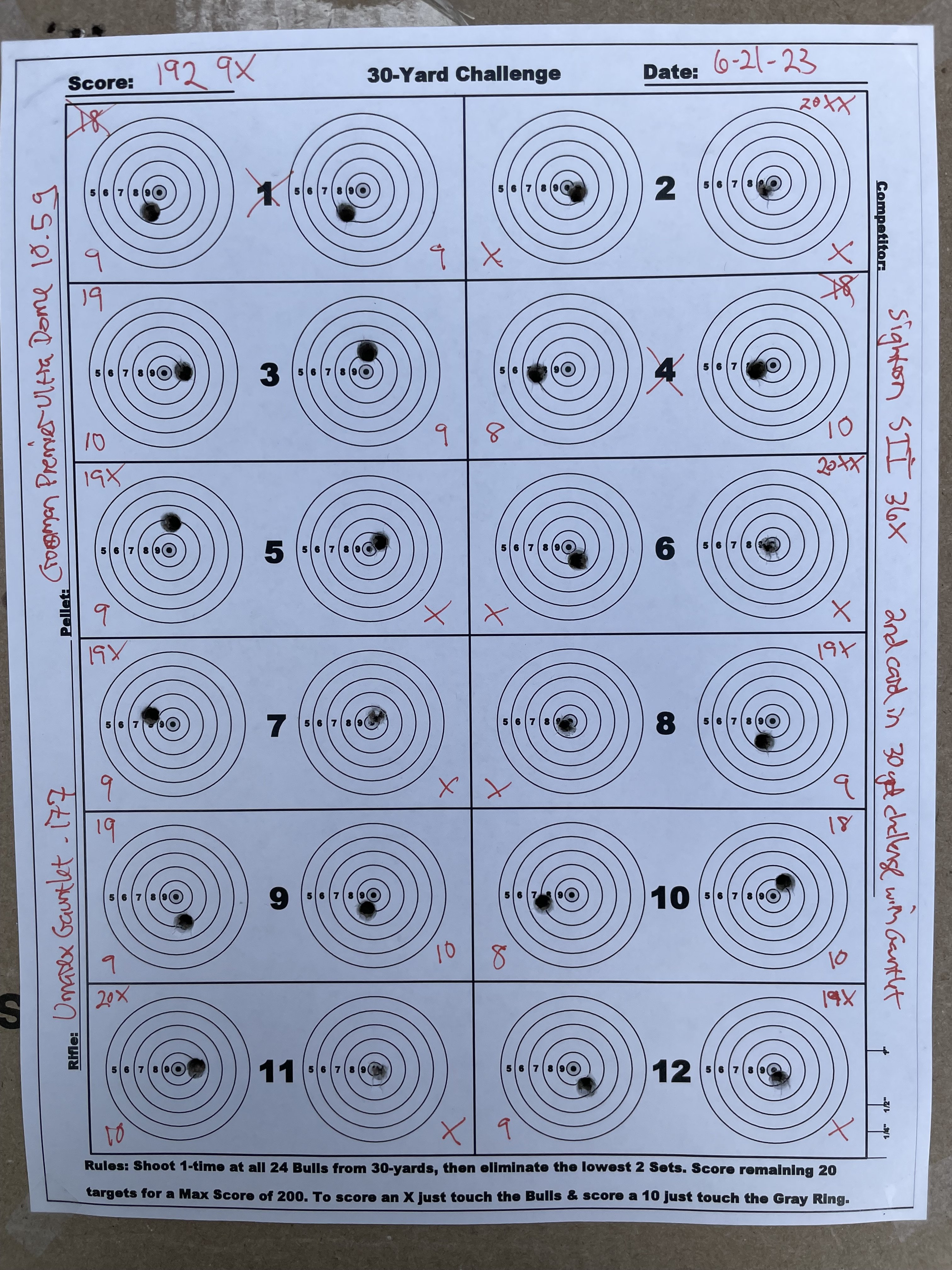

Yesterday I broke out my 1st air rifle, a Gen 1 Umarex Gauntlet .177 . I had not shot it in about 8 months (always holds air, lol). I put a newly acquired Sightron SII 36x target scope on and she immediately shot some lights out groups with Crosman 10.5 Premier Ultra Domes. So I shot two 30-yard Challenge cards and shot 191 9X and 192 9X. First gun I’ve tried that could break 190 with Crosman pellets. She has always shot the Crosman 10.5s well.
Today, I shot 198, 196 and 197 with the Gauntlet shooting the CPUD 10.5s. Straight from the tin as always. Incredible!! Conditions were great for shooting.

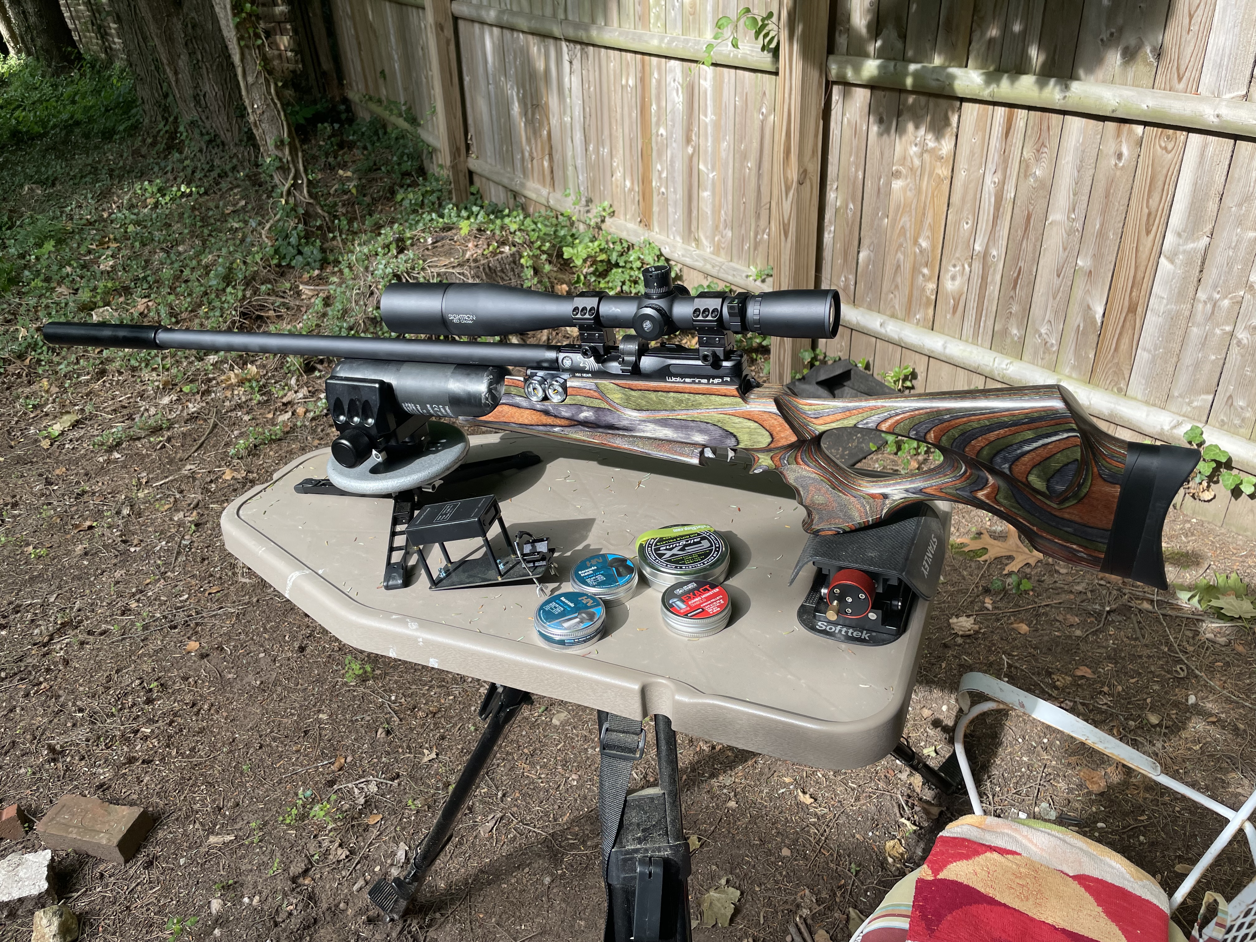

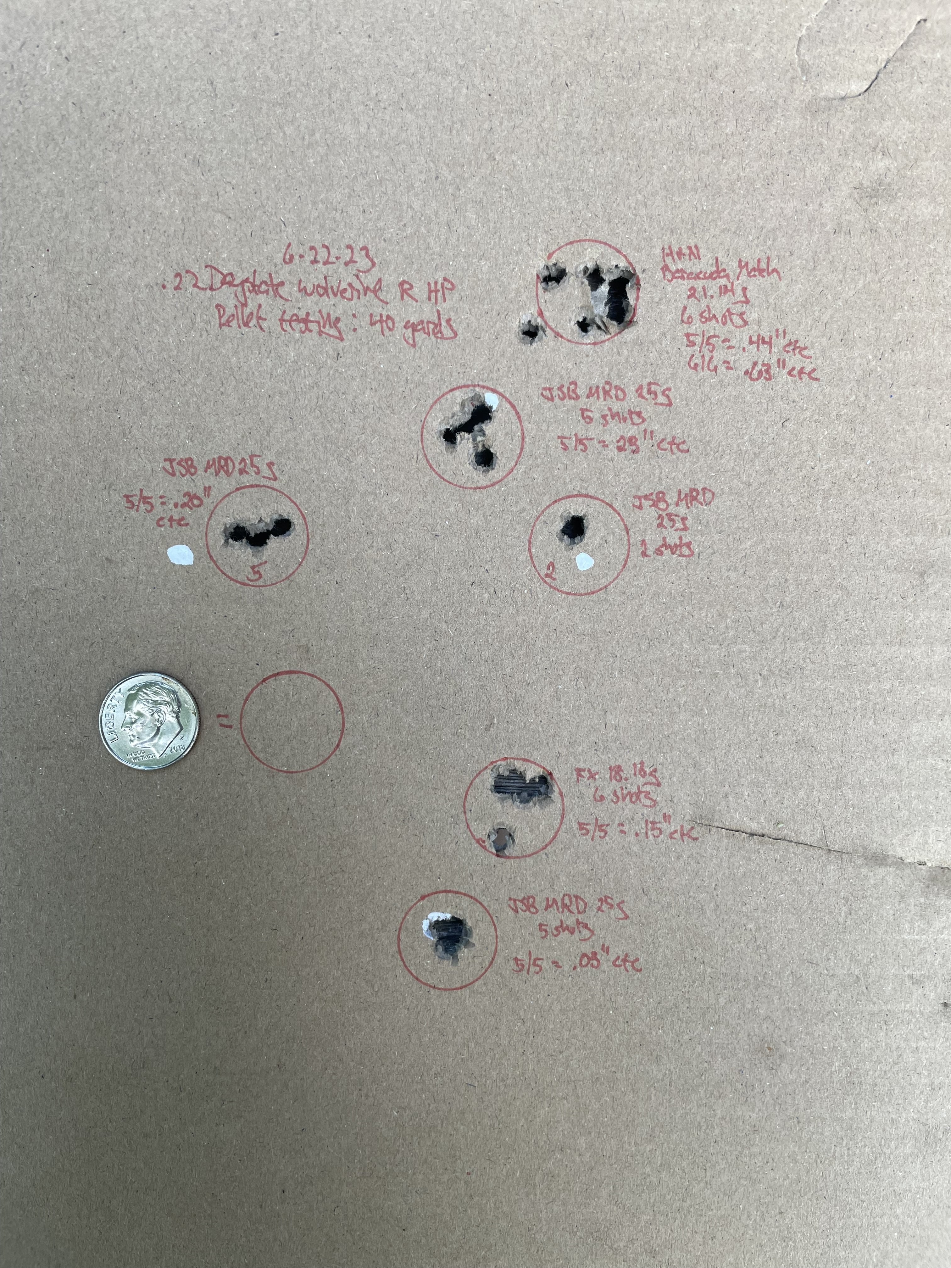

For a changeup I grabbed my Daystate Wolverine R HP .22 (bought used on AGN classifieds) did some pellet testing at 40 yards (it loves JSB MRDs) and thought, wonder if it could beat the Gauntlet, lol. I typically only use the Wolverine at 75 to 100 yards.
The Gauntlet was 198 14X and the Wolverine 198 13X… but I ran out of gas on the last Wolverine target - eyes were getting tired.

The Wolverine was using a Sightron SIII ED 36x. Not a significant difference noticeable at 30 yards vs. the SII - the SII is an awesome bargain.
