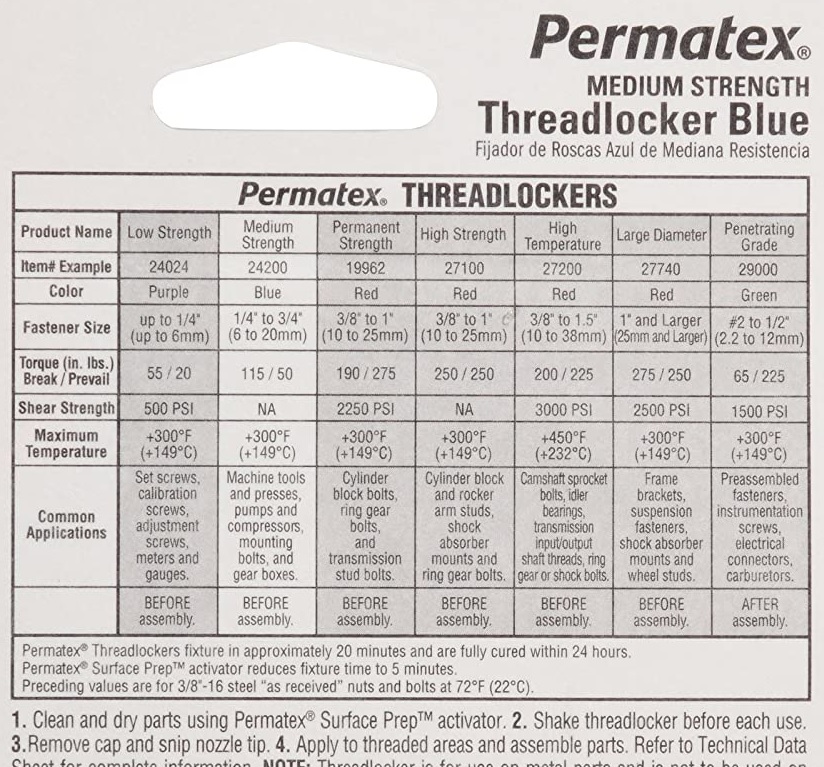

I tried the Permatex and I don't like it, kosher, doesn't dry on air not even overnight, Loctite is much better but cost more as well.

I read a few online articles on Permatex vs Loctite and they say the products are very similar. Loctite owned Permatex in the past. I took a couple of snips from the products on Amazon and the Permatex is rated a little higher on strength than the Loctite. This isn't something I'll get wound up over and will continue using what I have.
