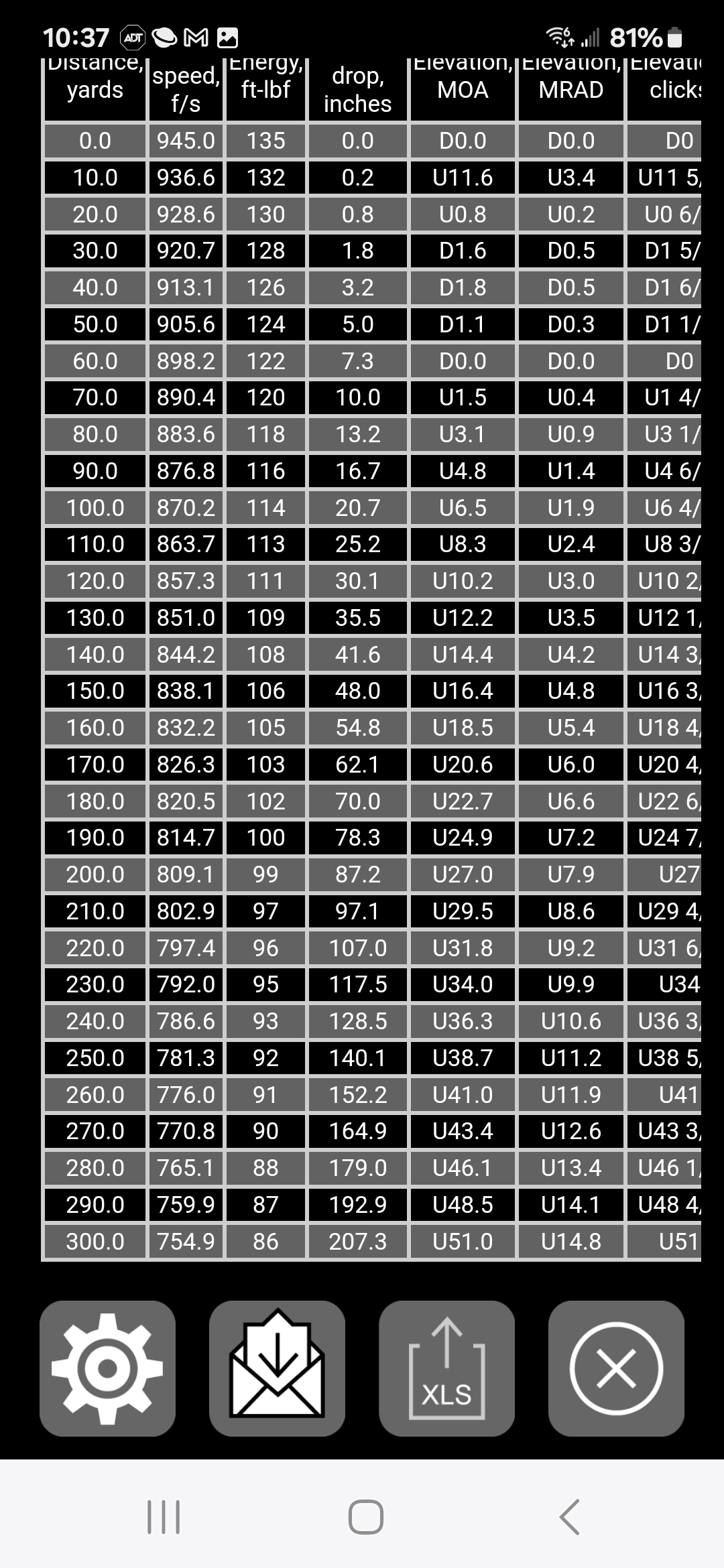

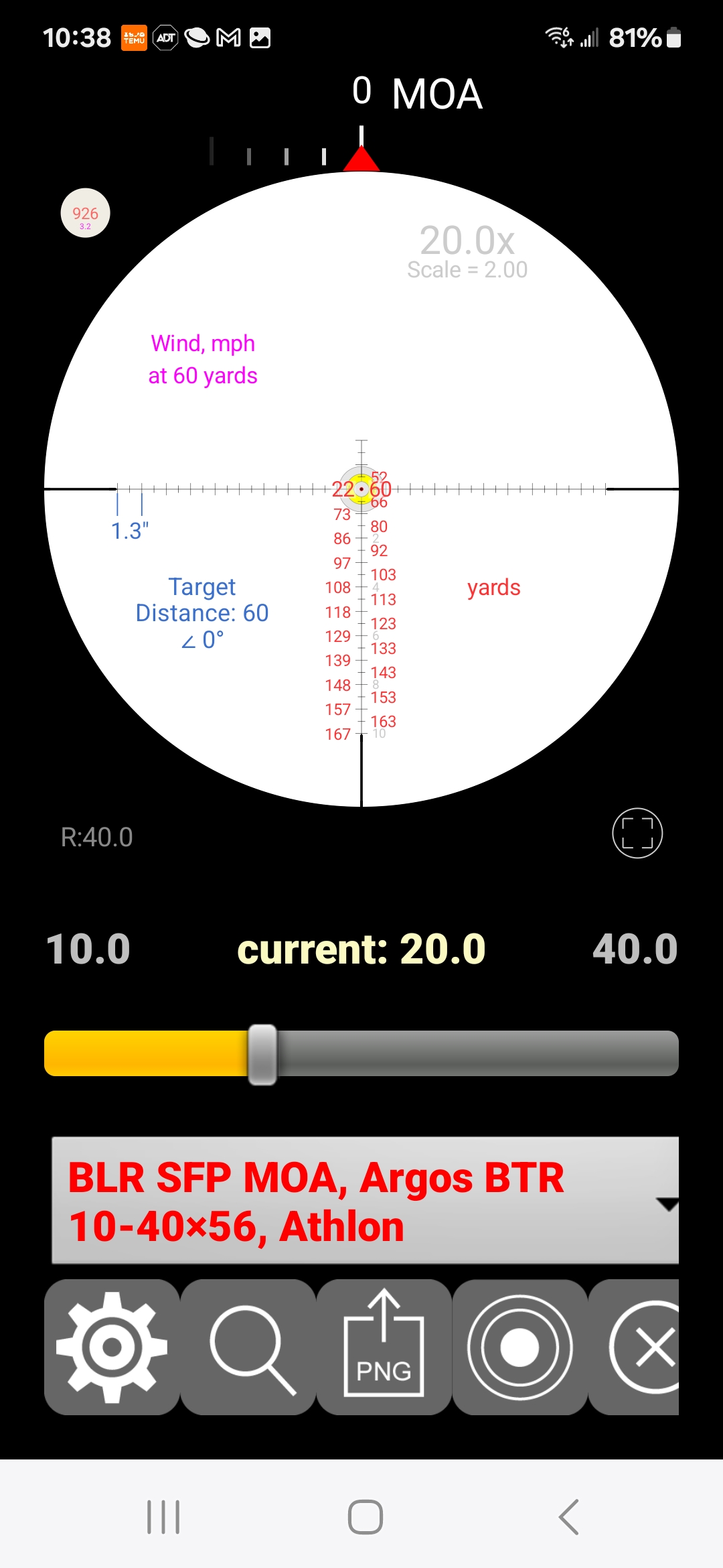

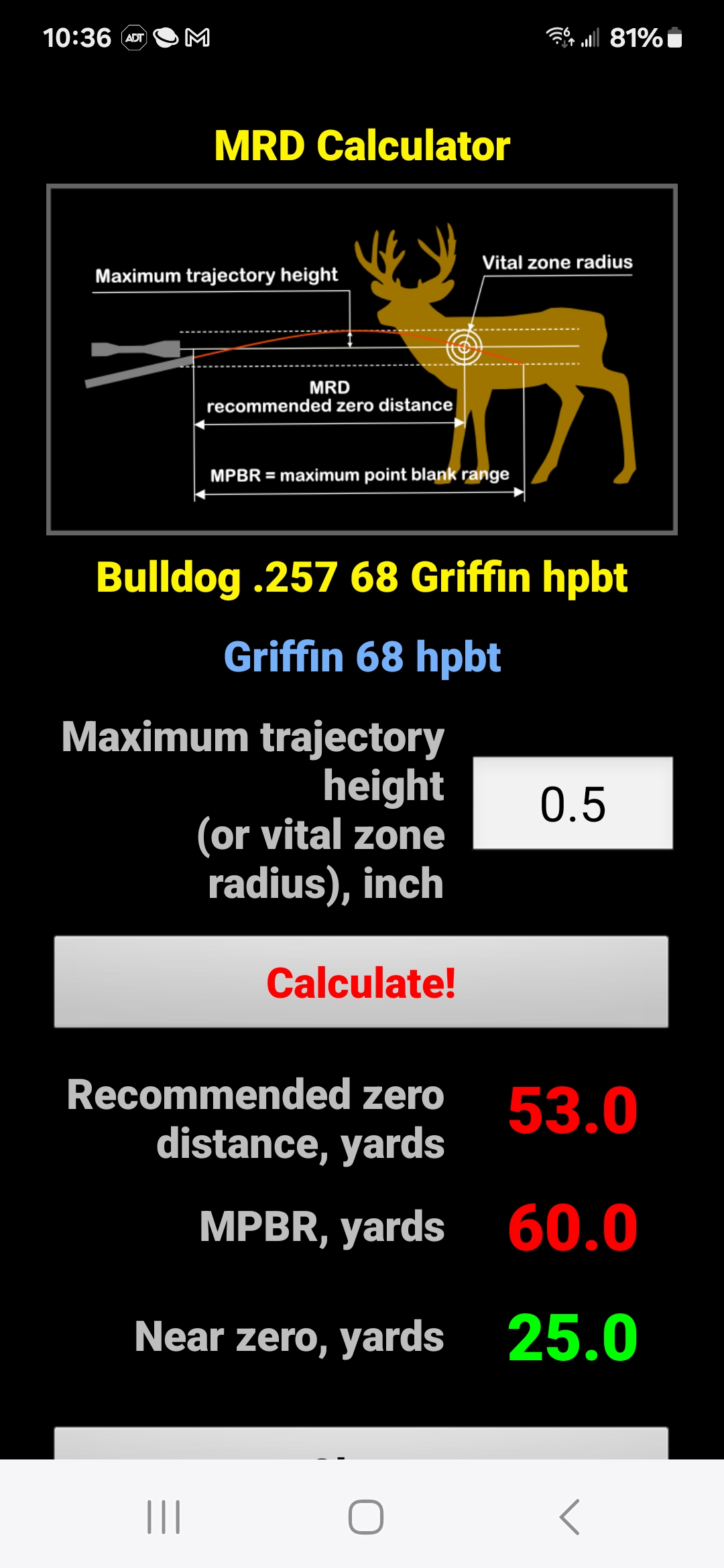

Yeah i got a 66 cubic foot 4500 psi scba tank I'll be getting a 88 cubic foot tank later on and I got the twin piston tuxing compressor and a booster hand pump... the addiction is real!! Here's a video of me this morning shooting my pbba .457 3000 psi with a 350 grain slug
