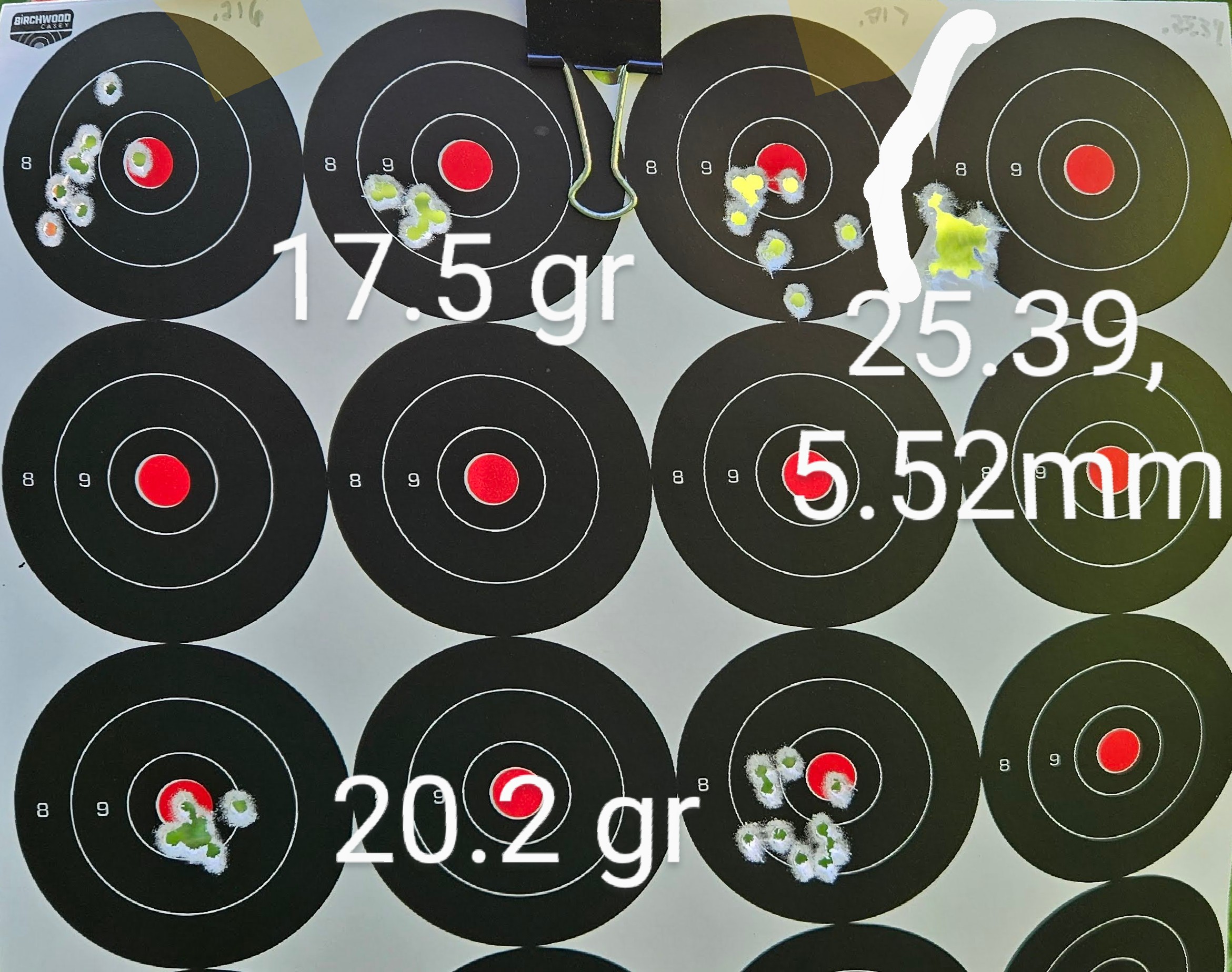

It is all about accuracy. Your barrel is a certain size and if the slug is too big or small it will open up your groups because those need spin to stabilize and be accurate. Most of the time slugs need to go above 900 fps to spin quick enough to stabilize too. Also the barrel twist rate can effect the ability to shoot heavy for caliber slugs. Too slow and those heavy ones just corkscrew out. Or too tight and they deform and do the same. Too loose and they aren't spinning so... also not flying straight.
I have a .22 Avenger so I apologize I cannot help you with exact suggestions but I did find out mine likes 20.2 gr in .216 size going 950 ish fps but for 17.5 gr it needs .2165 and those shot 1018 fps average. More rifling engagement for the lighter weight because they're shorter. That can be applied to your .25 I'm sure.
This was at 30 yards:

No I didn't measure the slugs myself, just ordered from NSA and shot each size and recorded the results on the target. The target was 10 shot groups at 30 yards. Lots say do 5 shot but 10 really shows you what really happens. Plus like for 20.2 .216 I jerked one so having 9 in the "real group" is better than just 4 if I only did a 5 shot group.
Heavy means you need more air to fire it at a good enough speed to stabilize. Also know that since the slug contacts the rifling pretty much the whole length vs a pellet which only touches at the head and skirt, the slugs naturally shoot slower than pellets to begin with. I shoot the 18.13 gr JSB pellet and 17.5 gr .2165 gr NSA slug about the same speed, for reference.
I'm not saying don't try for heaviest slug I'm just saying you'll need more air to get it to go fast enough to stabilize if it is heavy for caliber.
