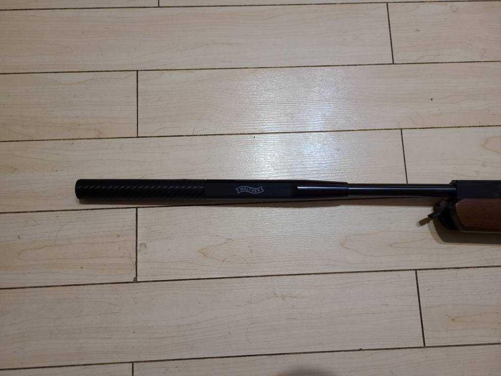

Geo LDC on LGV - one word review
Good.
Here's some details: Walther LGV .177 with a GEO .94" x 6" LDC threaded 1/2-20. Looks good with the existing cocking handle, definitely quieter, no POI shift (one hole groups off of sticks at 10m), about 3 fps loss (864 with Air Arms Fields). Sorry for the crappy photo, but I'm too tired to do a full on photo shoot.
Not sure if he is the GTA guy, I rarely get on there. His site is airgununiverse dot net and the LDC was $26. Looking at the TKO site, yes, that's what it looks like. It's 3d printed and all one piece (no extra filler material inside, no metal). Weighs about nuthin. It's hard to tell from behind the trigger, but it doesn't seem as quiet as the Neil Clague on my ProSport, but I'm just trying to get a little more backyard friendly. For $26, it's a no brainer for me. If I was trying to tame a 30 fpe big bore, I would go with one of the big names and a metal unit. For a 14 fpe springer, it'll get the job done. Received it in 5 days, with a Sunday and Thanksgiving thrown in to hurt my feelings.
Looks sweet from what I can see.
Yep, He's on GTA, I've got one myself. The actuall sound suppression is farrrr better than it should be for the price point. However, the one I have needs a decent surface area on the muzzle to level out. Like on my fx crown, or 28mm shrouded hatsan. Does not sit level on my guns with itty bitty 1/2" adapters. and center bore is very small. I'm sure contributing to it's effectiveness.
But he does make grub screw models and some one-offs, like ones that slip over a daisy 880 front sight blade.
