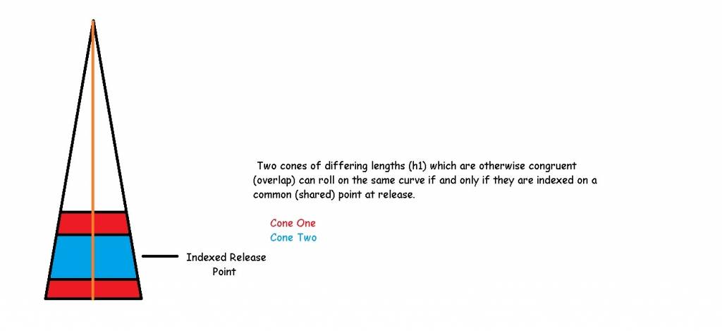

I have a geometric proof which shows (given a perfect rolling method):
  1. Two pellets with differing head diameters can not roll to the same place.
  2. Two pellets with differing skirt diameters can not roll to the same place.
  3. Two pellets with different distances between the bearing surfaces (head and skirt) can not roll to the same place.
    [/LIST=1]
    There is one exception to this proof. That is detailed in the second diagram.
    By all means if you can find an error in this proof I want to know what it is because I am still trying to fully understand the limitations of this method.
    The exception:
    I'll leave further discussion of implementation for later in the thread.

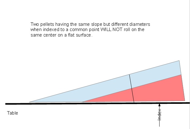

Ok good. Lets first make sure we understand the proof and then we can add in additional problems which would be problems of implementation. Maybe I have the proof wrong. Lets work on that.
Look at the second diagram. If we reduce r2 so that h1 moves away from the pellet and then we reduce r1 to bring h1 back to the same distance the diameter of the pellet reduces. When we place the pellet on the table the intersection of h1 and the table surface has now moved and we are no longer indexed. If you make those dimensional changes the slope must change. If you index to a specific spot on the table every time, the difference in slope will force the pellet to roll to a different place.
If we maintain the same slope but increase or decrease the diameter of the pellet, h1 moves relative to the index.
Here is a better explaination
Does that make sense?

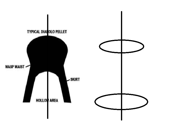

A big factor that you're not accounting for, is the axis of the pellet. Recent posts from nolimits helped me envision this. Any random selection of flying pellets, ie spinning pellets, MUST have their axis points perfectly centered in those two bearing surfaces in order to fly predictably. ("fly predictably" equaling accuracy and precision)
These are exaggerated examples, but anything like below SHOULD be sortable through rolling (I'm picturing clown car wheels with the axle not in the center of the wheel). But you were able to make the case for how difficult it is to get repeatable results with the rolling process. So there are factors at play within the rolling process that make its application harder in practice than on paper (pun towards all your proofs and napkin math intended)

In a perfect world, the "rolling" method SHOULD show any differences between the diameter of the two bearing surfaces of the pellet (greatest circumference of the head and the skirt). The theory being that by "rolling" a person could cull out the pellets that don't fall into the same ratio as the majority of their tin mates, or rather, cull out the edges of the bell curve of head/skirt diameter in a given tin of pellets.
Let's put the RATIO assertion to bed... Rolling WILL differentiate between two pellets whose slope is identical if they are a different diameter.
This also implies that two pellets which DO NOT have the same slope CAN NOT roll around the same point if they are indexed at a common point. This is true because we are not rolling the pellet upon it's axis of rotation. We are rolling it at an angle offset from that axis and that offset is directly dependent upon both radii of the pellet.
By that same logic we can assert that two pellets which are indexed to the same spot CAN NOT roll to the same place unless they have the same slope and the same diameter. They must be identical.
