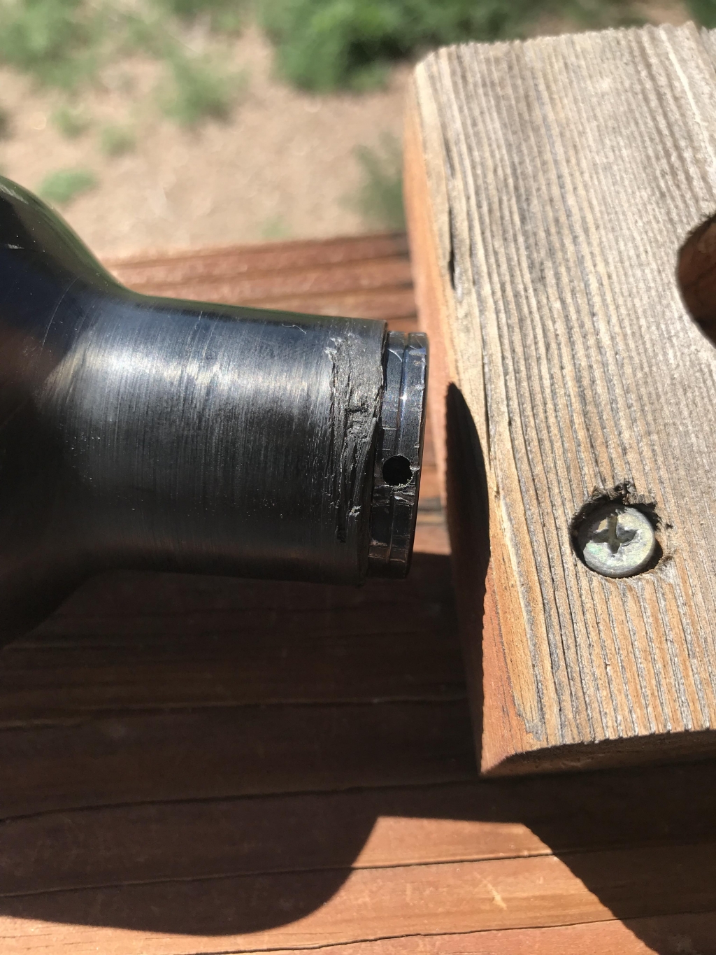

The process took about 1.5hr. I was given my bottles back a little early with the warning that the epoxy was still tacky. No problem. When I saw the tape on my 480, I was surprised at what it looked like and happy that it was not removed.
I showed it to the owner and the expression on his face completely changed from a smile to a painful look like he wished he hadn't seen it. Originally, I thought this showed the amount of expansion during testing but, I realized later that it was more likely due to some kind of clamp and twisting force.
Here comes the bad part.... I called him up later that day and asked why he made that face. He proceeded to tell me that ALL stickers, tape, and other coverings are required to be removed in order for a visual inspection to take place. I reassured him that I would take the tape off and call right away if I saw anything when I got home. I was about to pick the bottle up to perform this inspection when I saw this...
Disappointed? Yes. End of the world? No. But, it did cause me to begin that inspection. Look again at the 1st picture. See it? Left side of the tape about 2-1/4" down. there's 2 little white areas of damage to the outside of the bottle. End of the world? No but, I'm going to have a chat with him and he might owe me a re-rehydro test. I continued my inspection....

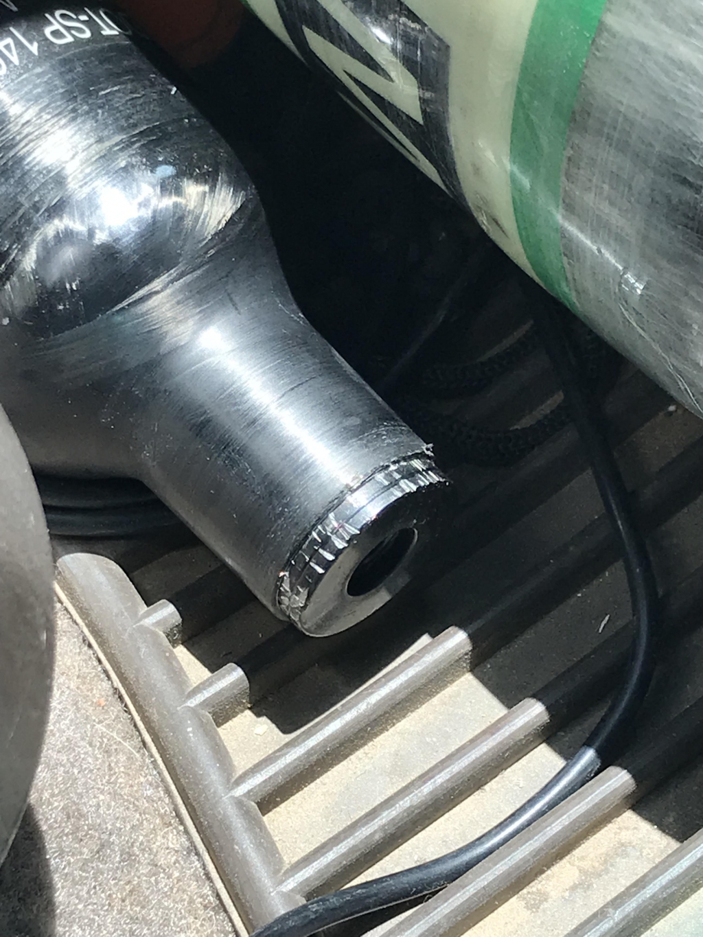

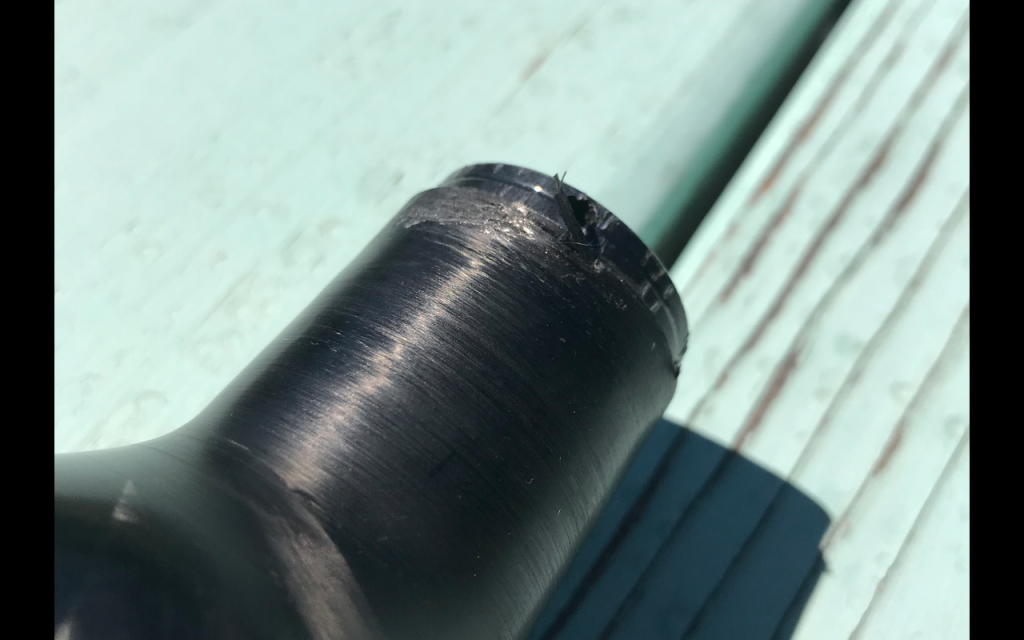

End of the world? YUP! Now, I've got a serious issue. I brought in a pristine bottle and got one back with scratches, plier jaw marks, and gouged fiberglass. I called and was immediately presented with you took possession of the bottle, we're not liable, you can't prove it, you accepted its condition when you left. I replied with my history in airgunning, price and condition of my many rifles, and many other reasons why I knew this bottle was pristine when I brought it in. Back and forth we went. A few times he told me that our conversations were recorded both over the phone and at the shop so, he has proof of me saying I inspected the bottle and it looked good. I said, that's great because what I actually said was that I would inspect the bottle later on. It also means that you have it on tape that you allowed a bottle to pass hydro inspection without a visual inspection taking place.
I offered to bring the bottle down for a re-inspection but, he only said that he would condemn it due to the damage. *Deep breath* I said, Ok. How about this instead. I'll take the bottle to the Dept. of Transportation, who holds your certification, to show it to them so that they know what condition you are allowing bottles to leave your shop in. Furthermore, I can inform them of your recordings that you just threatened to use against me in which you acknowledge that you did not do a visual inspection due to the tape being left on the bottle.
The story is longer and goes on with back and forth arguing. One question I did enjoy answering was, Do you have proof that it wasn't like that when you brought it in? Sure, I do! I'm a you-tuber and just did a video with this rifle in it. Is it time stamped? Yup, sure is! Would you like photo's or videos or both? There's also a splinter of carbon fiber hanging off the bottle right now that would have fallen off over the course of 4 years.
