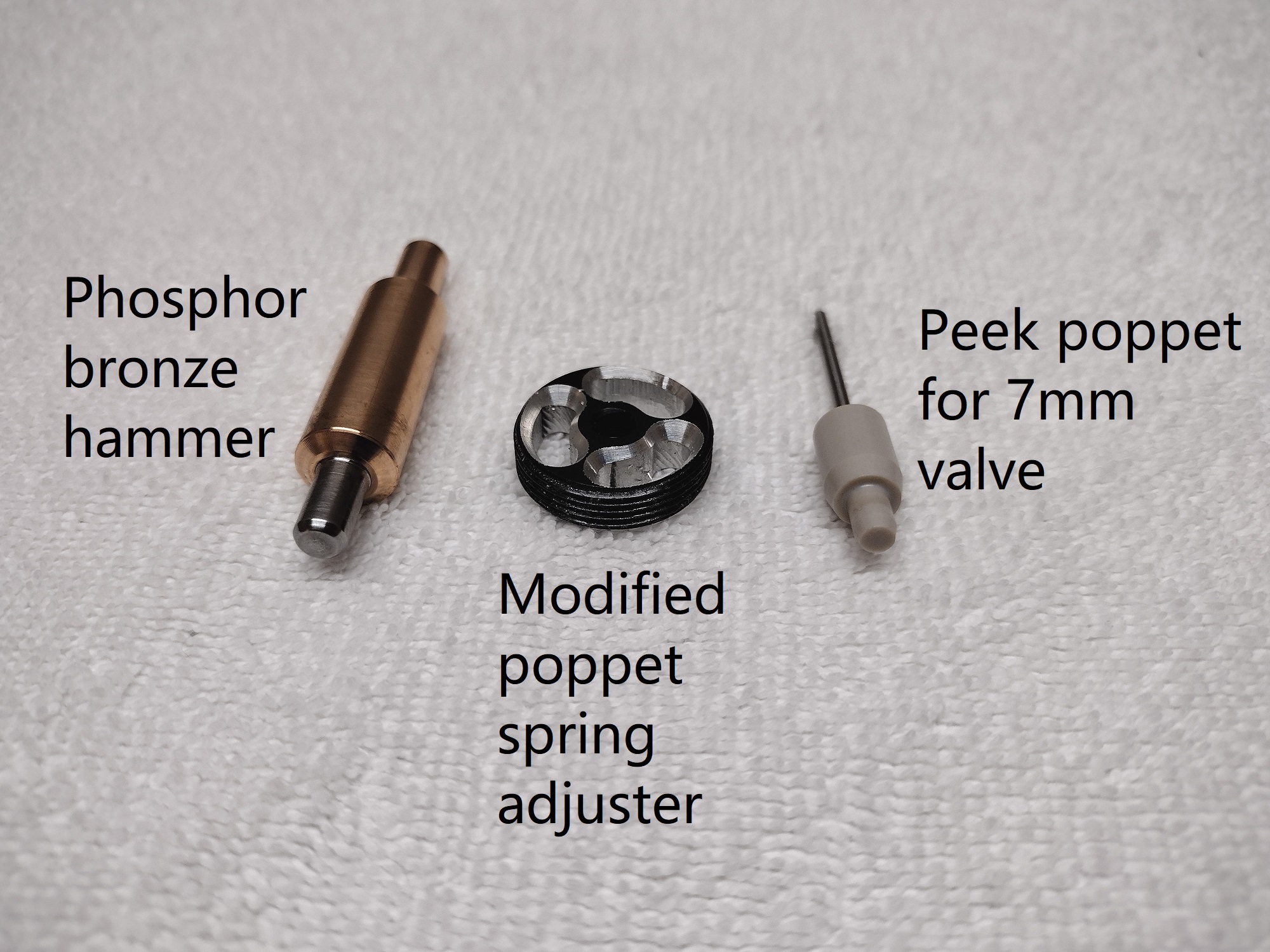

My .306 Vulcan 3 came with a 37mm hammer spring that is 9.97mm wide and made from 1.3mm wire.
The valve stem diameter is 2mm and the poppet is Delrin
You can back off the valve spring adjuster which is just above the poppet (center part in pic) I modified mine by milling the 6 holes into three.

The "thing" that hold the valve return spring in place, i dont have anything that can loosen that, i have tried needle nosed pliers and that did not work.

I like your MOD on that part (y)

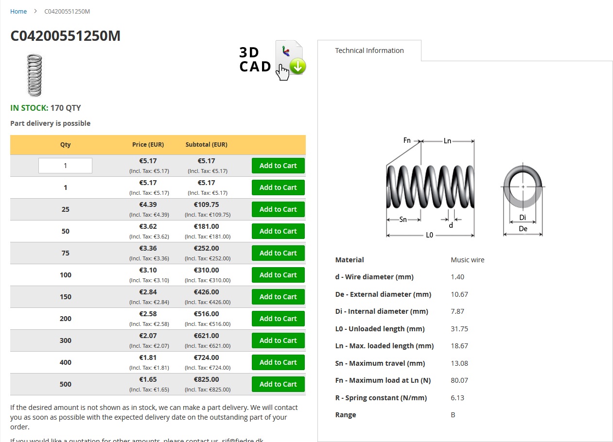

I dont know what the compression force are on the original 1.3 mm spring.
BUT ! i have just ordered two 1.3 mm springs and two 1.4 mm springs, one stainless and one piano wire in each size.
If thats not enough i can see i can go to 1.5 and 1.6 mm too, though then their listed compression force look to be A LOT more than what it feel i need to exsert of force to cock the gun with the original spring.
Then some experimenting, and if the kettle still dont fly, well i will have to take a look at that valve return spring too.

Just got back with new springs, and have done a little chrono work in the living room, the heaviest spring at full load, almost make the V3 rifle super sonic with the 13 grain KO slugs, where as the original spring at the same REG pressure and MAX hammer top out at 940 FPS, so a good +100 FPS with the new spring.
The #2 hardest spring too outperform the original spring but not as bad.
The new springs have more windings than the original spring, if say the original spring have 10 windings, the new springs have 13 - 14 windings,,,,, but they are still able to be fully compressed,,,,, but only barely, TBH i think i can back off a little and still do well. ( i have only tested the 3 springs today with MAX hammer )
I wanted to test with the hammer adjuster flush with the back of the rifle, but then the hammer can not open the valve, not even with the strongest new spring.

Spec on the heavy spring i got today.
