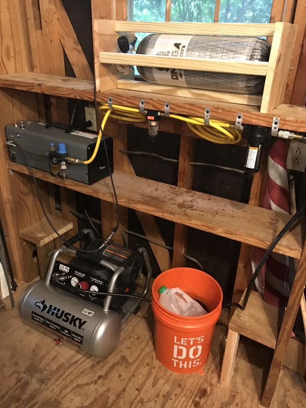

Still needs some work, but it's getting there for sure. I got my Omega 75 up to 4K Lbs. Giving it a rest to cool down a bit.
"Imold"Doesn't seem to bad 7 min from 42-44 that's good pressure coming from a booster,would of taken 7 hours with a hand pump hahaha that's if you could pump it at all at that pressure, did you notice how warm it got?.
The compressor tank got pretty dang hot, meaning the air coming out was pretty hot as well. The black hose is about 12 feet or so, I stuffed it into the HD 5 gallon bucket, filled with water and threw in a gallon of ice. That did the trick just fine. My SCBA was cool as a cucumber all the while.
Wonder how or if one of those 12volt coolers would work,drill a couple holes in the side close to the top and run the hose in and out, add water and then get a little 110v to 12v inverter, turn the temp down and plug it in and it should keep the water nice and cool, we have a coke cooler that can be plugged into a power outlet in the truck that we used to use for camping and it kept the food and pop Nice and cool all weekend long..Something to look into..
Might be a Budweiser cooler it's been awhile since I've used it, upgraded to a 34ft camper heeheehee.
