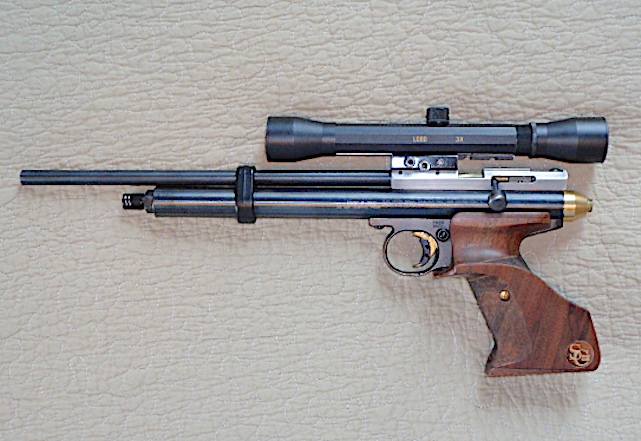

The PowerMax Hipac gizmo is the easiest safe way to convert a 2240 to high-pressure air, but I believe you'd have to locate one in the used/collector market. The PowerMax HiPAC easily converts Crosman Co2 guns to high-pressure air by replacing the Co2 tube-cap, though hammer-spring replacements help fine tune performance with this device (as detailed below). This pistol averages .65 - .75” groups at 25 yards on Co2 or air.
.22 Crosman 2300 Co2 single-shot, 12” barrel
14.3gr JSB Express, 94F., 39 shot power-band= 465/494/29/6/485/7.5
With Boss valve, stronger hammer-spring and (home-made) power adjuster maxed out, it got:
14.3gr JSB Express, 100F., 20 shot power-band= 509/529/20/5/524
14.3gr JSB Express, 82F., 25 shot power-band= 524/546/22/6/538
As above, with PowerMax HiPAC HPA device installed and even heavier hammer-spring:
14.3gr JSB Express, 1500 PSI HiPac, 9 shot p-band 541 563 22 6 557/9.9
After resealing with assorted valve parts to correct a leak:
14.3gr JSB Express, 1600 PSI HiPac, 9 shot power-band= 572/594/22/5/581/10.7
14.3gr JSB Exp., 1600 PSI HiPac, 10 shot p-band= 570/601/31/7/587
Converting to a regulated-output HPA bottle is much more involved and makes a much larger 'pistol', but one capable of unimaginable performance (similar to this 1960s-vintage Crosman 187 pistol conversion that has captured many State and National Champion field-target titles)-
