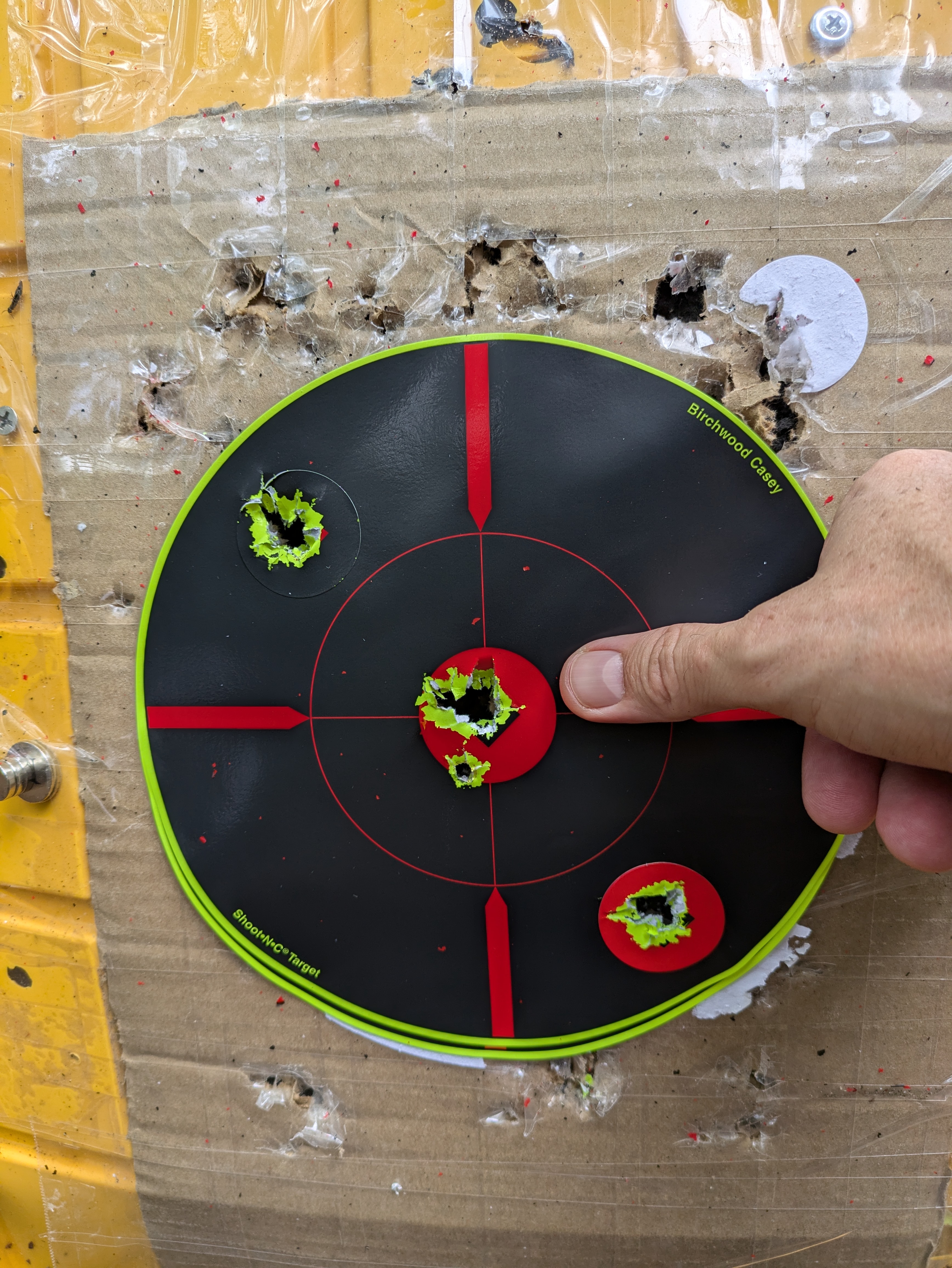

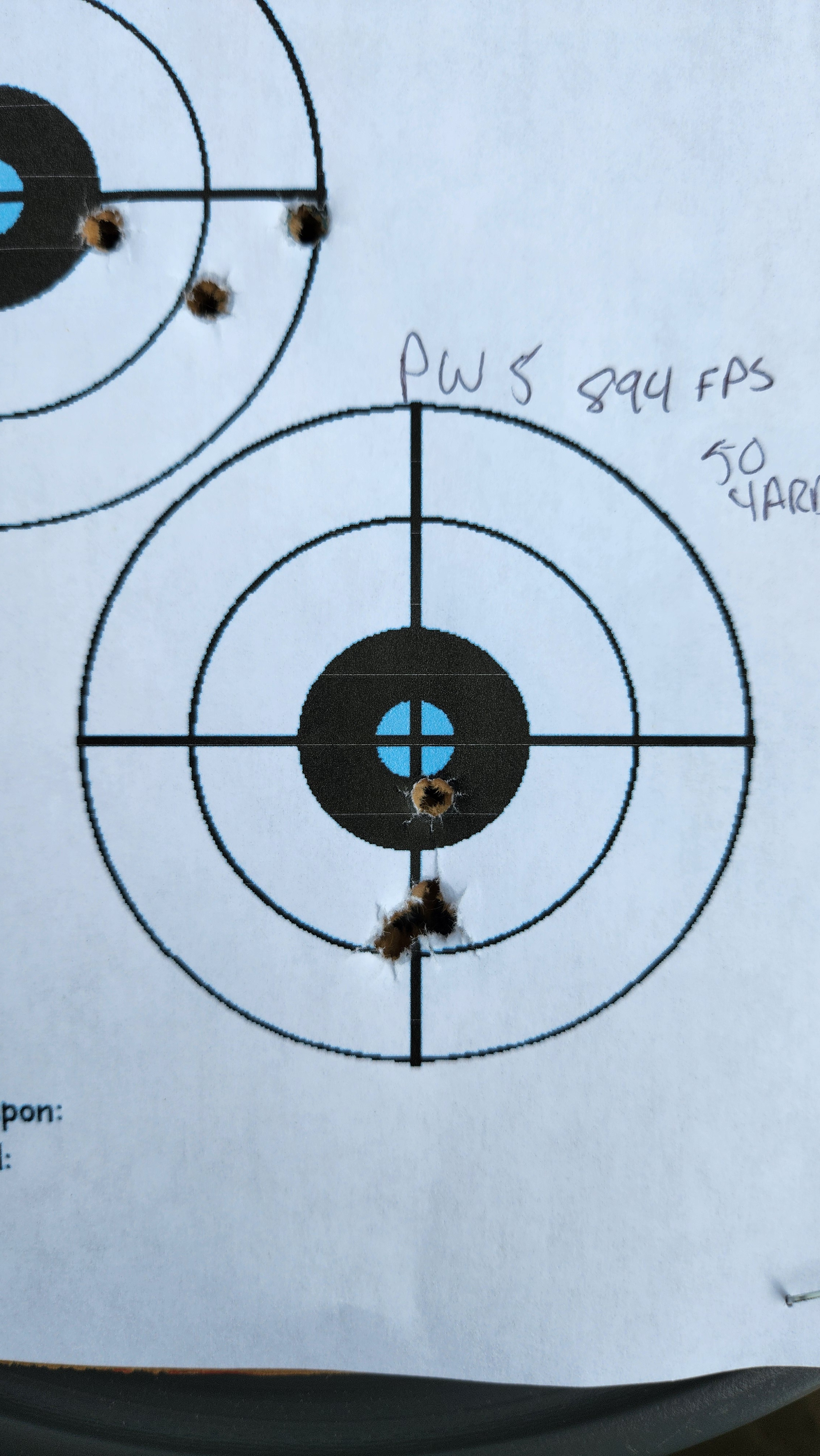

I haven't had much opportunity to test my .25cal Ghost so far, but this is my best 5 shot result at 50 yards with 33gr JSBs. About 145-150 bar (red spring from the kit). Power Wheel at 5.
Reactions: cavedweller
great start to the .25..... i'm assuming you have a 23" barrel on it?

23” HP .30,
Factory hammer spring
power wheel on 9,
Regulator at 150 bar
shooting JSB 44.75’s @880 fps
The trigger still eats my lunch. I'm working on adjustments and have had some improvement by moving it aft and down, adding some 1st stage play and reducing 2nd stage breakout force using @Franklink's suggestions and the BRK manual.
(Thanks for all of your work Mr Frank!)
The flyer in the pic was from the 1st shot of the day; a cold shot @820fps. The other 23 pellets behaved nicely.
23” HP .30,
power wheel on 9,
The flyer in the pic was from the 1st shot of the day a cold shot 820fps. The other 23 pellets behaved nicely.
Awesome - thanks for the info and the pic!
