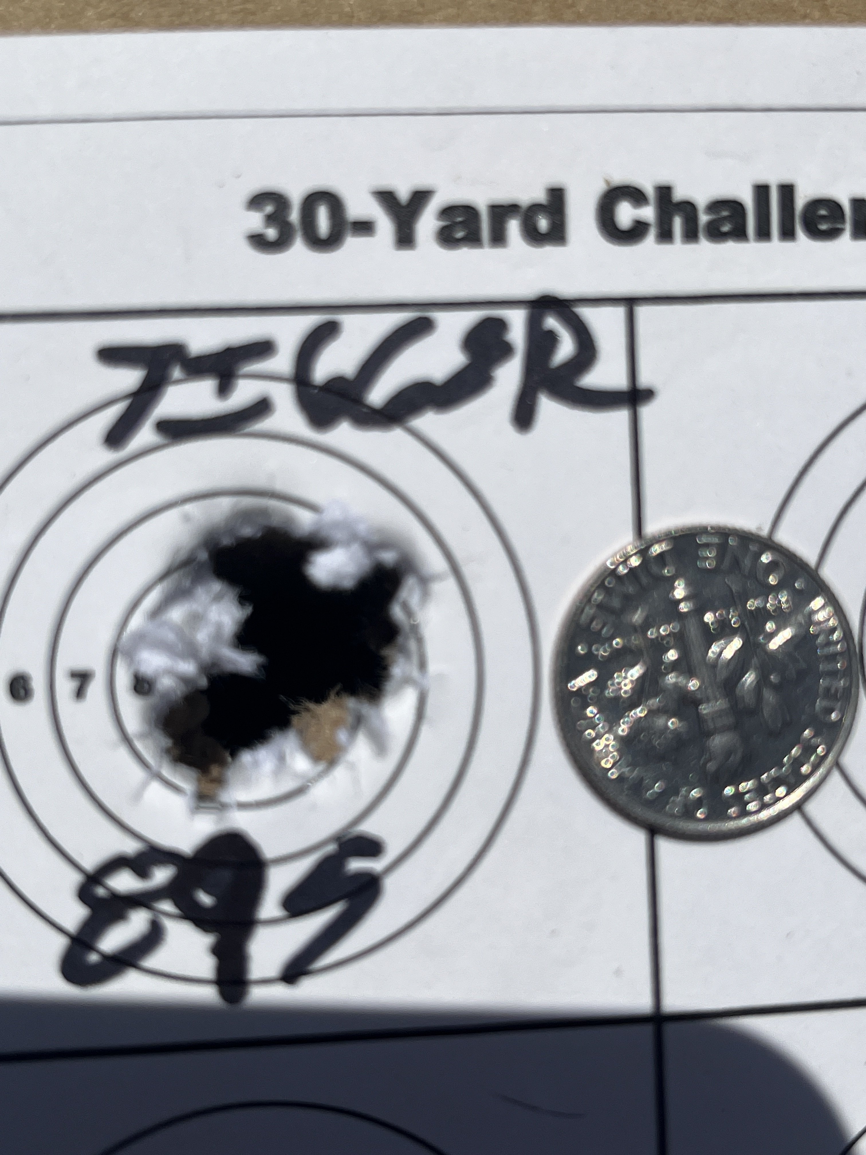

My results for a .22 HP 23" Barrel "Multitune" for 3 different pellet weights was similar to AimSmall on you tube.
.22 Barrel @ 23” Multi-Pellet Weight(s) optimum balance tune w/o spring or reg change.
White Spring, Regulator set to 115 Bar.
This is a great one barrel multi pellet weight tune and maximizes air usage.
NOTE: older springs/newer springs may vary FPS results.
NOTE: I found I need 3-5 shots to settle the gun / reg down when changing power wheel setting – remember to only adjust power wheel with breech closed.
I only adjust the Power wheel as below using the pellet weights as listed.
Min PWR 15 Gr at 895
Med PWR 18 Gr at 880
Max PWR 25 Gr at 870
let me know how your .22 behaves with this setup. I installed a new spring.
