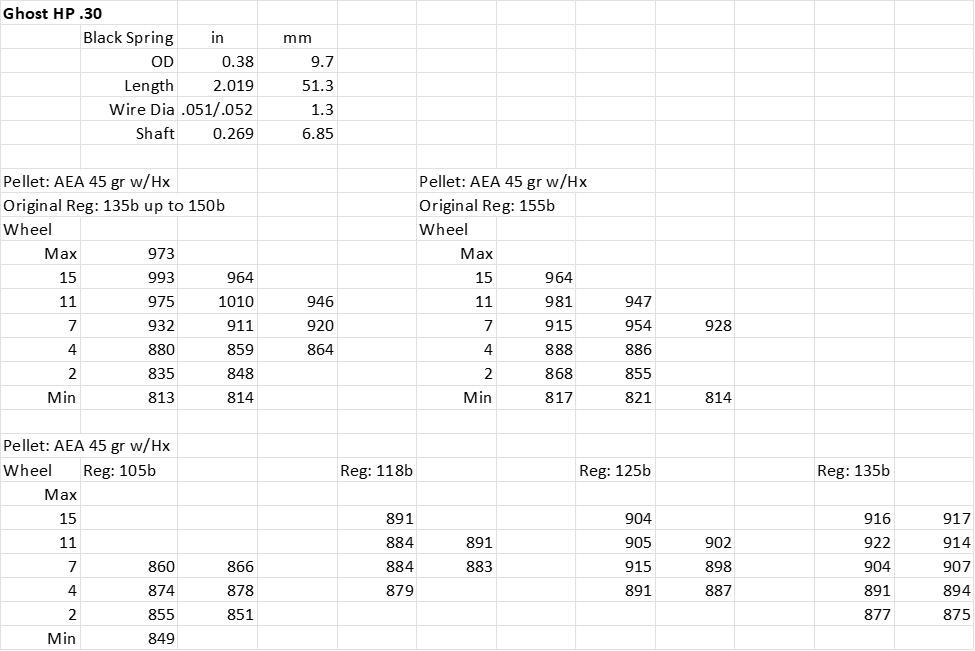

@Shortcut - fantastic information
I though I would add my Ghost strings as well. My new .30 came set at 135 bar, but after the regulator broke in a bit went to 155 bar. I had to reset it down, so I tried a number of regulator settings along the way. Note all pellets has HBx on them to season the barrel. I also noted that the barrel needed a deep clean due to some brown antifouling coating.
Dan
Note 23" barrel
Also note I switched to an electronic Edgun gauge after the first run. It's a shame a $2K gun doesn't come with decent gauges.
Reactions: cavedweller

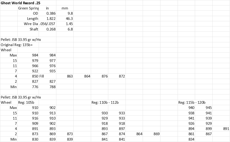

So, I liked the 30 cal Ghost so well, when a World Record version came up for sale tuned by Derrick, I jumped on it. I had a similar problem with the reg moving up as it settled in, originally it was set for 110 bar, but went to 135 bar after a few shots. So I took advantage and ran a few over the chrony as well.
BTW - I have a .22 28" barrel (1:28 twist) inbound from AOA shortly.
Dan
Note 28" barrel

Thanks Dan
excellent work - so good in fact how would you feel about doing a chart like this for all the data we’ve gathered so far?

weird - i could see the numbers on my phone app but on my MAC they are there but black on black so mostly invisible.
