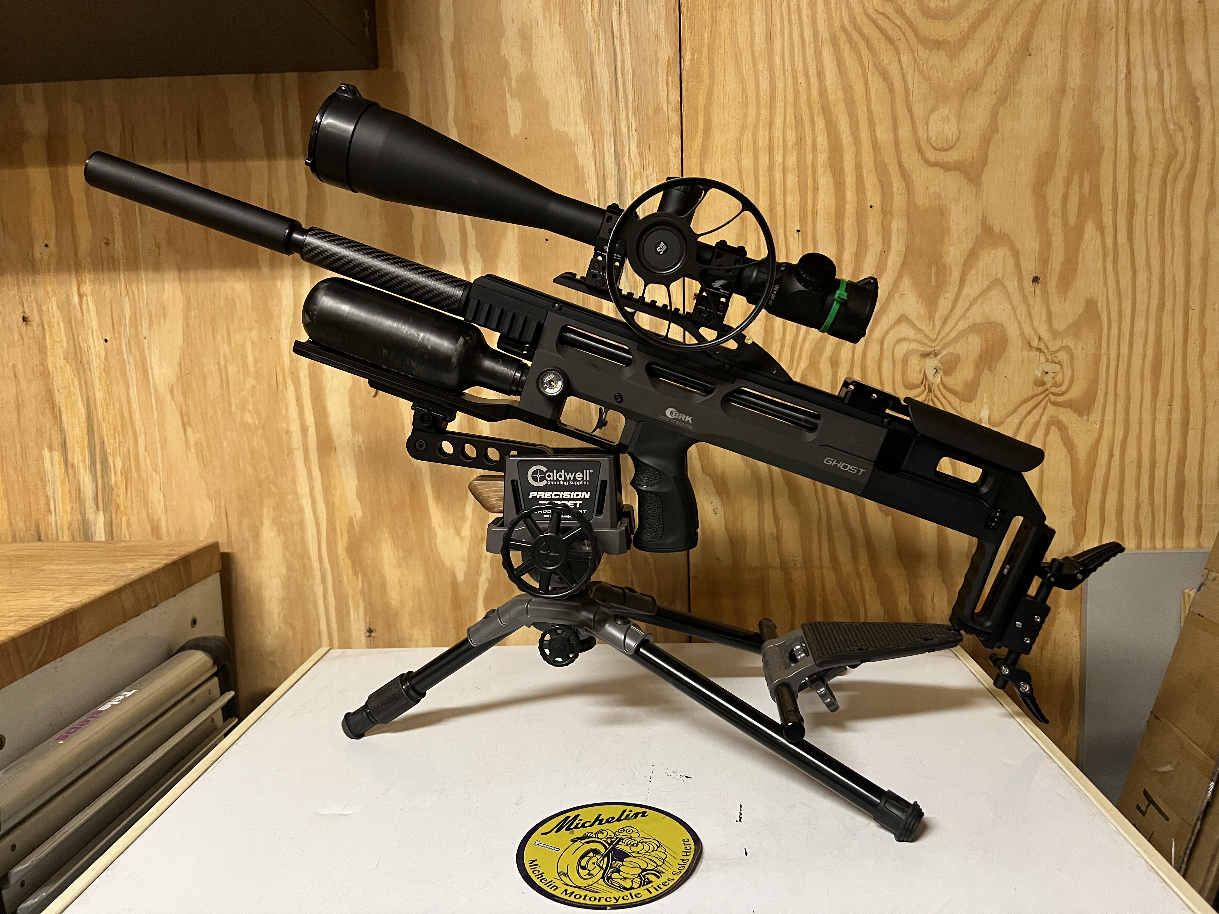

Brocock/BRK Ghost - “if i just had 2 more inches…”
of shroud that is 😬

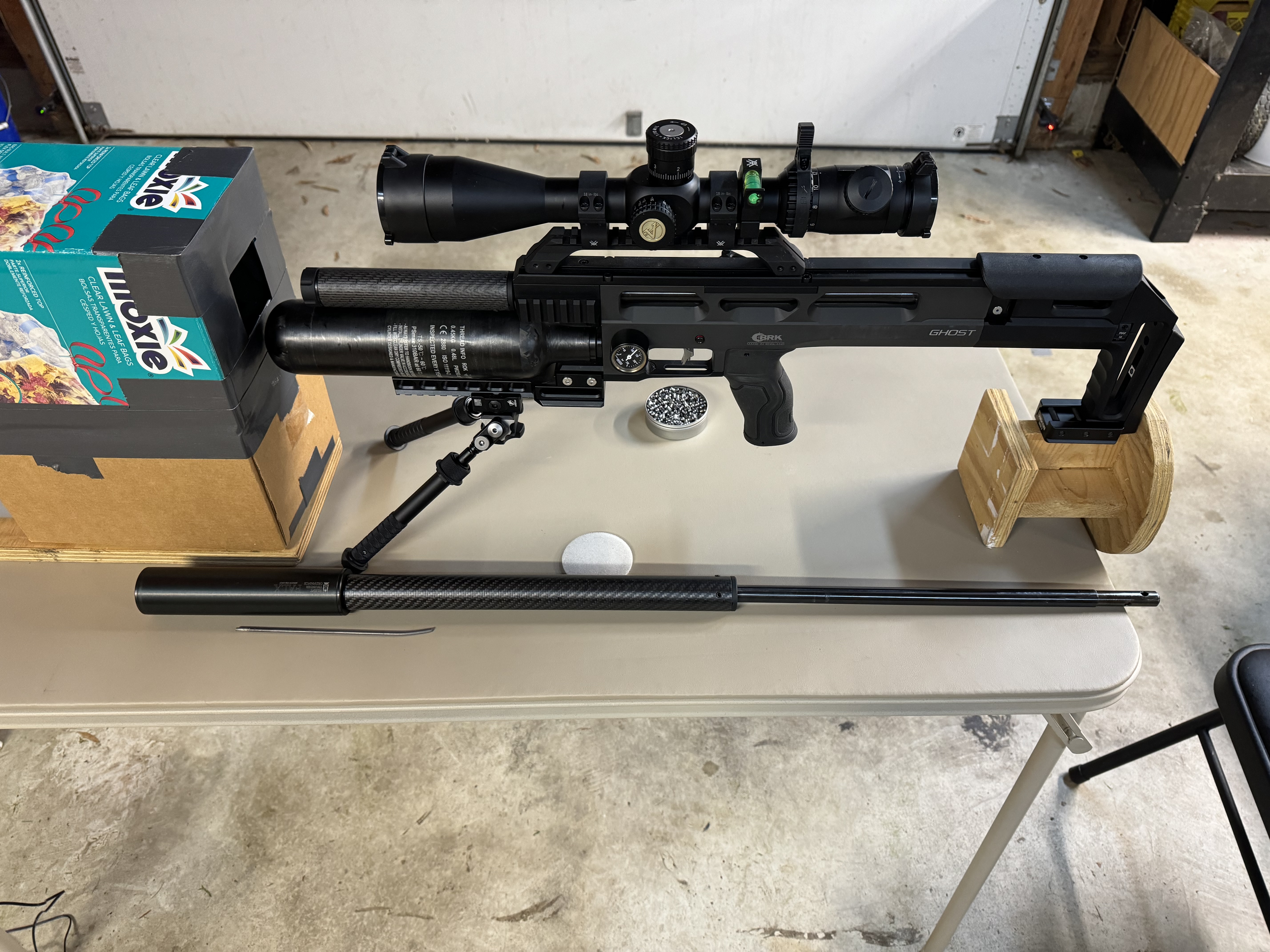

Put new .177 carbine barrel on my .22HP ghost but find it is too loud for my liking. Unfortunately, my .22 Falx diameter is too big to clear 480cc bottle, so I’ve considered:
1 - buy smaller 300cc bottle (less shots 🥺)
2 - see if I can get a ghost plus shroud to replace shorter carbine shroud (do they exist?)
3 - put the longer .22 hp shroud on and see if it quiets down enough (kinda defeats purpose of the short carbine barrel)
4 - open to other ideas…
What would AGN do?

Oh and that is an interesting setup you have as a bag rider. Looks solid and won’t move while you are testing/shooting on that bench
@Triggs75 - leaning that way now. I think a moderator in 1.22 diameter will fit (perhaps a Hugget Snipe or Huma Mod30). That was just a random block of wood to get the barrel lined up for some quick chrono work

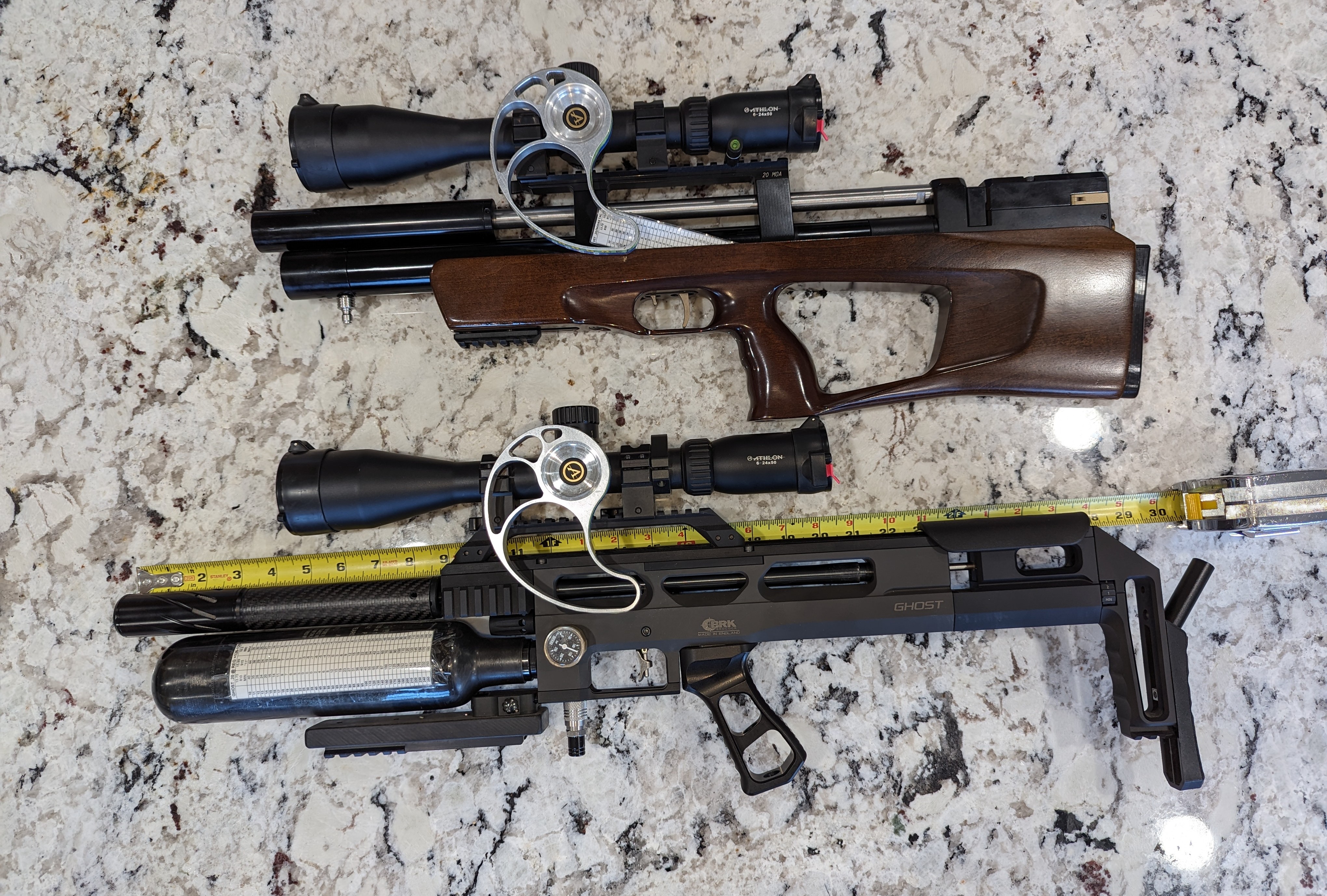

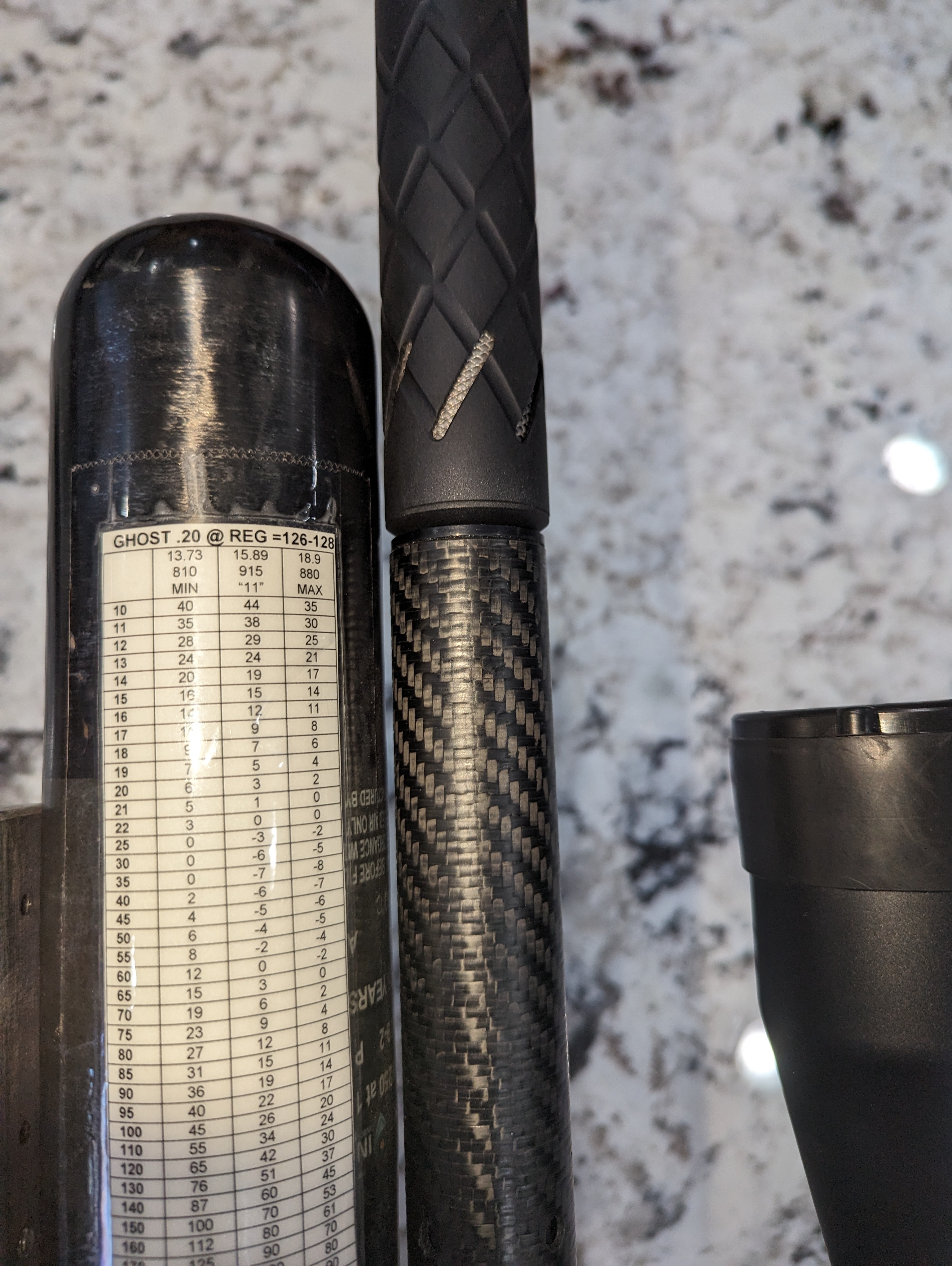

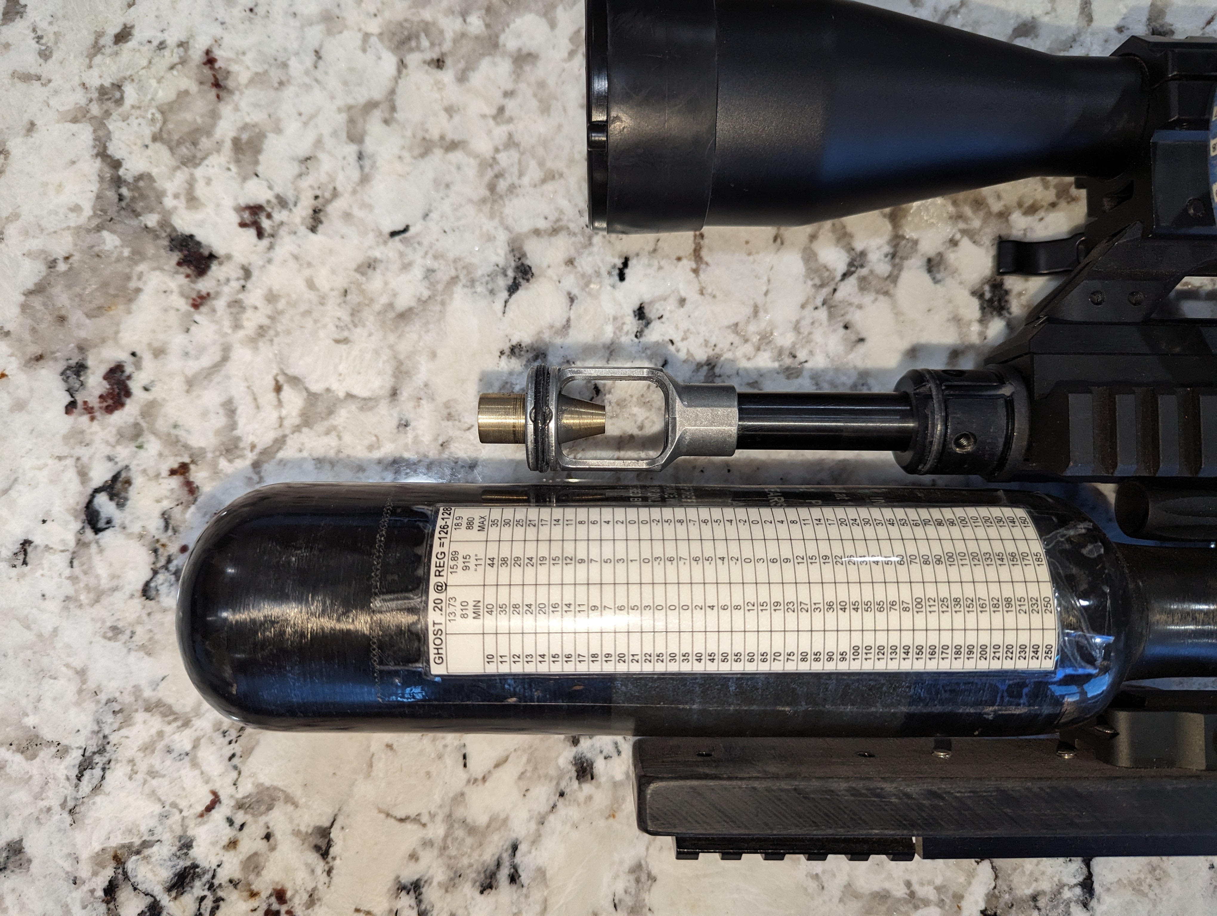

Here's some mock ups. 480 cc barrel, Carbine barrel/shroud. Both the 0db and the Huggett Atom have plenty of clearance with the bottle (shroud and both moderator are essentially the same diameter.).
Clearance

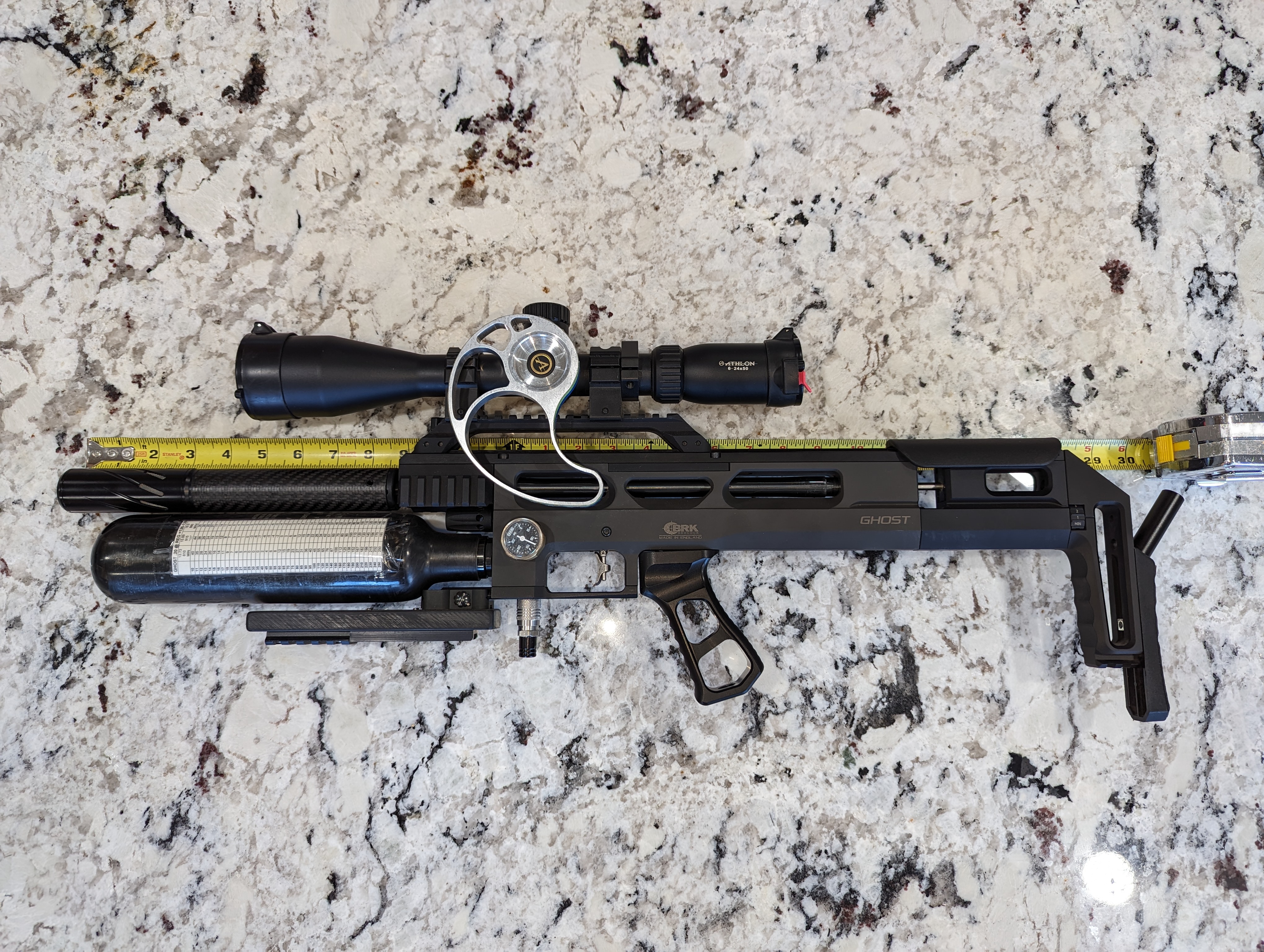

How it looks with the Huggett ATOM.
Its 29.5inches overall in the above phot but would be 29" without the aftermarket extended air stripper. It's about an inch longer with the ODB, (110 I think is the model).

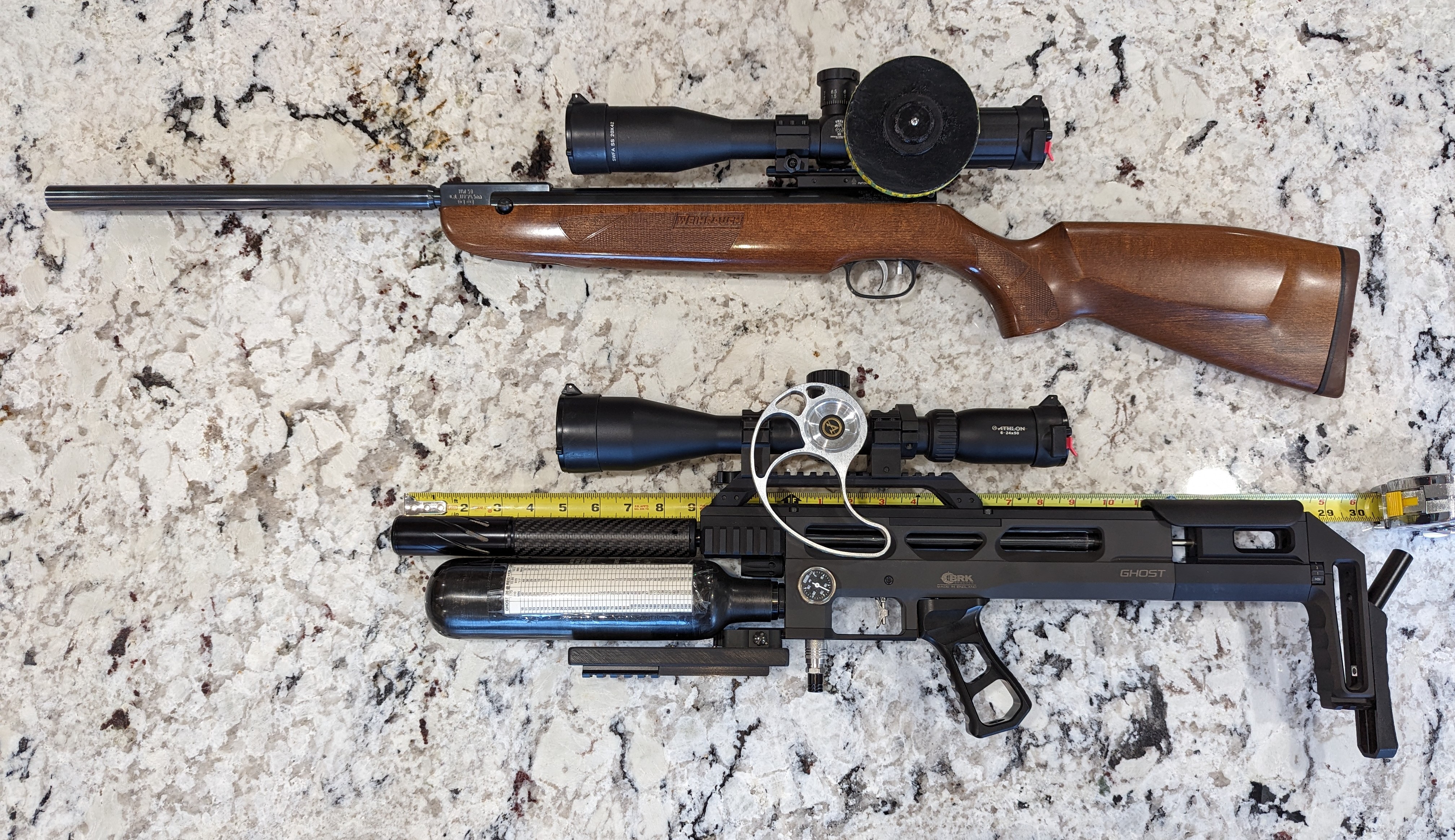

Reference next to a (mostly) Veteran Short
Reference next to a HW50s, typical sporter length of 40.5"
Hopefully that gives you an idea.
Clearance
Thanks a lot for the pics @Franklink - measurements indicated 1.22” would clear but nothing helps like seeing one mocked up.
