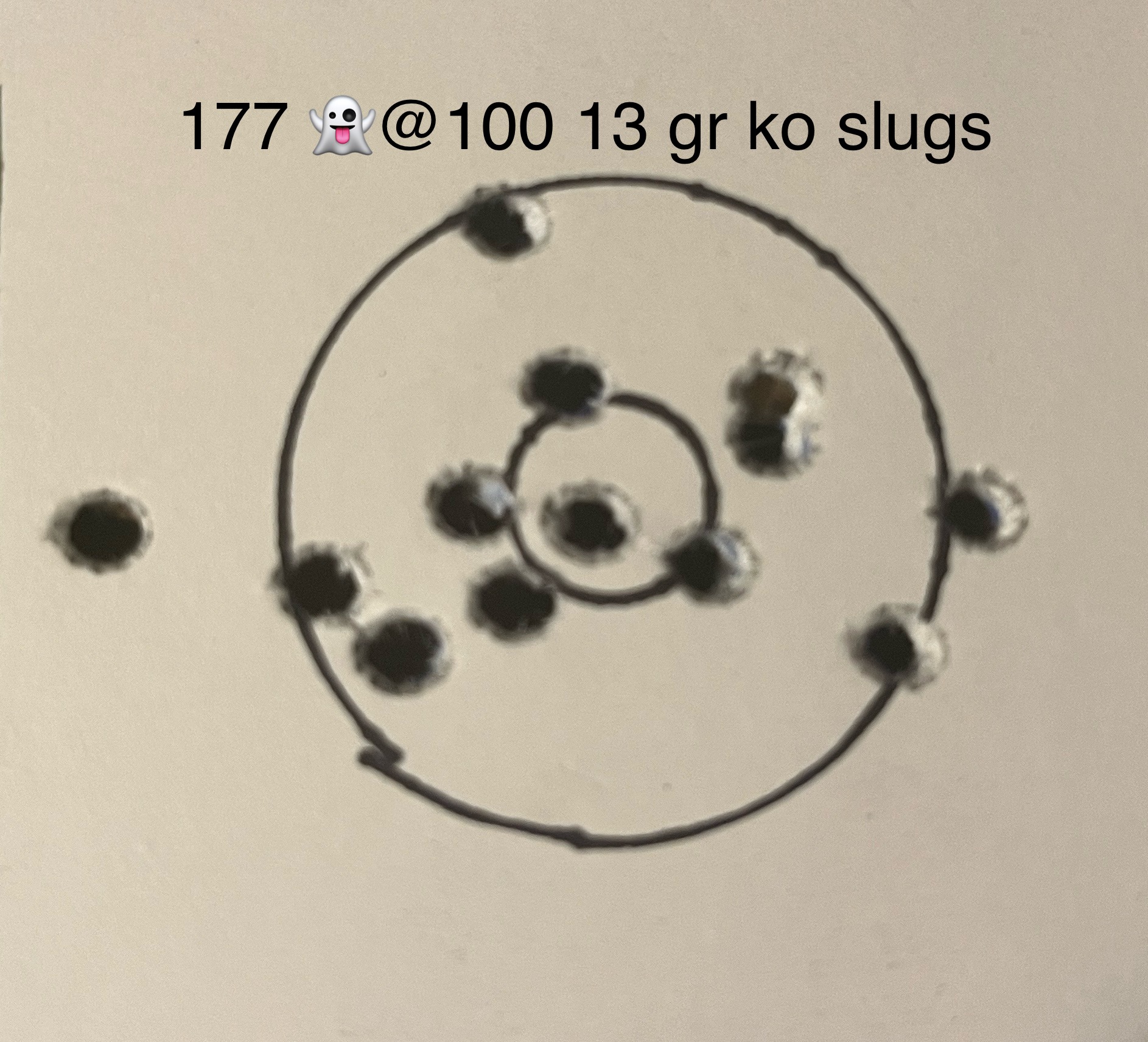

Look up SorenDrost in the search function. He has been shooting slugs in a ghost 177 for awhile now.....He is also testing ouut a new slug barrel, but before that it was the "standard" barrel.

Have no experience with the uragan but the ghost with 28” barrel shoots 13 gr great!
